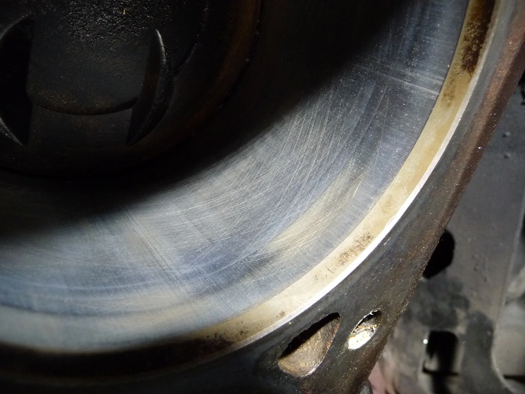

This engine has 70k miles on it and the only issue is the deck on one side is not flat enough to reliably hold pressure under boost. Nothing else wrong with it that I'm aware of. When I get it torn down, I'll take some close up pictures of critical surfaces and post them. I bet it has minimal wear. Even before tear down you can still see the factory hone marks. The ridge at the top is barely noticeable when I sweep my finger across it.
