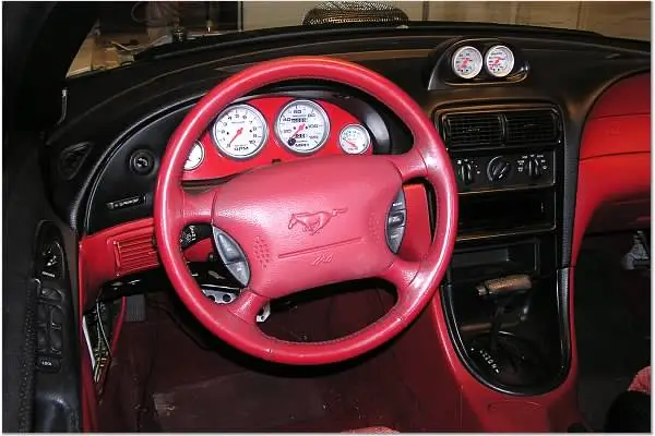

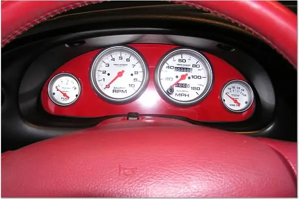

If there is interest in a write up I will certainly do one.
The cluster is not from Florida 5.0. Basically I took the original cluster, removed all of the lights and gauges from the back, cut out the back of the white gauge housing, laid out and cut new holes for the gauges in the face plastic, did the same for the new aluminum face, removed the clear plastic cover and trimmed the bezel to fit.
After that it was a matter of fitting and wiring the gauges and lights. No problem.... Right!!!!!!!!
The whole process took about 10 hours after I figured out what I wanted.
Here's a tip for those who want to do this. Get an electric speedo. The mechanical version has a cable input that extends deep into the dash. On the convertible there is a structural cross member that gets in the way. I cut a hole through the cross member large enough to pass the cable through and everything mounted perfectly.
To answer another question... I am running an AOD (not AODE) I removed the computer and so went all the warning lights. The only light I replaced is a low oil pressure light which comes on at pressures below 20 lbs.
