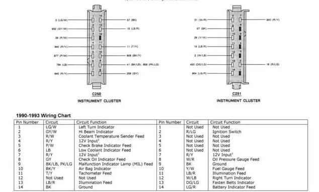

Here's the wiring for a 90-93 cluster. There's an illumination feed and ground on each side.
