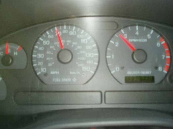

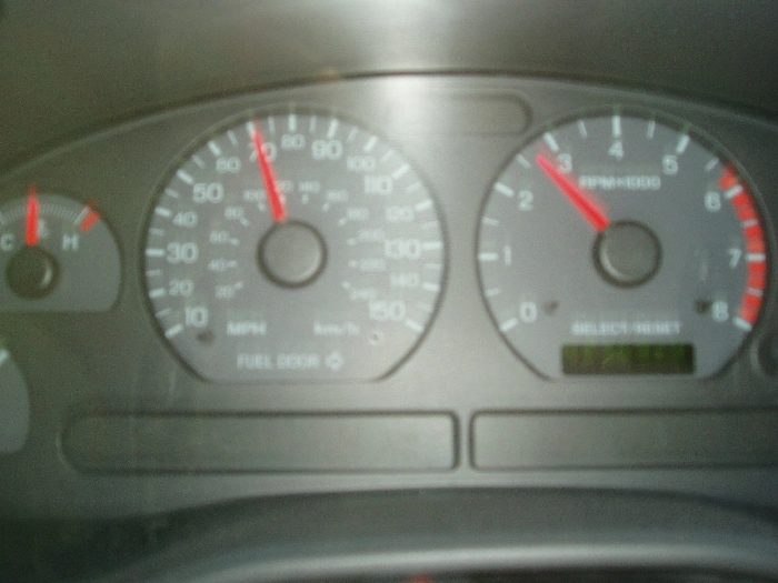

4.10' cruising in OD. I've had 4.10's in my DD now for over 2 years. I wouldn't change a thing.
