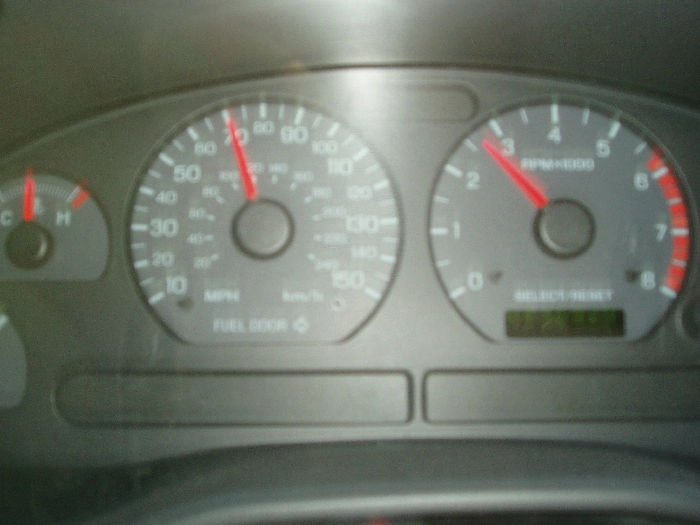

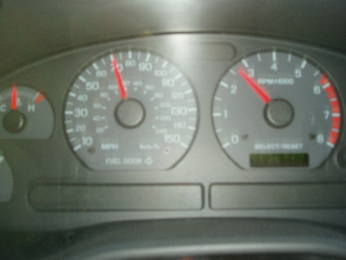

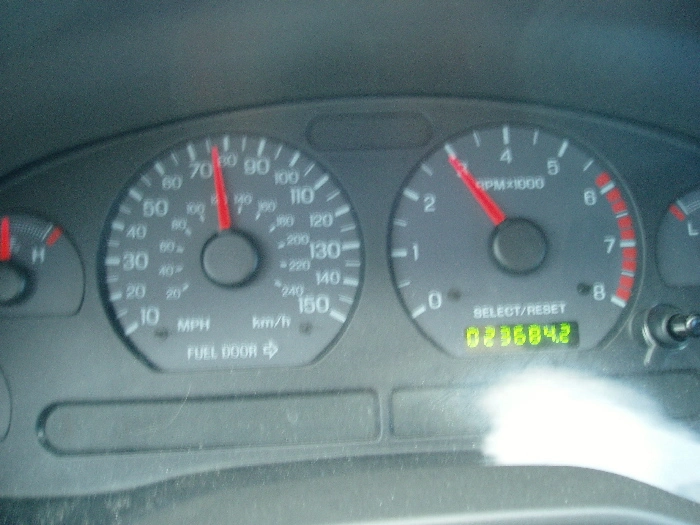

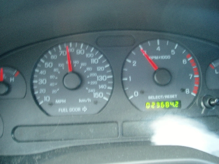

4.10's Auto in OD. Stock tire size. 4.10's are perfect in an auto!
