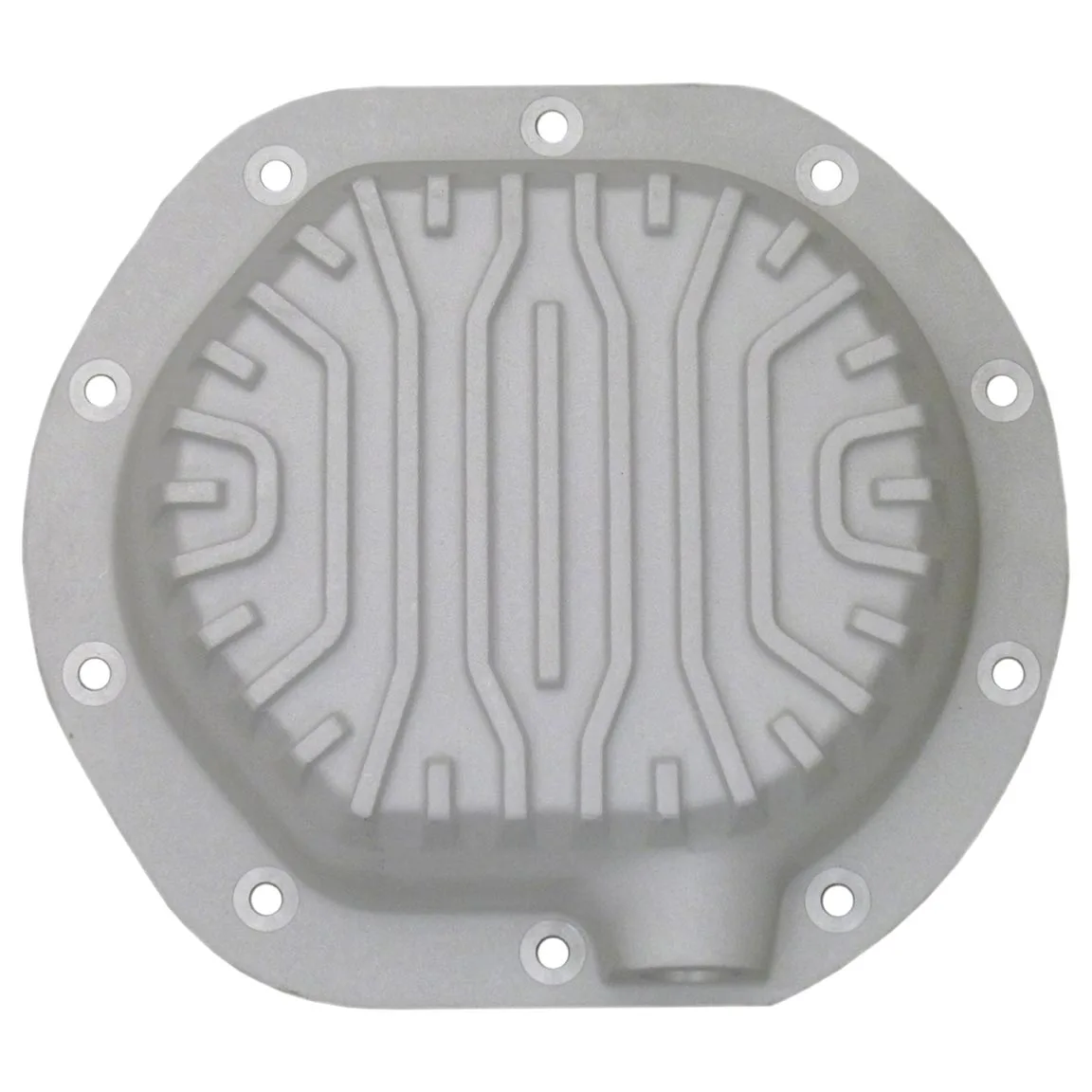

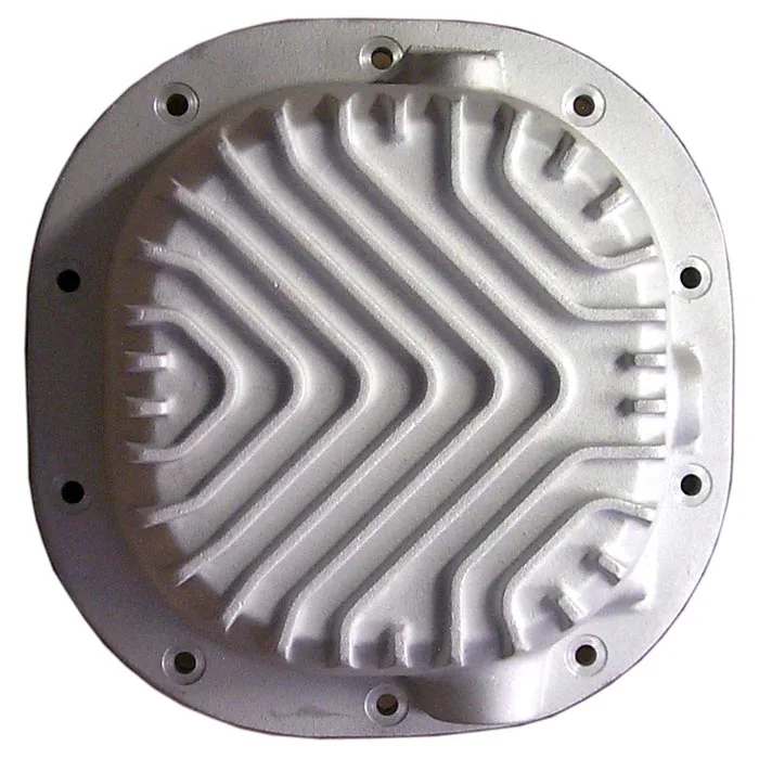

Disregard the weird castings, look at the bolt pattern on these.
7.5
8.8
Don't know what brand these are but you get the idea.
Just a quick google search
