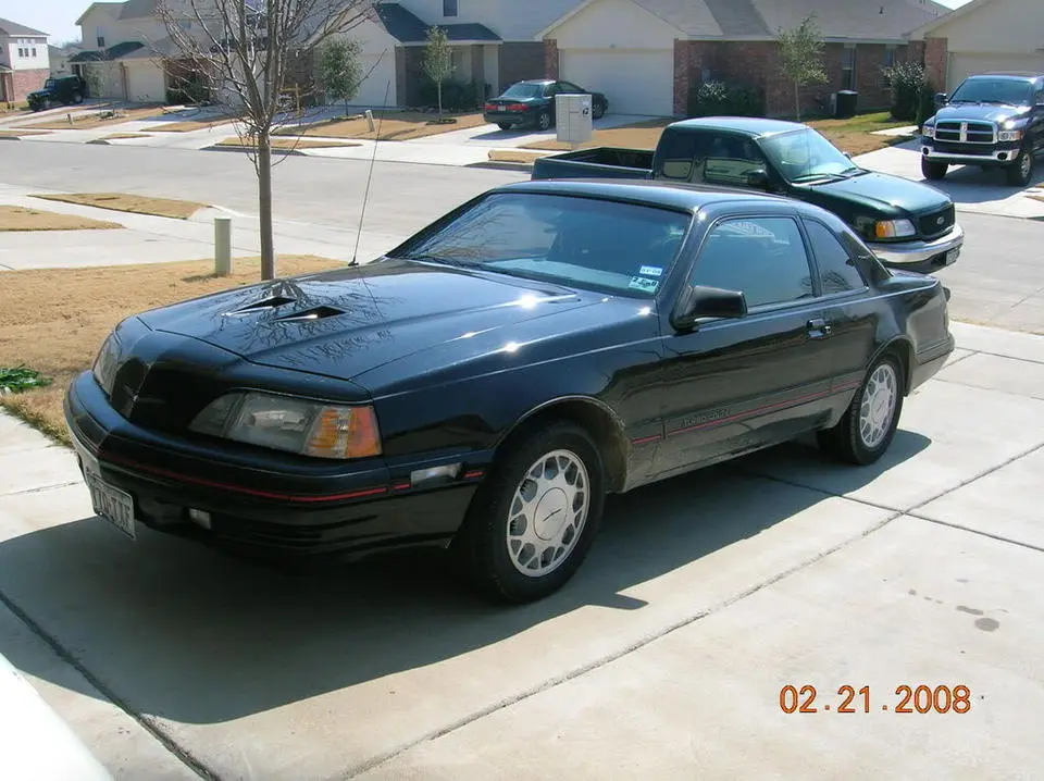

for 3k you can buy this one and have everything you need.
