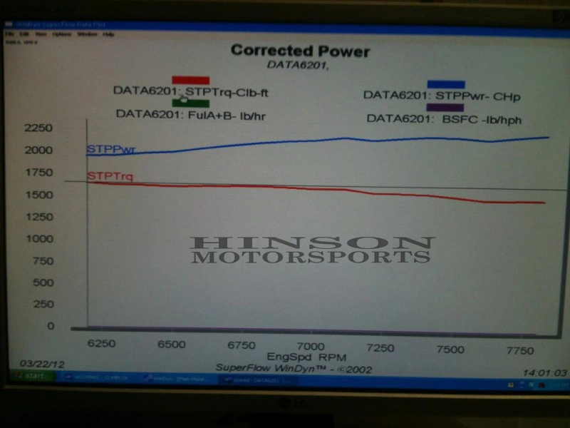

3/23/2012
New numbers are in!
2,246 HP @ 7,800 RPM
34 psi

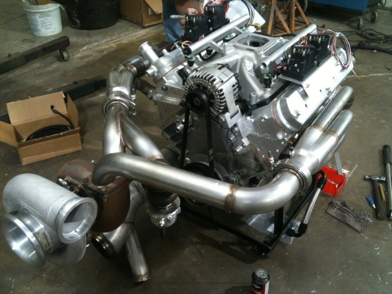

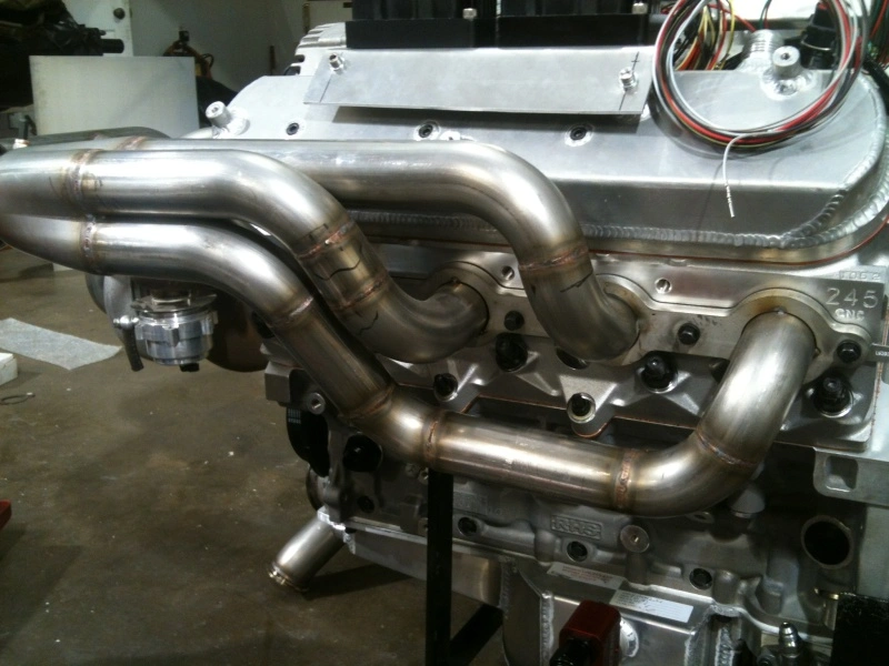

This is a custom tall deck 427ci solid roller engine built in partnership with Butler Performance. The guys at Butler Performance handle our big cubic engine builds. These RHS blocks are great when they're in capable hands of a great machine shop. Give us a call to help plan your next race engine build.
Getting ready for the engine dyno.

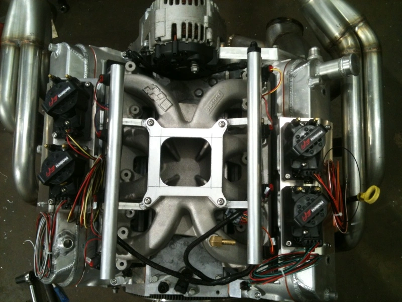

RHS intake spacers for the tall deck build.

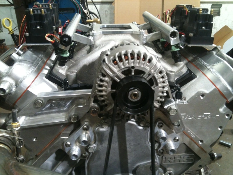

Forced air enters here. Intake is a GM piece with custom fuel rail solution by HINSON Motorsports. An intake elbow plate has been bolted down to the top. We will custom fabricate the elbow to work on this engine.
A billet alternator bracket built by Lane here at the shop. Got amps?

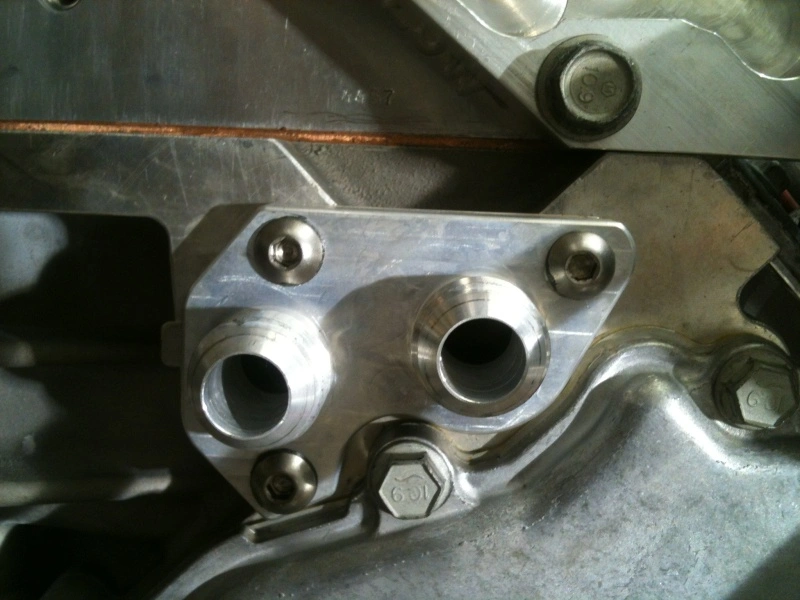

Custom water plates for -12 AN cooling connections. Built in house at Hinson Motorsports.

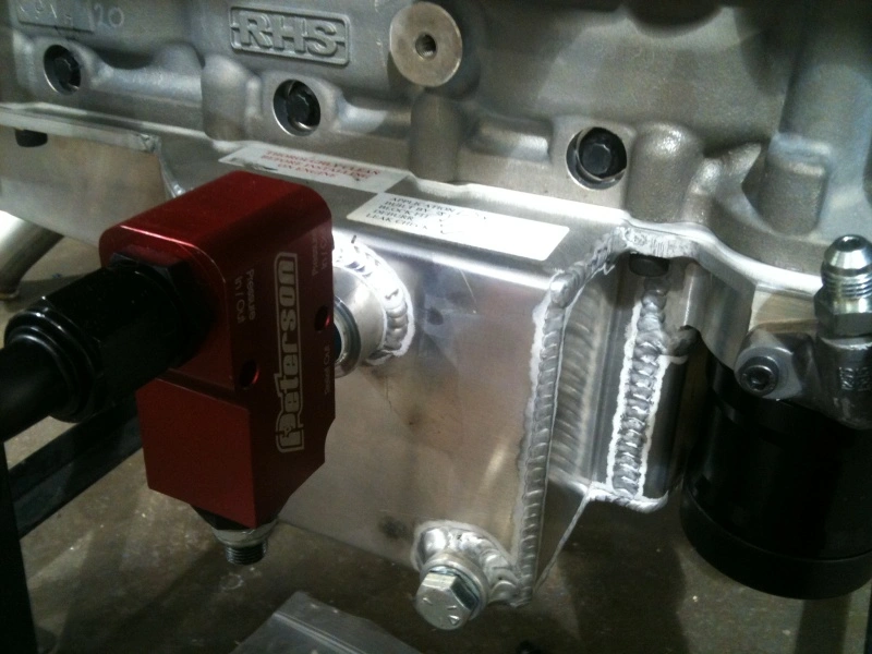

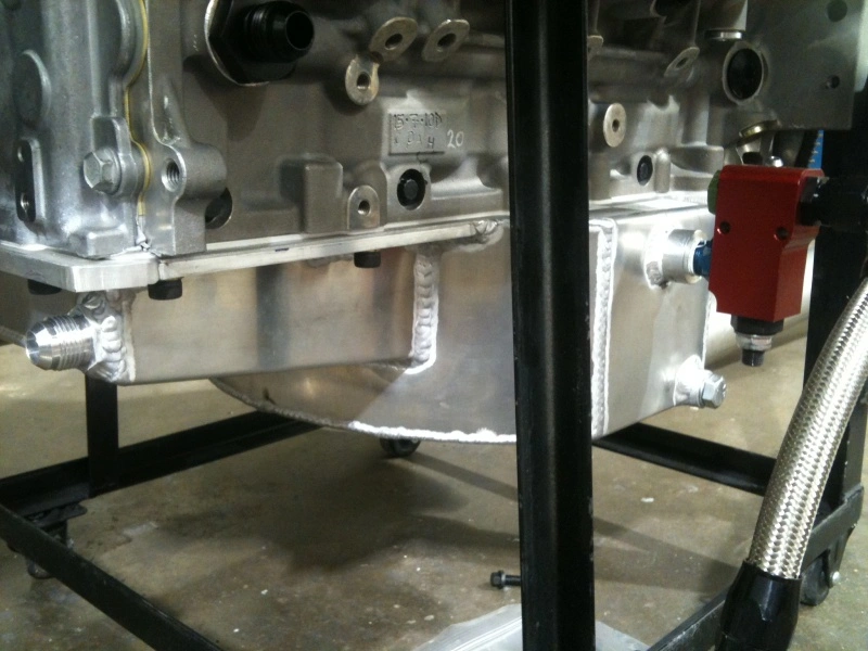

Custom high capacity oil pan with trap doors for fluid control.
Custom external oil pressure regulator on race oil pan.

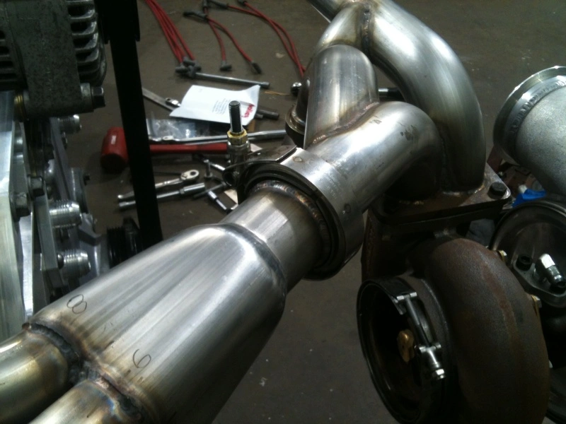

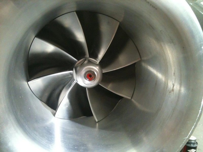

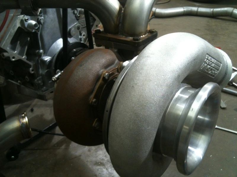

118mm Turbo - It's bigger than you think.
Don't get sucked in

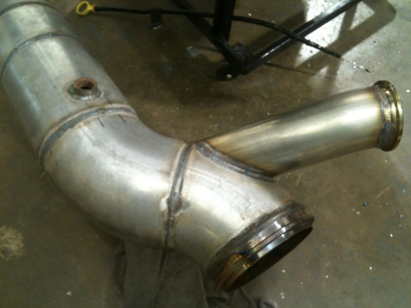

5" Downpipe.

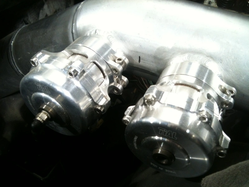

Lots of boost = Twin BOV.

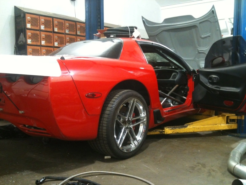

Funny car cage for driver protection. Still under progress when picture was taken.
This is an all business interior featuring a 25.5 cage for protection.

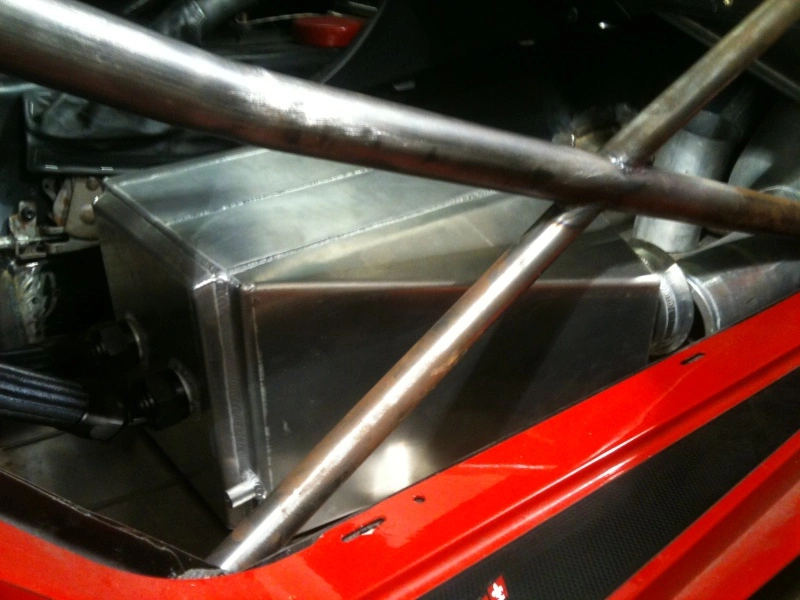

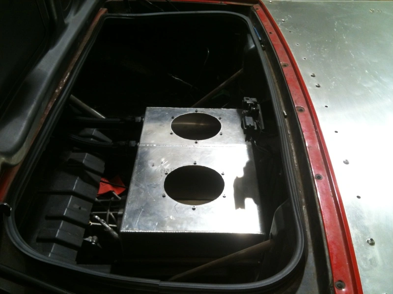

Intercooler and engine water tanks in the trunk. All fabricated in house.

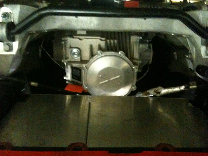

Running a TR6060 and ZR1 differential with Quaiffe LSD. Thanks to RPM Transmissions for their support on the initial build in 2011.

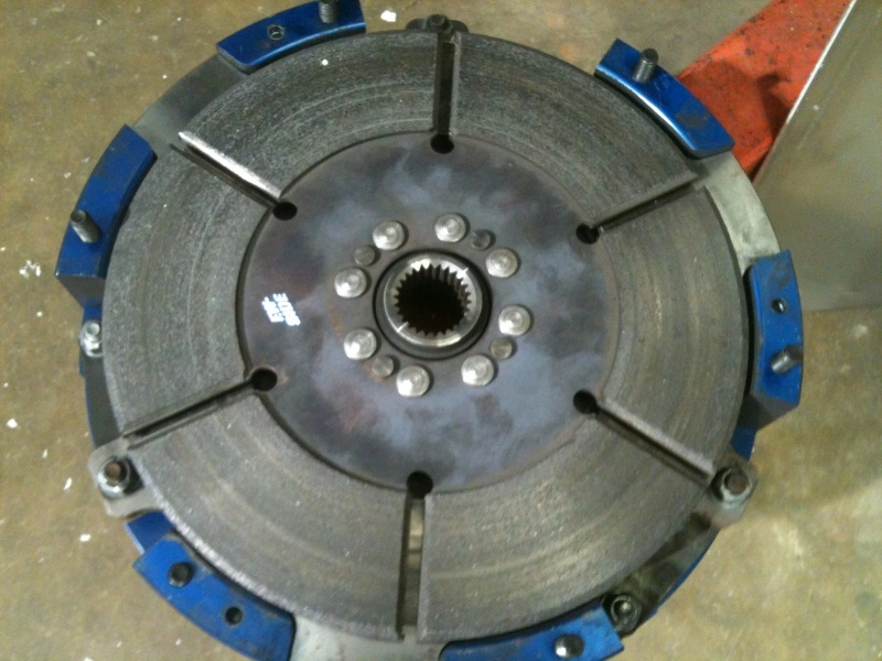

SPEC Twin disk from last year's C6 race car. Thank you SPEC for the continued support in 2012.

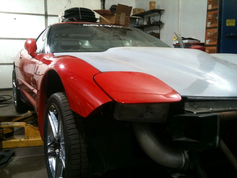

High rise hood to clear the intake elbow.

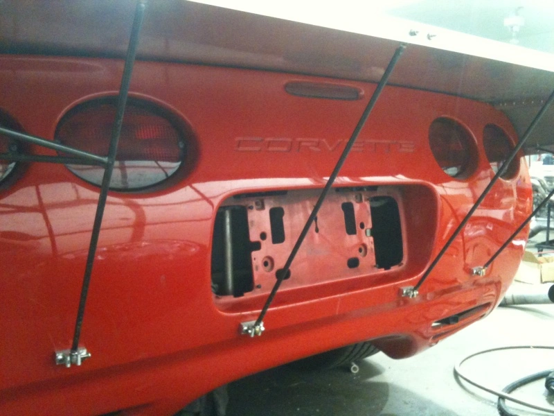

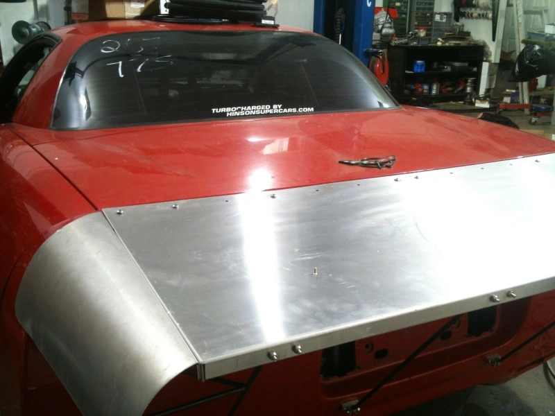

Custom adjustable rear wing.
Rear wing support for additional drag and down force. Braces supported by custom structure built behind the rear bumper.

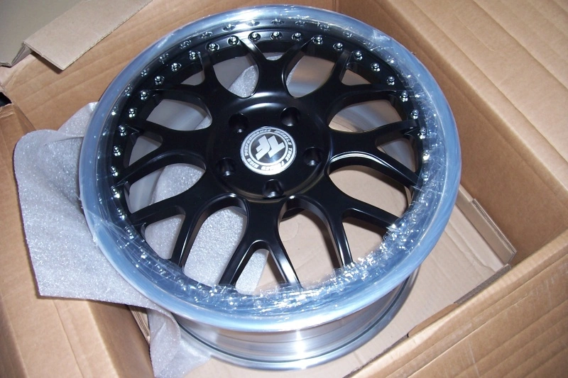

True Forged 18" wheels.

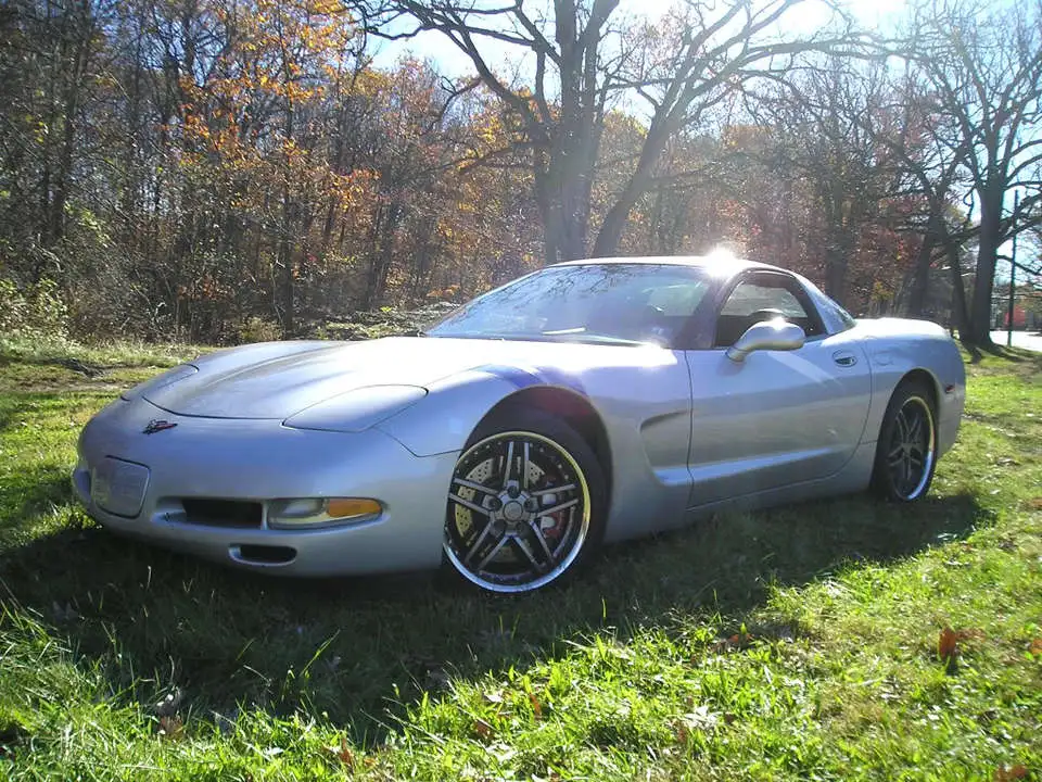

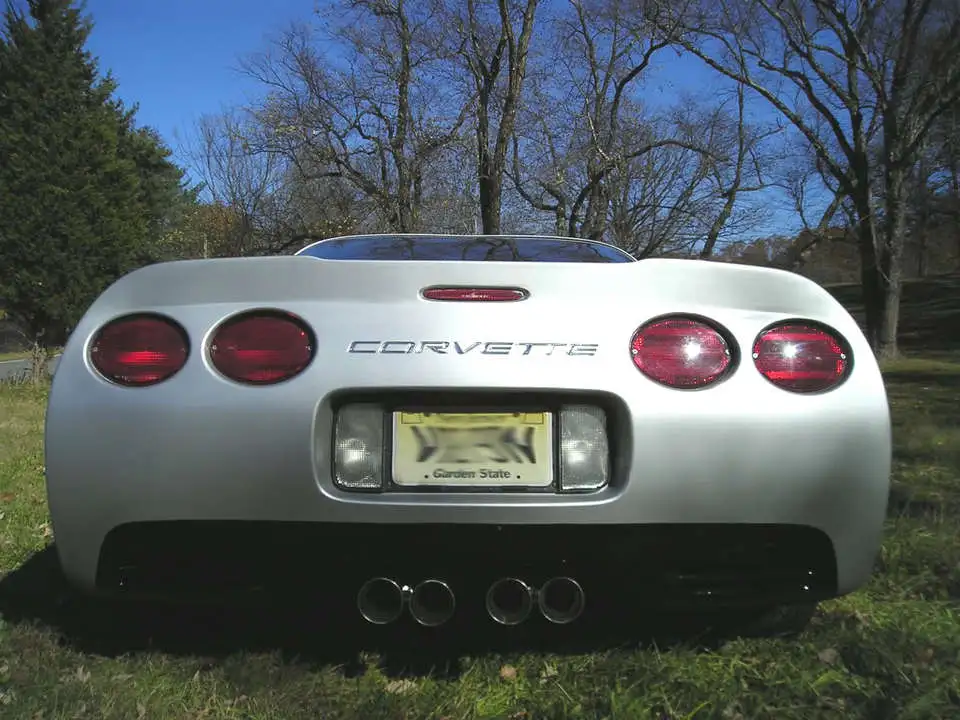

Man that vette is awsome. Some day I would love to build mine into something like this. So farI did a LS2 roll cage Z06 brakes with the 14 inch rotors Pfadt suspension Corsa Exhaust . I Hand built some of the body mods. To much to list LOL . I dont race mine its more of a street car.

Good looking c5! Like the rear bumper and wheels. Never did that on my rear bc it was black, but looks good on silver/red/yellow cars

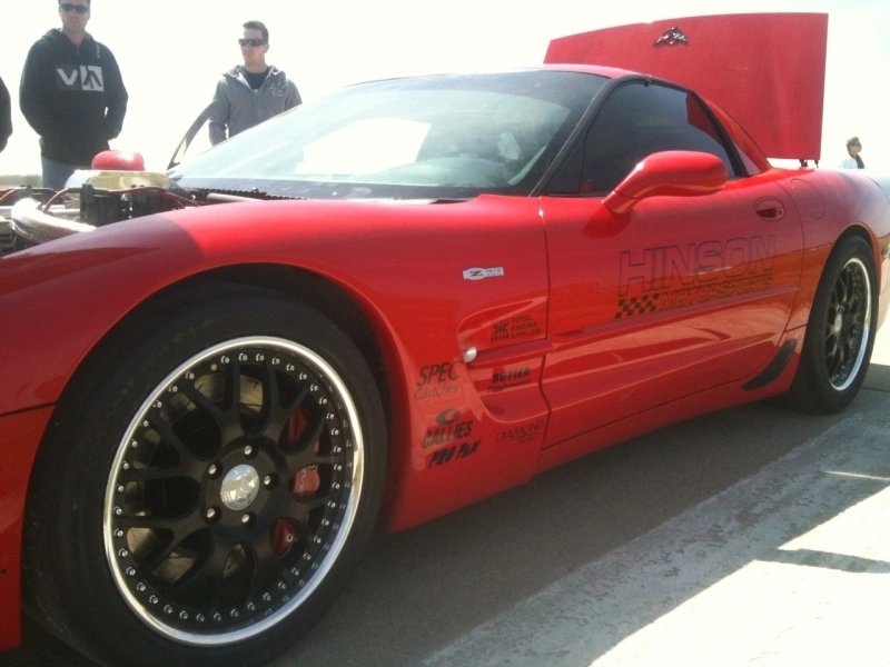

LOL Starting to look like corvette forum now LOL But at the end of the day we are all into one thing CARS and speed. And DAMN I love that red Z
