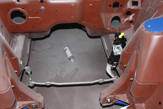

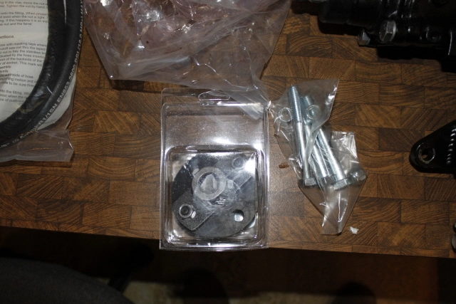

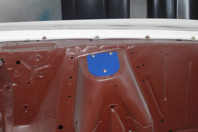

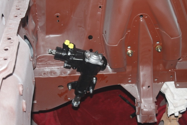

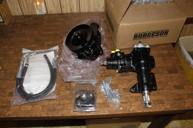

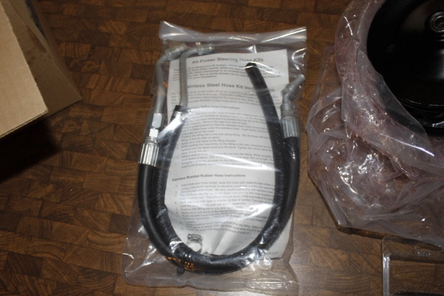

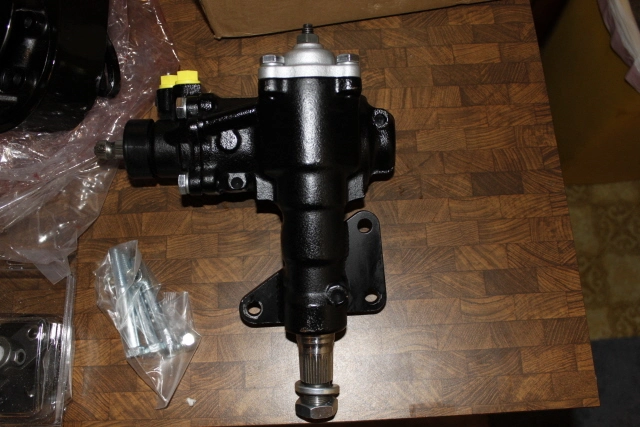

finaly, my borgeson steering kit made it in today. every thing is painted and ready to install. i got the new rag joint and hose kit so it should be a bolt in.
the box is very nice but heavy, and came with the bolts. it will not go in untill the car is in paint ,i hope very soon. i have been very buisy and not had time for my car:cry:

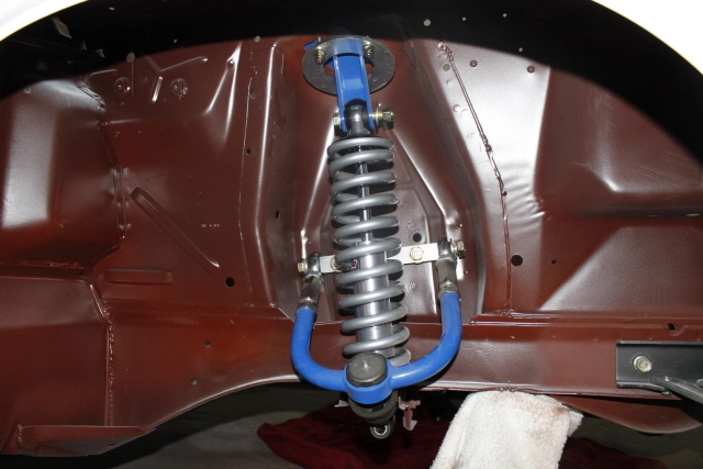

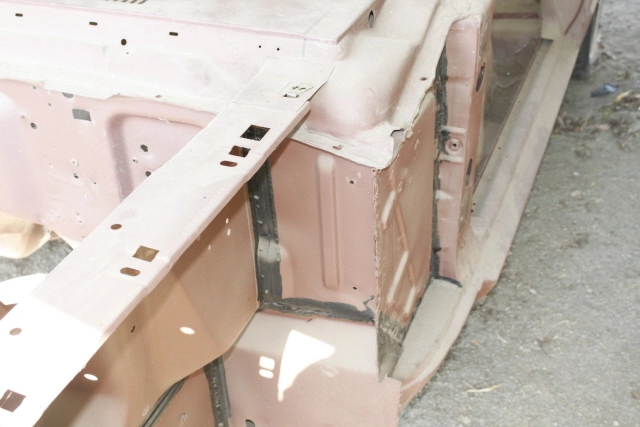

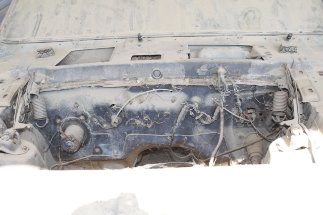

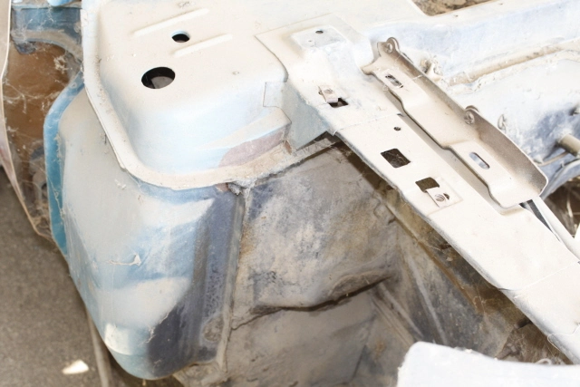

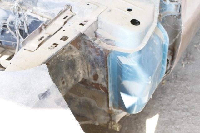

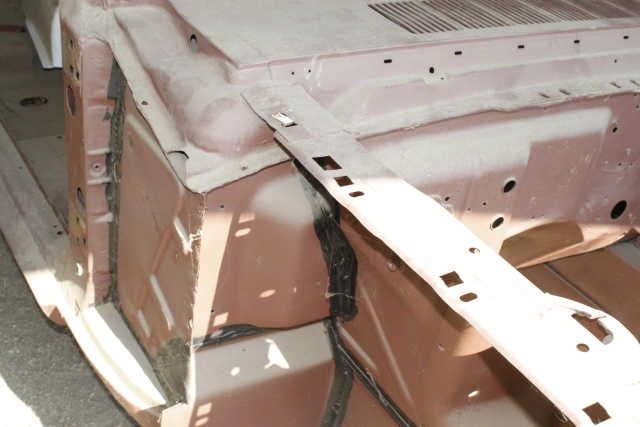

In the first picture above, in gray primer, notice the passenger side firewall between the engine compartment sheet metal and the outer cowel above the torque box. This is the area that I need to replace on my 69. My question is why the bulge. Is it for strength, I can't see where it provides clearence for anything. This panel is not available . And it looks like it would be difficult to fabricate. Any suggestions on how to replace short of a new firewall.

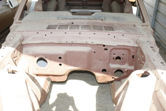

i looked at my other 69. and compared it to the 65 siting next to it . the outer part of the fire wall looks to be the same thing 65-69 .the only diff. looks like minor changes in the middle /engine compartment and that is not a whole lot. so i think that patch panel will work. the heater boxes are pretty much the same but the 69 has some extra pieces attached than the 65-66

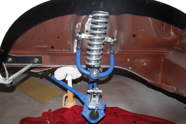

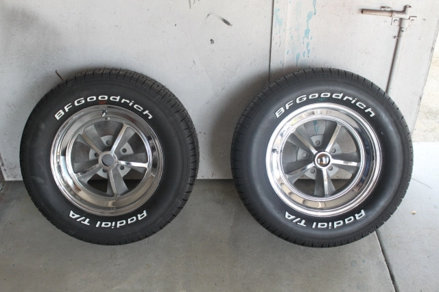

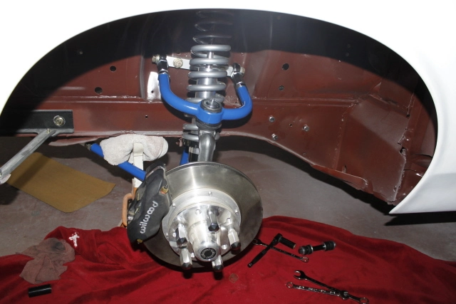

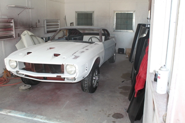

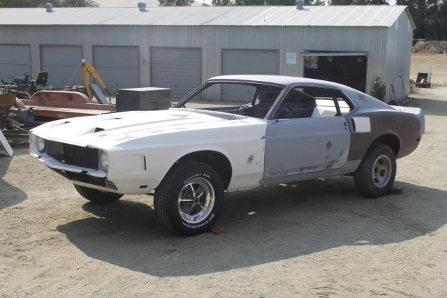

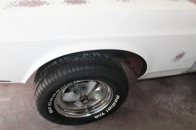

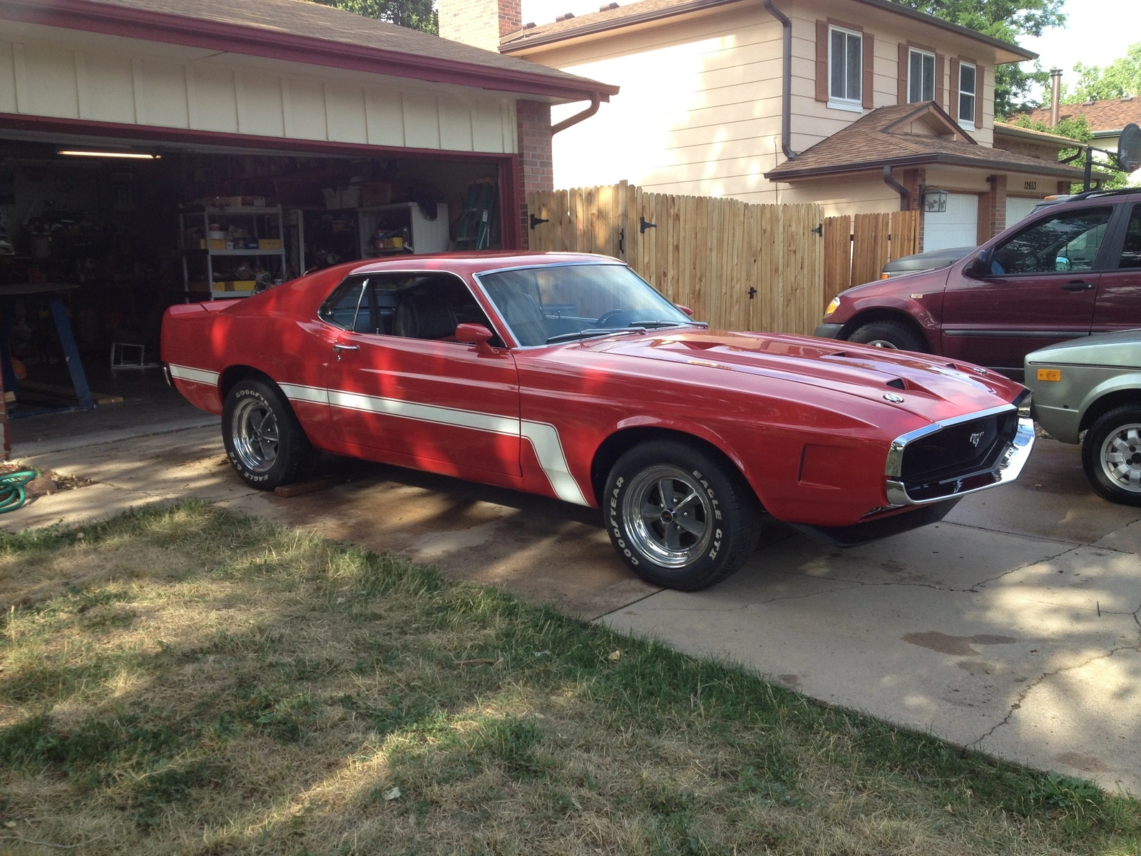

i wasn't ready but i bolted in the front suspension today. the borgeson box bolted in place without a problem. i just figured out i didn't order tie rod ends and and an idler, so i had to use old ones . i just need to be able to move it out of my paint booth for now . the turn radius is not going to be right it doesn't turn enough. the two stops on the lower control arms either need to be bent or ground for more turning, the box will turn further. the coil overs bind against the upper a arm bad at full droop and actually a bit before that.it would probably never get to that point street driving but i want to hit the road race courses and it will be a problem there,i am going to have to look into that. i went to put wheels on it so it will roll and found out my factory steel wheels will not clear the center of the rotors. i ordered two 245 60 15 BFG TAs and i am going to have them mounted on two of my shelby wheels, they will be here tomorrow . i have some primer and paint to spray so at least i will be able to use my booth now.

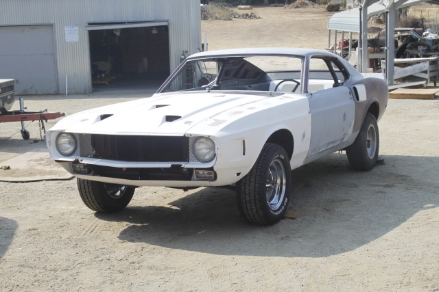

i just love the smell of brand new tires. i only bought the two fronts .now i can roll the car out of the paint booth. i went letters out ,i wanted black wall out every one else said letters out so i did. . i will have all kinds of clearance. 245 60 15 TAs sounds like a big tire but the shelby fenders have a big opening and i know they clear the rear . the guy mounting them was very impressed .he said one wheel only took a very small weight and one wheel didnt need any weights at all.
i noticed when i had just the rims on they were very true ,no run out at all side ways or up and down. a little twisting on the tie rods to get the tires straight and i can move it out.
