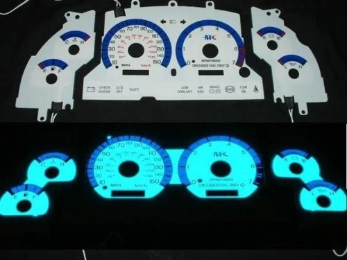

Wanted to get to the instrament cluster and the headlight switch is a bear....secrets for success???????looking into the white face replacements.....found this on...yes EBay---about 27.00 bucks looks like a decent kit that allows to dim these by them selves or with the rest of the lights, light swith first....thanks crew......
