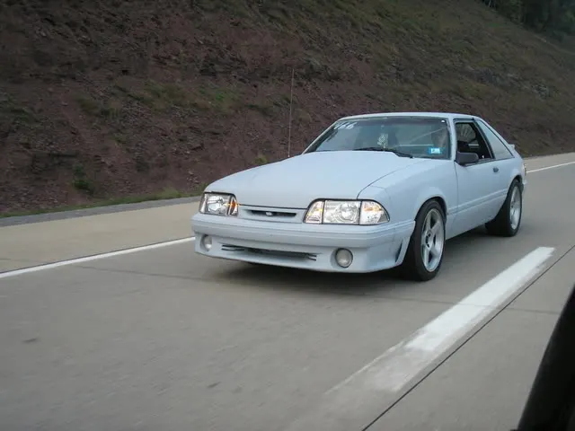

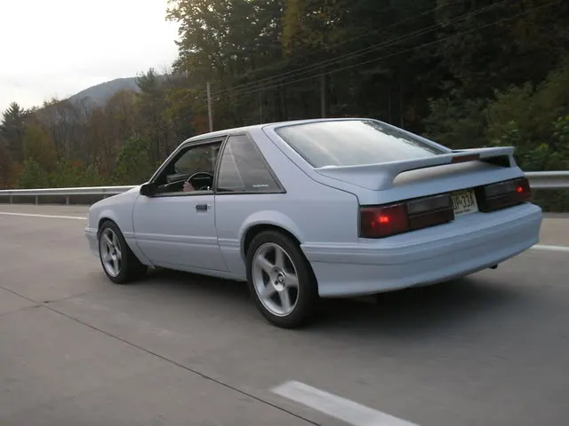

255/40's in the front with 275/40's in the back and the quads swapped is the best sizes for a 9 inch rim IMO.
Here's a pic of my car with those sizes.
