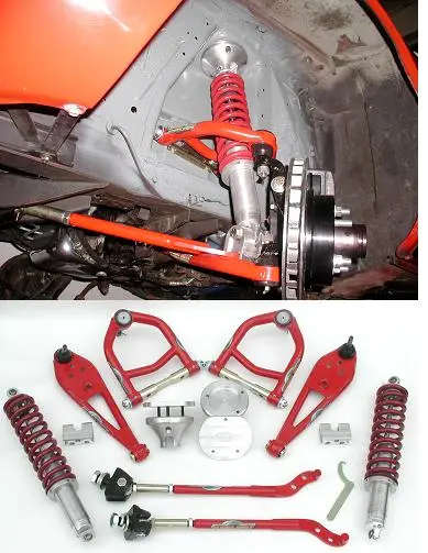

This is the new coil over set from GW . I an planning on install a coil over but, I an un decided as to which system to use .
The photo below shows the latest new kit, a coilover system for 67-73 Mustangs. It also shows our category 5 disc brake kit. There are two different coilover systems available: Street with an emphasis on drag racing or we change the geometry and go street with an emphasis on road racing. Factory suspension travel is maintained with 7 inches of travel. Note: Other coilover kits on the market cut the travel to short, 4 ½ inches. Wheel rates are vastly changed and shock control is greatly improved.
Other features are
· Adjustable ride height
· 2 ½ inch id springs are used which provide a wide spring rate selection
· Different shock options are available from no adjustment to fully adjustable bump and rebound.
· Stock spindles can be used whether drum or disc.
· Kit only requires 6 to 10 holes to be drilled for installation depending on which kit is ordered.
· No cutting or welding required.
· Control arms are powder coated
The kit comes complete with the following components.
· Tubular upper control arms fully assembled with the following – billet upper control arm shafts, Del-a-lum bushings, and performance upper ball joints.
· Tubular lower control arms fully assembled with spherical bearings and performance ball joints.
· Adjustable strut rods featuring special clevises for proper frame indexing and Teflon lined rod ends
· Front shocks complete with adjusting rings and spanner wrench
· Special billet lower shock mounts
· Special billet upper shock mounts
· Billet engine compartment shock mount tower covers
· Assorted hardware
Alignment instructions are also furnished with each application.
Prices very with shock and spring combinations.
Contact Global West for further information.

Cliff, I saw that setup mentioned in a corner-carvers post of yours I believe (I lurk there 'cause I have only a 'throwaway' addy). Anyways, it looks like a nice setup, not sure where the '6-10' holes would have to be drilled though.

My 65 has the UCA doped 1 in. if reminder GW dopes their UCA 1 5/8. I an not real crazy about drilling any more holes in tower maybe making a adapter plate would work. Any thoughts on how to make it.

Did not get that till just now. Thank you, and I'm sorry Cliff. I like that GW set up with the screw in ball joints. Mounting the spring on the lower arm makes a lot more sence. My deal is to use what Ford gave us. That's why I re-do the stock stuff. The top mount GW came up with is much better than some of the other coil over set up's I have seen. I like the idea of using the upper spring saddle for the top of the coil over if your going to use one. I have found that using a roller spring perch, heim joint strutt rods and a lower arm with a spherical bearing on the inside pivot works very well. It free's up the suspension so the springs and shocks can do there stuff. Way better than the stock stuff and doesn't cost much more if you can cut and weld.

Does any body have the Angel of the ball joints for a 65 & 66 on G/W set up and the drop on the UCA?
Also need to know how long from the center of the ball joint the center of mounting shaft.
