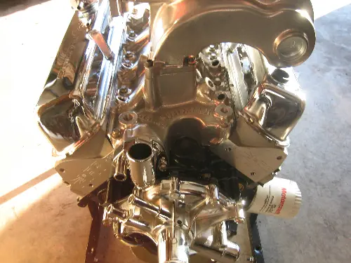

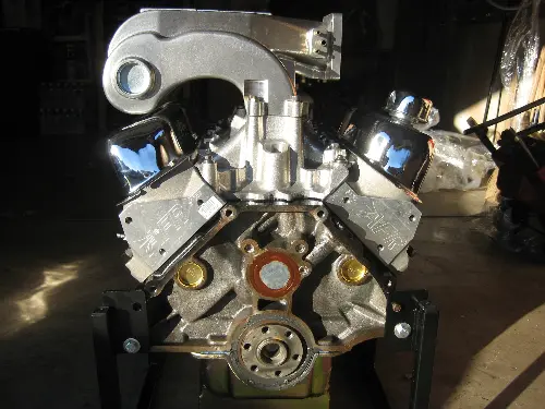

See my setup? im about two weeks away from getting my tune and i have the dss 331 pro bullet. Try to hold off for a bit and ill give you my numbers and this will possibly help you on your choice of parts and etc....
