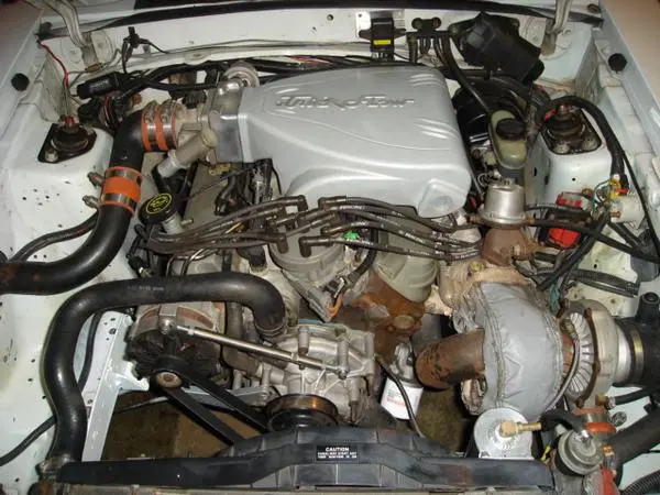

Hey guys i wanna go back to power steering and ditch my flaming river manual rack. The Problem is i have a turbo kit on the drivers and i cant put the power there,would i be able to put it on the passenger side instead? I was thinking the power could be installed where the smog pump used to be right? Heres a pic as you can see the downpipe takes up the whole drivers side of the block.

Interesting. I have never seen It installed on the pas. side. Could be possible. Make a new install plate, maybe longer pump to rack tubing etc.
I have been missing my power steering when i use 225/55-16 frontwheels.
Its to heavy for autoslalom, and parking etc.
I think Maximum motorsport have a progressive power steering kit. Including everything, and a minipump and external resrvouar. Steering is important.
