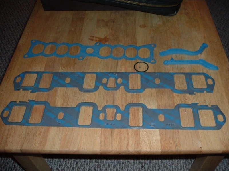

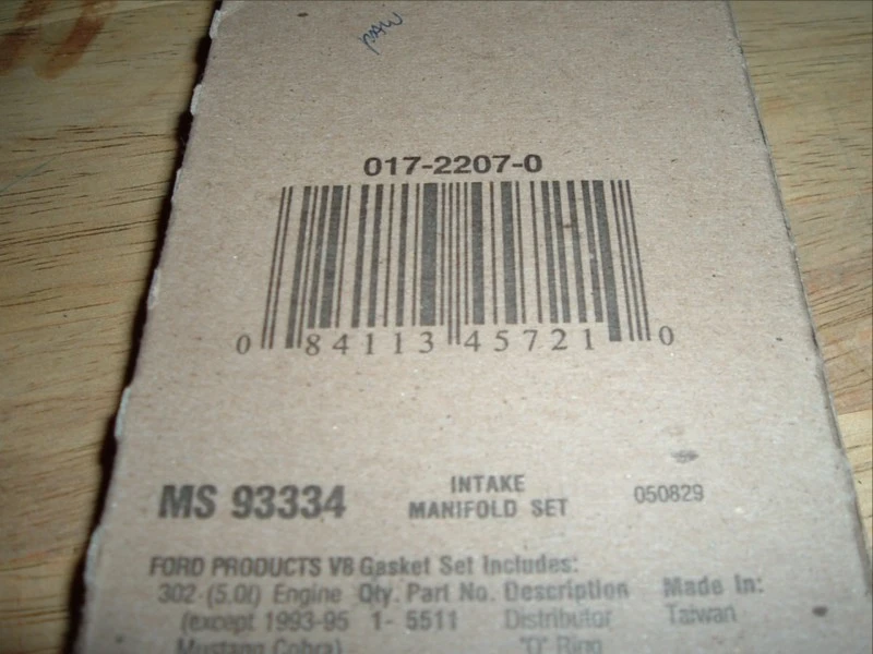

what about these 2 blue things that came with the fel-pro gasket kit?
and do i put some adhesive or something on the gaskets to keep them from moving while i am trying to get the intake positioned?

I don't, but you can. The rear seal has a nipple sticking out of it that gets pressed into a hole in the block to help hold it, but a little ultra black rtv on the bottoms of the seals will hold them good if you give the rtv time to cure. That is the MS 93334 kit and I hold it's quality in high regard. Once the gaskets are in place, spot rtv at the ends of the seals per the instructions. I've never had this kit leak in any way when properly installed.

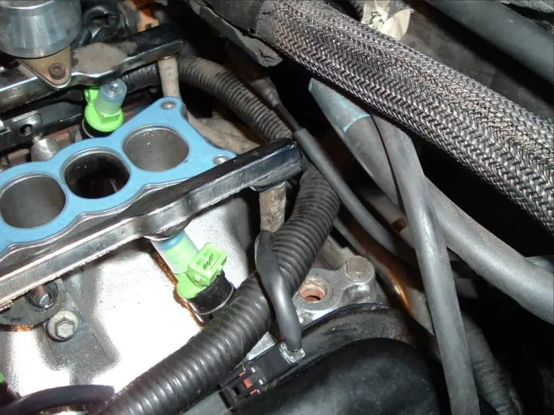

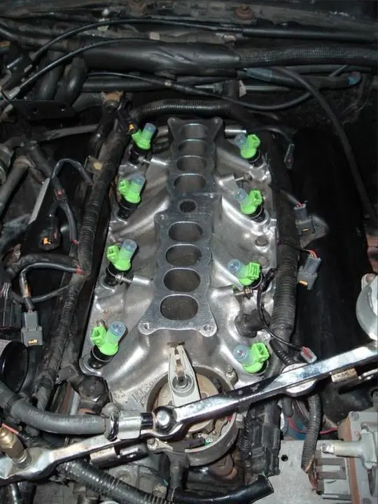

the lower is in, but i have questions:

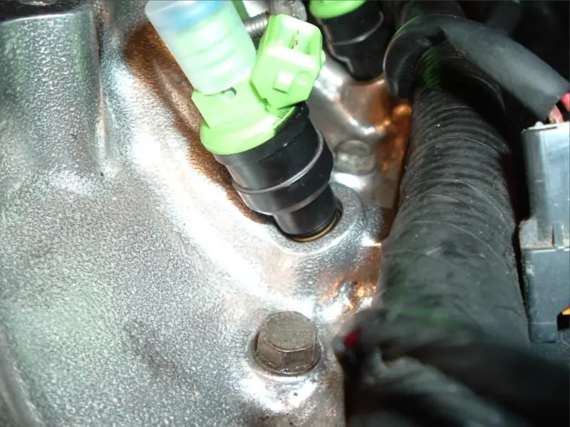

the injectors feel like they should be tighter, but i can't get them in any further, do they look right?

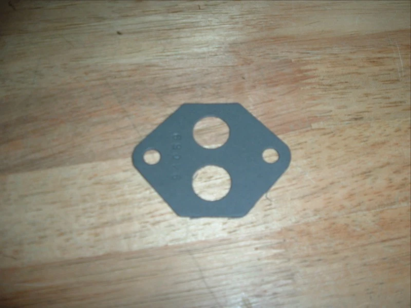

what is this hole for at the back of the intake?

any thoughts on the questions? i really don't think the injecters are all the way in, can i tap them ever so lightly with a hammer (with the protective plastic covers still on the tops)?
I wouldnt force them in with a hammer....if they arent popping all the way in then something is wrong i think. Either the injector or intake. Is each injector seated at the same place? What injectors are they? Where did they come from?
Might help if you lightly oil the O rings.

ya try a little oil, when you bolt your fuel rails down it should push em all in nice and tight and hold them there.
they are ford 42# injectors
Grady
i'll try it
