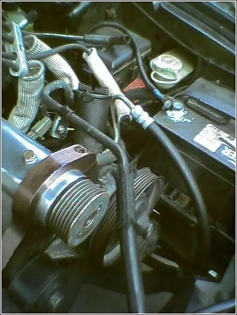

i'm hoping to start it today, but i have a problem/question:
the belt is going to hit the a/c line. can i just bend the a/c line? should i bend it up or down?
From the photo, it almost looks as though you could just slightly bend the A/C line to the point of clearance just by pushing it forward from the area located just behind the power steering reservoir. You’ll have to judge that area yourself to know for certain, but it would seem like the easiest course of action to me? :shrug:
