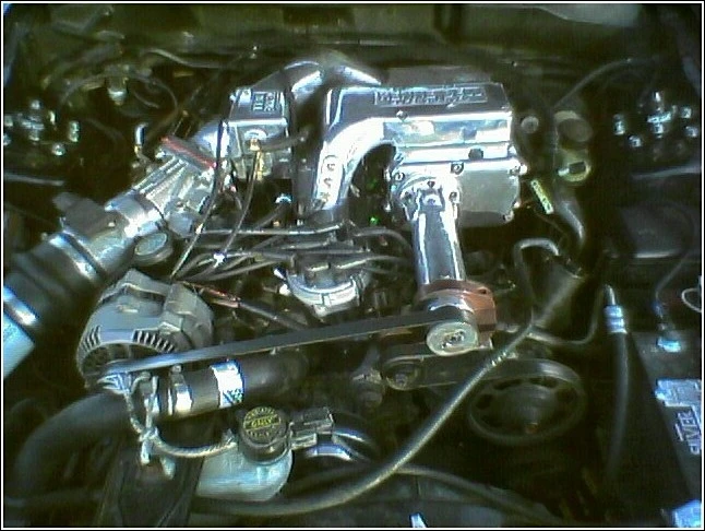

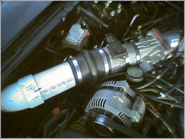

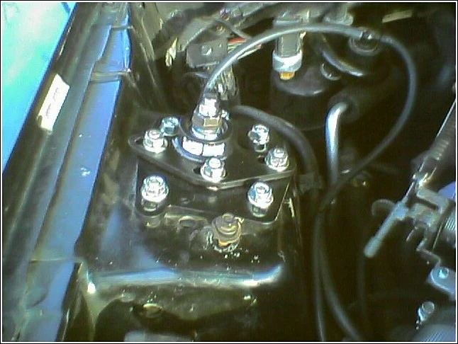

here are some pics ... they are not very good, i still can't find my camera. these are from my cell phone:
he also intalled the coil-overs and the c/c plates:

You are making a lot of progress Chris :banana:
Everything looks just GREAT :nice:
