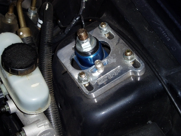

3 bolt will be just fine man. I'm too lazy to put in the 4th bolt in my c/c plates, but ive got pro3i c/c plates. They're pretty nice. I'm happy with em.
3 bolt BBK C/C plates work just fine for me. Easy to intall no drilling. They have a neoprene washer where the strut bolts in so it gives you a nice quite ride and no dreaded C/C plate clunck that you get with the race version ones.

Did BBK steal this design from MAC or the other way around? They look exactly the same. :shrug:
I think the MM are the best on the market.
istall was easy for me. no complaints.
From a design standpoint I think there are the best.
spherical being gives more rigid mount to the strut but it also transmits road noise on a very crappy road surface. it does not bother me. Some people have complianed so I figured I would mention it.
