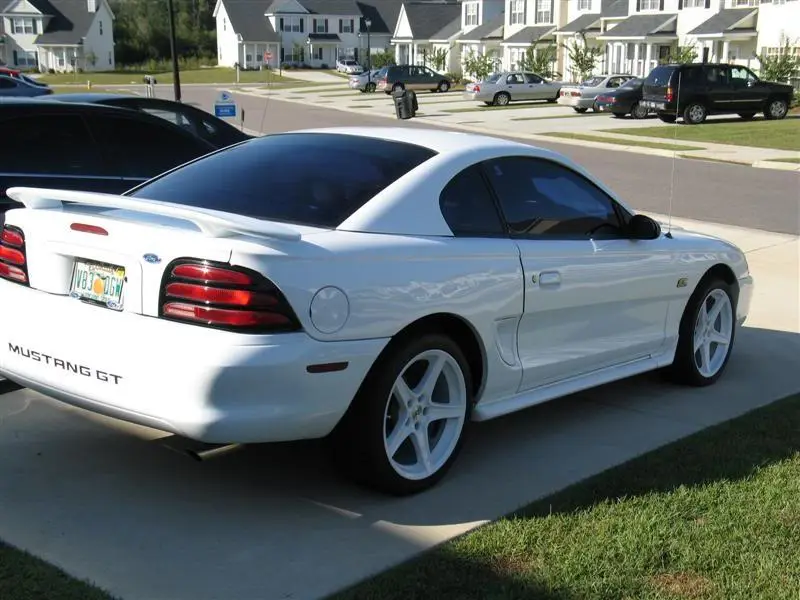

Here is what KAIO/WG DGS on a well prepped paint surface looks like on crystal white (about 85% of the clear coat scratches removed)
Well I used the Ultimate Detailing Machine aka UDM (a copy of the Porter Cable 7424 Buffer/sander with a stronger motor) and a light cutting pad (orange in color) with Menzerna Super Intensive polish (SIP). The combo removed a lot of the scratches with just one pass (3/4 minutes for the polish to break down in a 2x2 section). You can not get the same results by hand believe me I tried before buying a buffer and pads.

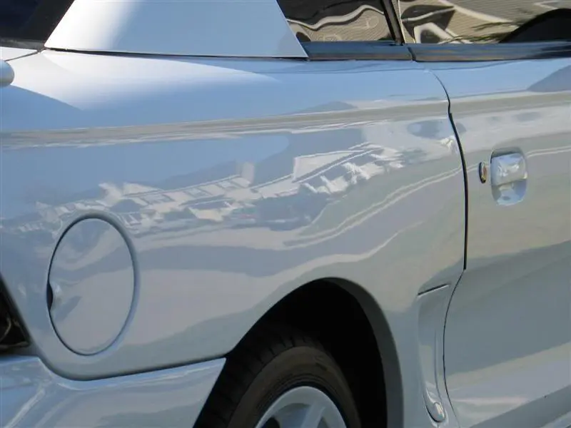

Before *Notice fine CC scratches*

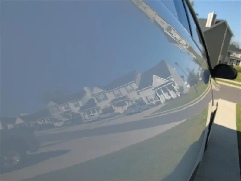

After (One pass with SIp and Light cutting pad*
