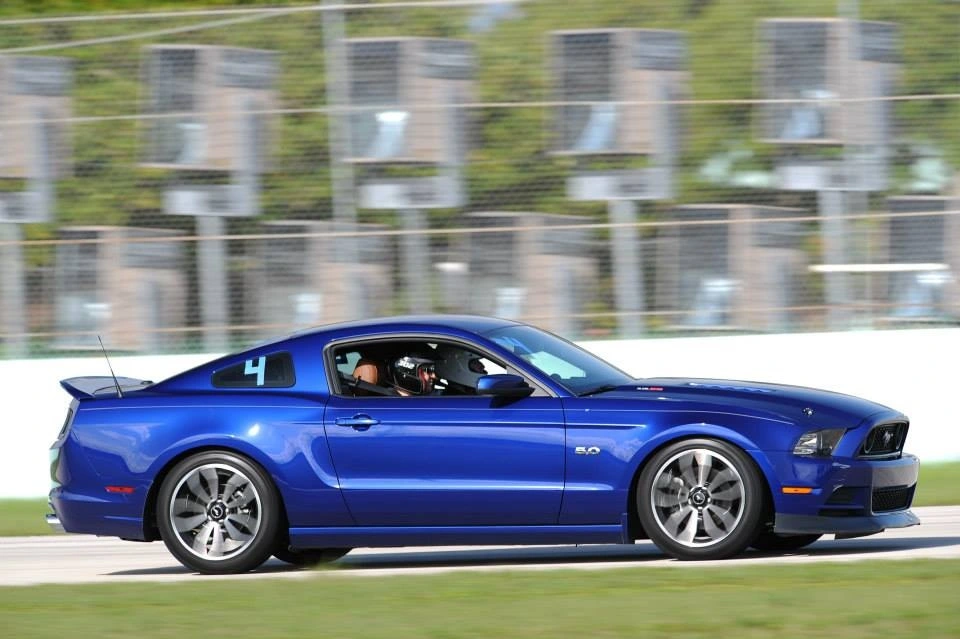

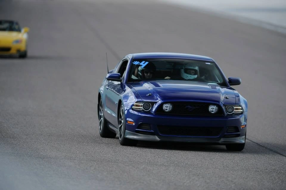

Hey guys. Here is my 13 GT. I do alot of road racing with my car and planning on doing Shocks/Struts kit with Camber Plates, Shock Mounts and a higher set of springs(FRPP 1.5" all around). This is a kit i found through Vorshlag. http://www.vorshlag.com/product_info.php?cPath=141_142_179&products_id=559
Car currently has
Roush Axelbacks
Airaid CAI
Steeda Extreme Sport Springs (1.75 front 2.0 back) / Steeda Adj Panhard Bar
Stillen front lip
gt500 rear spoiler
gt500 wheels (255/40/19 front 285/35/19)
Please let me know all of your opinions. Thanks!

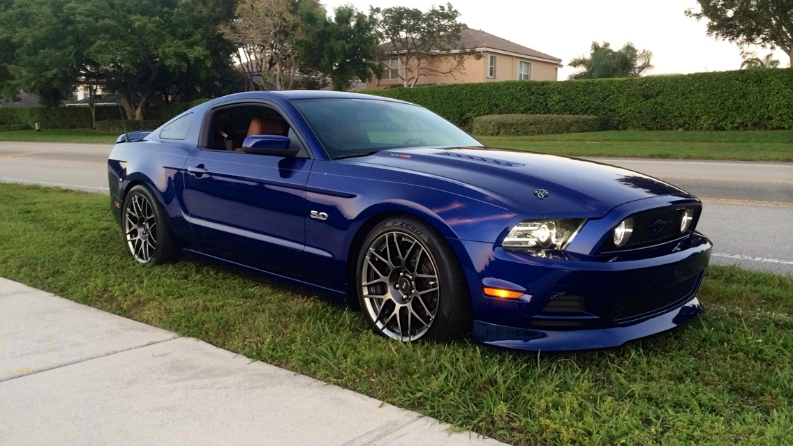

Very happy with my daily driver/track setup:
Eibach Pro-kit
Koni Yellows
MM camber plates
Whiteline PHB and bracket
Whiteline adj rear sway
I run Rivals on track, and when I swap out the daily Pirellis I also change the camber (which toes the car out too), and stiffen the shocks and struts. Street car to track car in about 40 minutes.
Don't forget the brakes!!! I've added the FRPP brake ducts to my Brembos, HP+ pads, Motul 600 fluid through braided SS lines. Much better!
Now about that oil temp...
