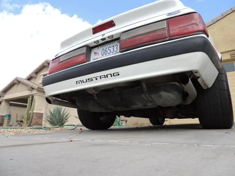

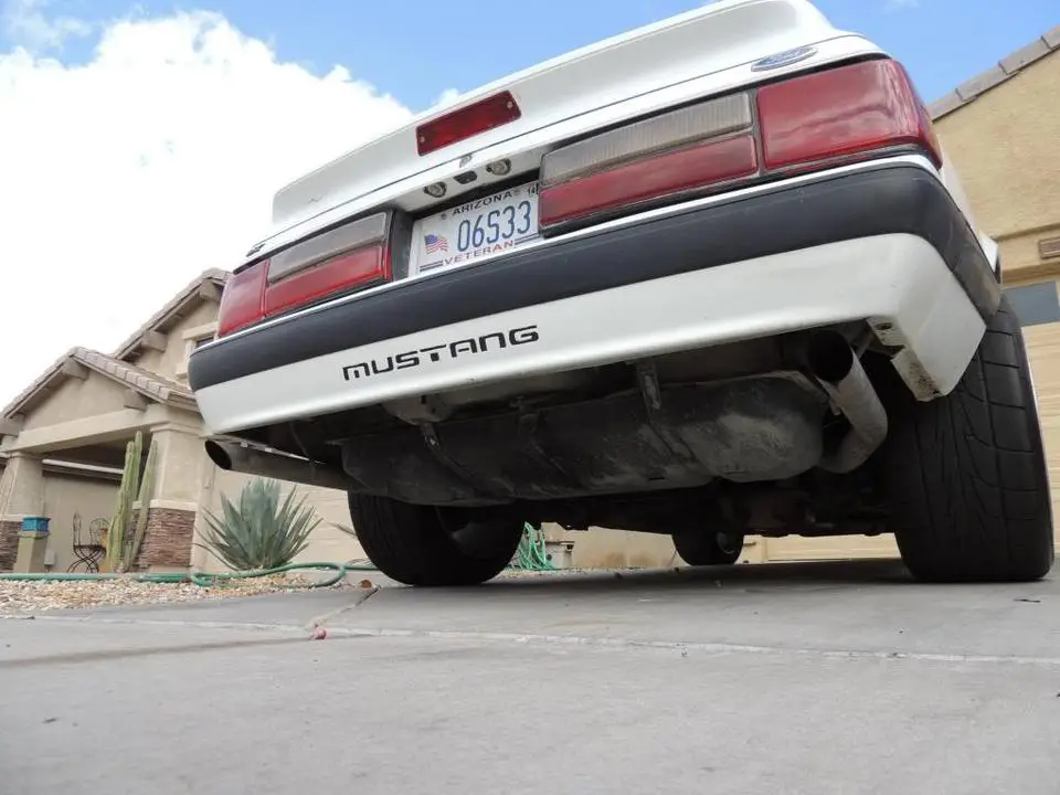

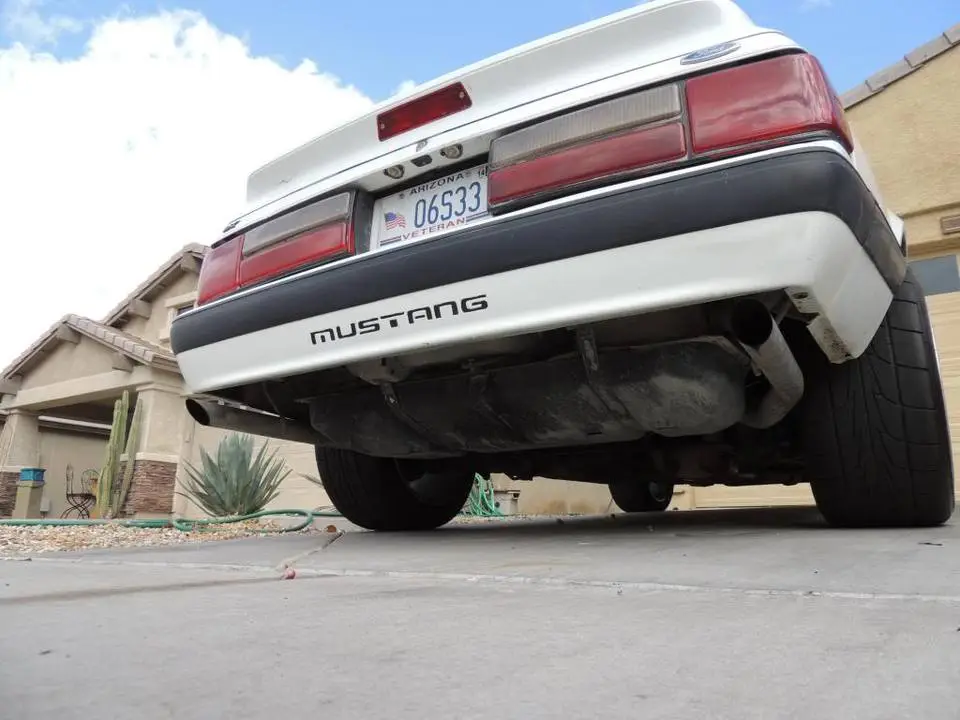

your offset doesnt seem right please post pics.
heres a pic of my 17x10.5 with 275s i will be going with 315s next.

Thanks for the picture David.
I'm not sure if yours is lowered at all but I have Eibach springs that lower the car about an inch. I fogot all about that until I saw your picture and saw how much distance you have between the top of the tire and the fender lip. I'm not going to have nearly that much space.
