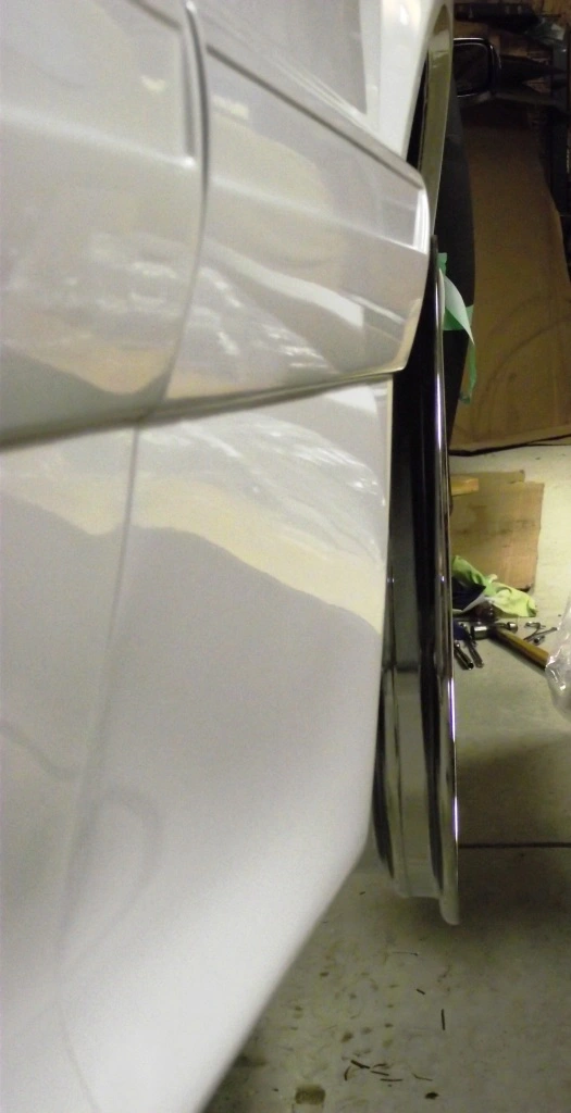

My exterior fender lips are untouched, ie not rolled at all. I did have to have the quarter opening stretched for the 30" tires though. That is a 315/60/15^

Thanks for the picture David.
I'm not sure if yours is lowered at all but I have Eibach springs that lower the car about an inch. I fogot all about that until I saw your picture and saw how much distance you have between the top of the tire and the fender lip. I'm not going to have nearly that much space.

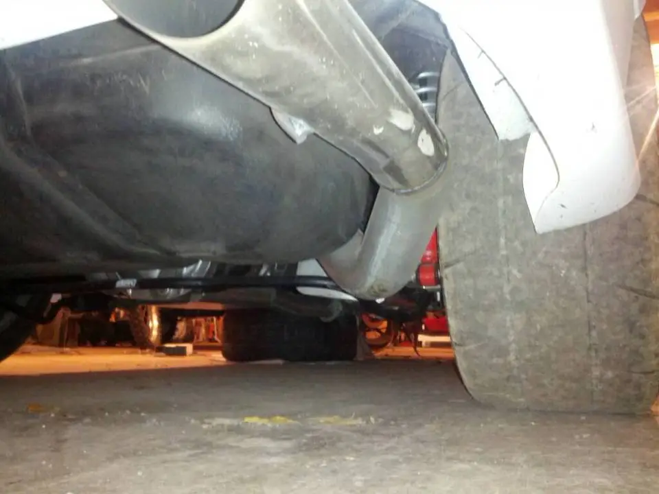

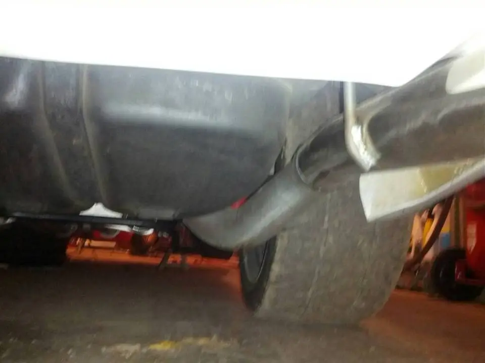

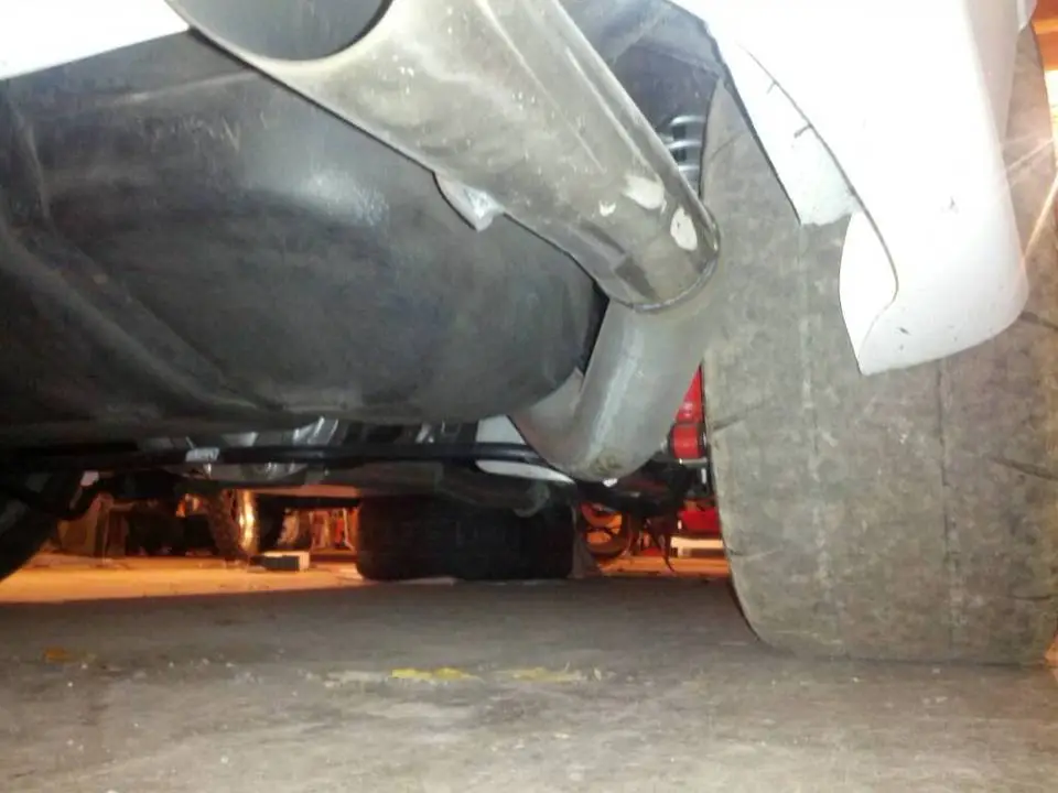

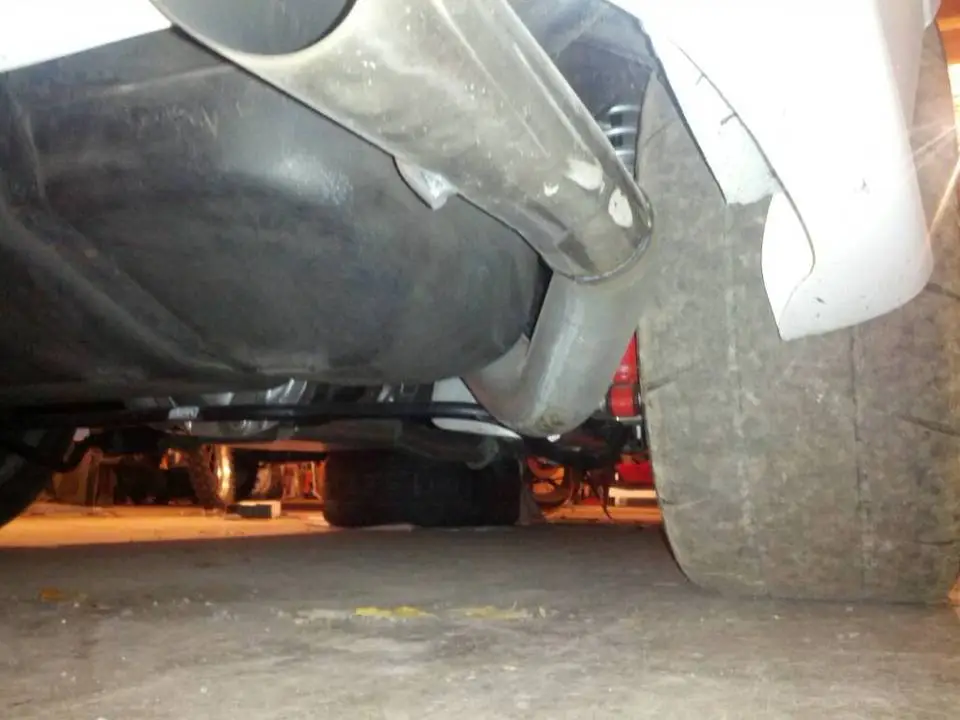

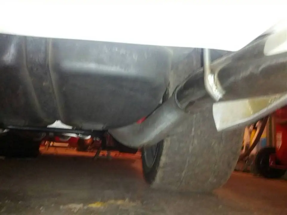

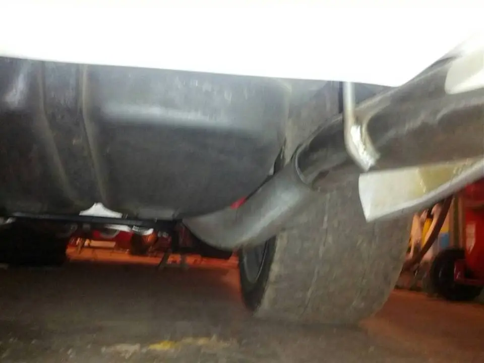

OK...after crawling under car I concluded I am pretty much at the limit width wise, and possibly height too. There's only perhaps 3/8" clearance max before hitting quads, and around 1/2" max before hitting pipes in the "massaged" area. From the side it looks like there's plenty of room(yes paint and tires are done...car has been sitting a cpl years) But that's without weight on it. Any suggestions? or just get really sticky rubber for size I'm at?
Bad angle but you get the picture(quad & pipe clearance)
..and top down view
from this angle looks like plenty of room...
I just went out and measured everything and it looks like the gas tank was shifted to the right, which forced me to move the pipe to the right which made it rub the 225 tire just a little. I loosened the tank and pried it to the left as much as I could. Then I loosened the pipes and pushed both toward the tank. There's still 1/2" between the plastic tank cover and the right pipe - and I think the 275's may rub the pipe. - but I can probably put a big enough dimple in the tube to make it clear.

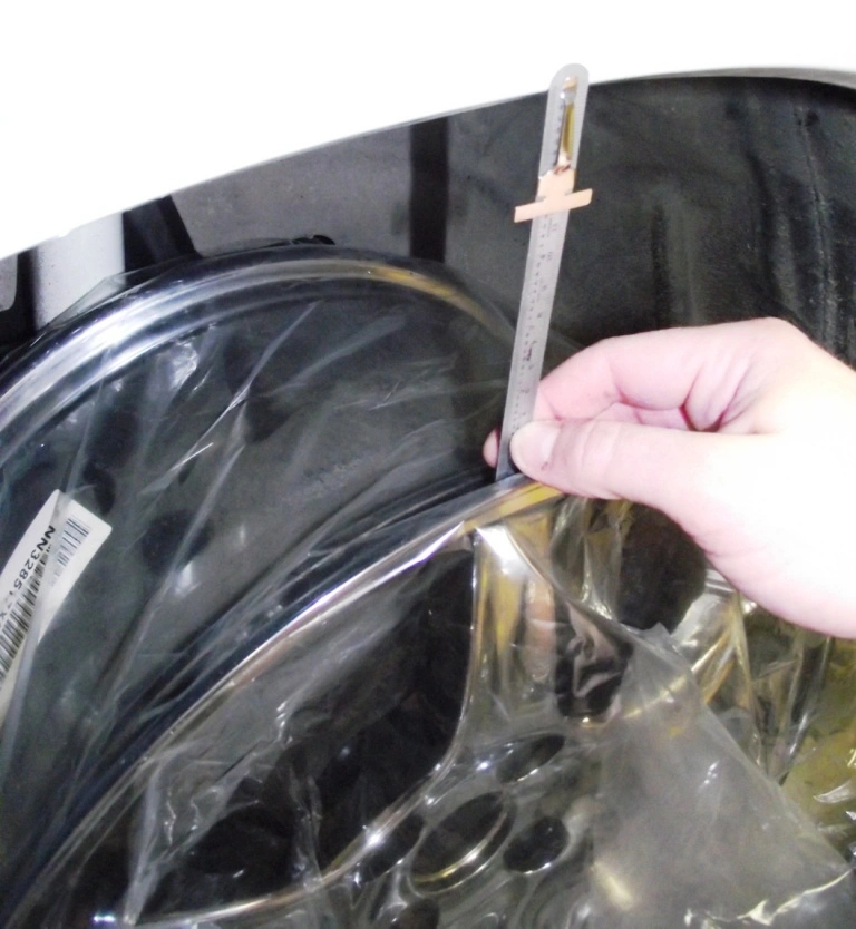

My other issue is that while I have 1-1/2" of clearance from the top of the tire to the wheel flange as it sits on the ground, the axle bump stops are at least 2" from the axle - so if I go over railroad tracks or have people in the back seat, the tire will rub. I think rolling the flange up will help but I don't know who can do this for me (not comfortable doing it myself...)

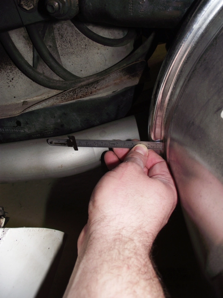

Here are a couple pictures - the 'T' on the scale is at 4-1/2" - which is the sidewall height of the 275's. The scale is 6" overall.
Looks like you have a nice suspension setup under there madspeed.. those pipes wrap below then out I see. Is that what you were referring to? And I guess lose the quads as well? You can sorta tell from those lousy pix that mine was rubbing pretty well at one point
