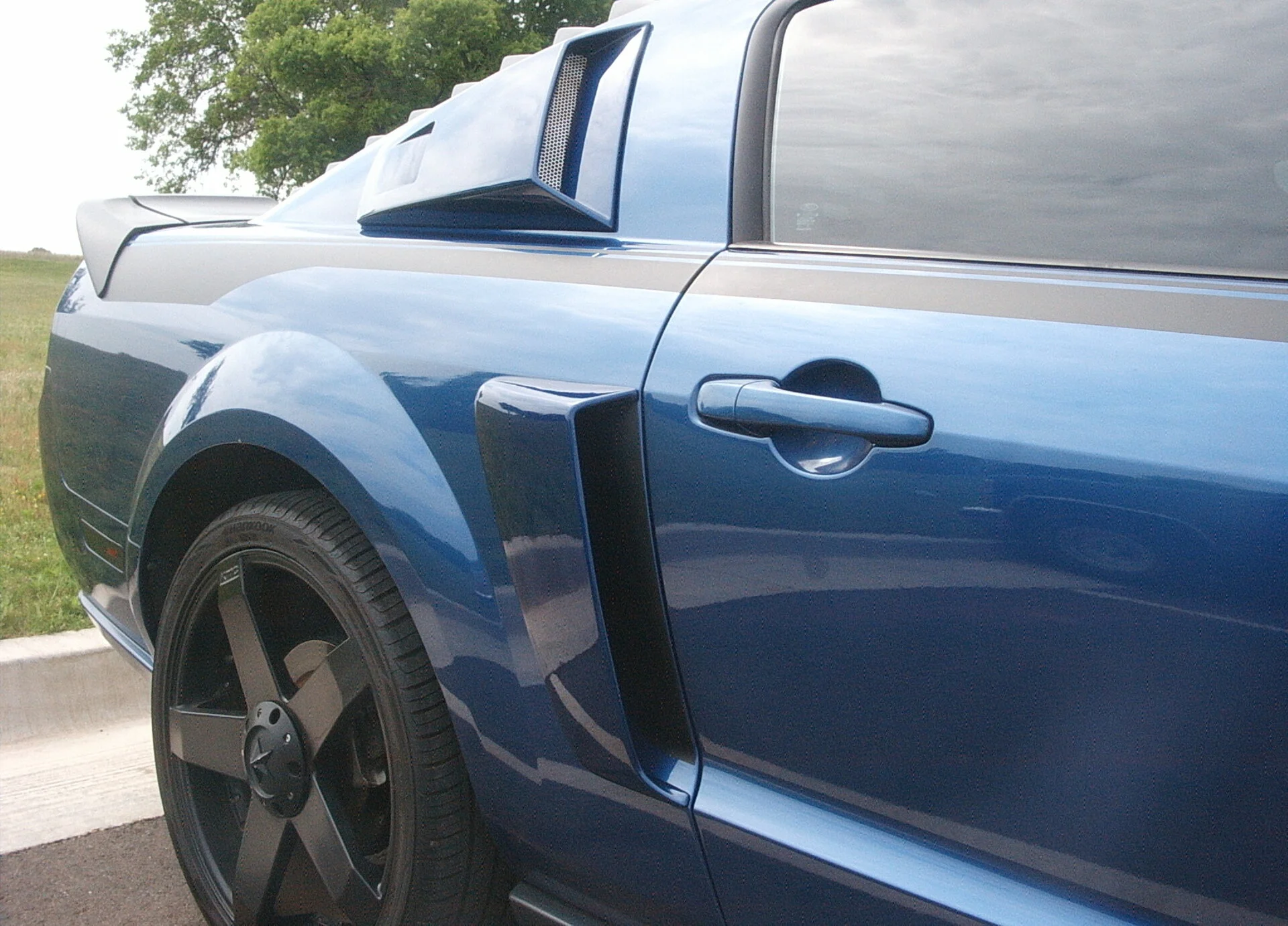

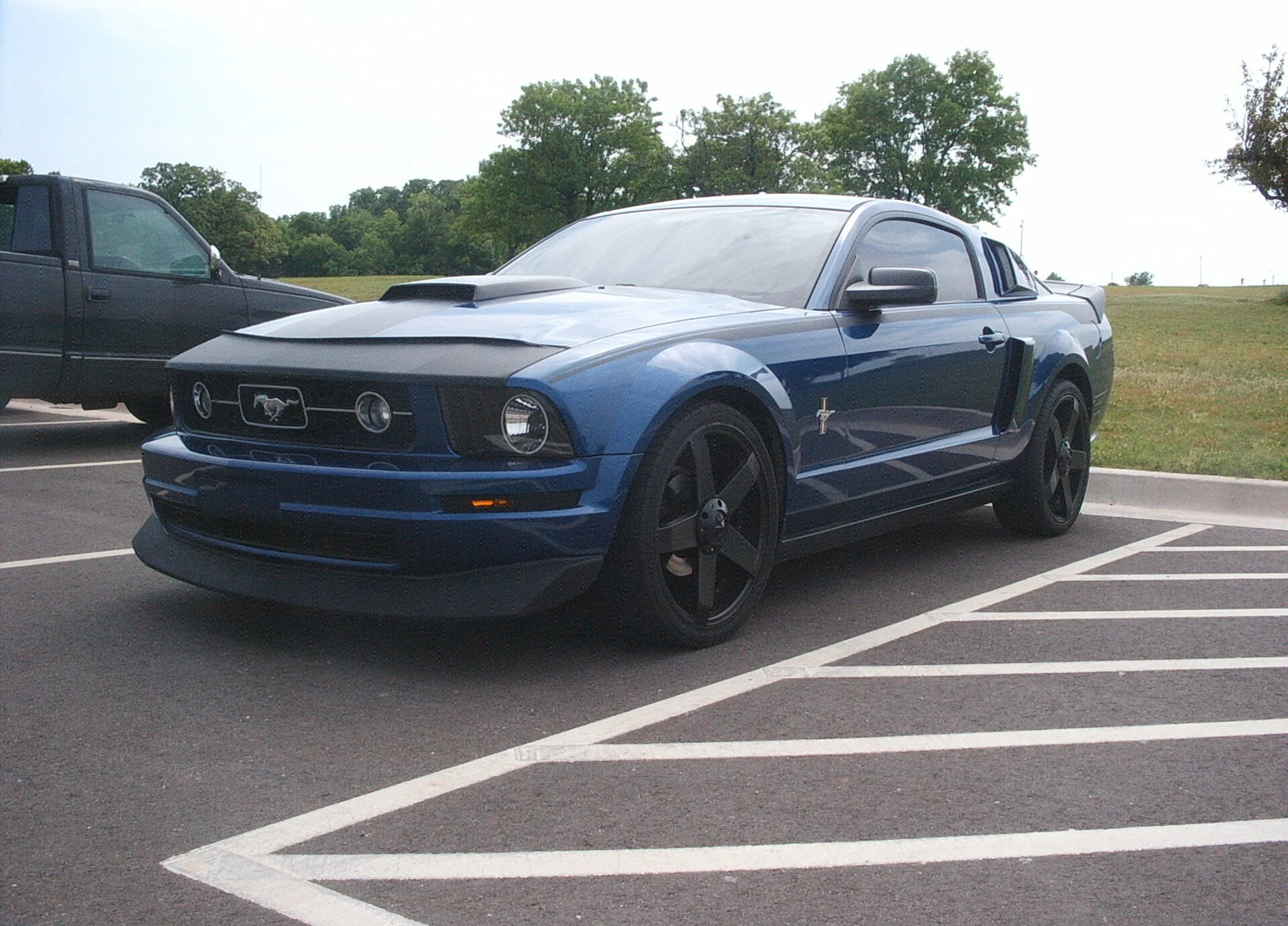

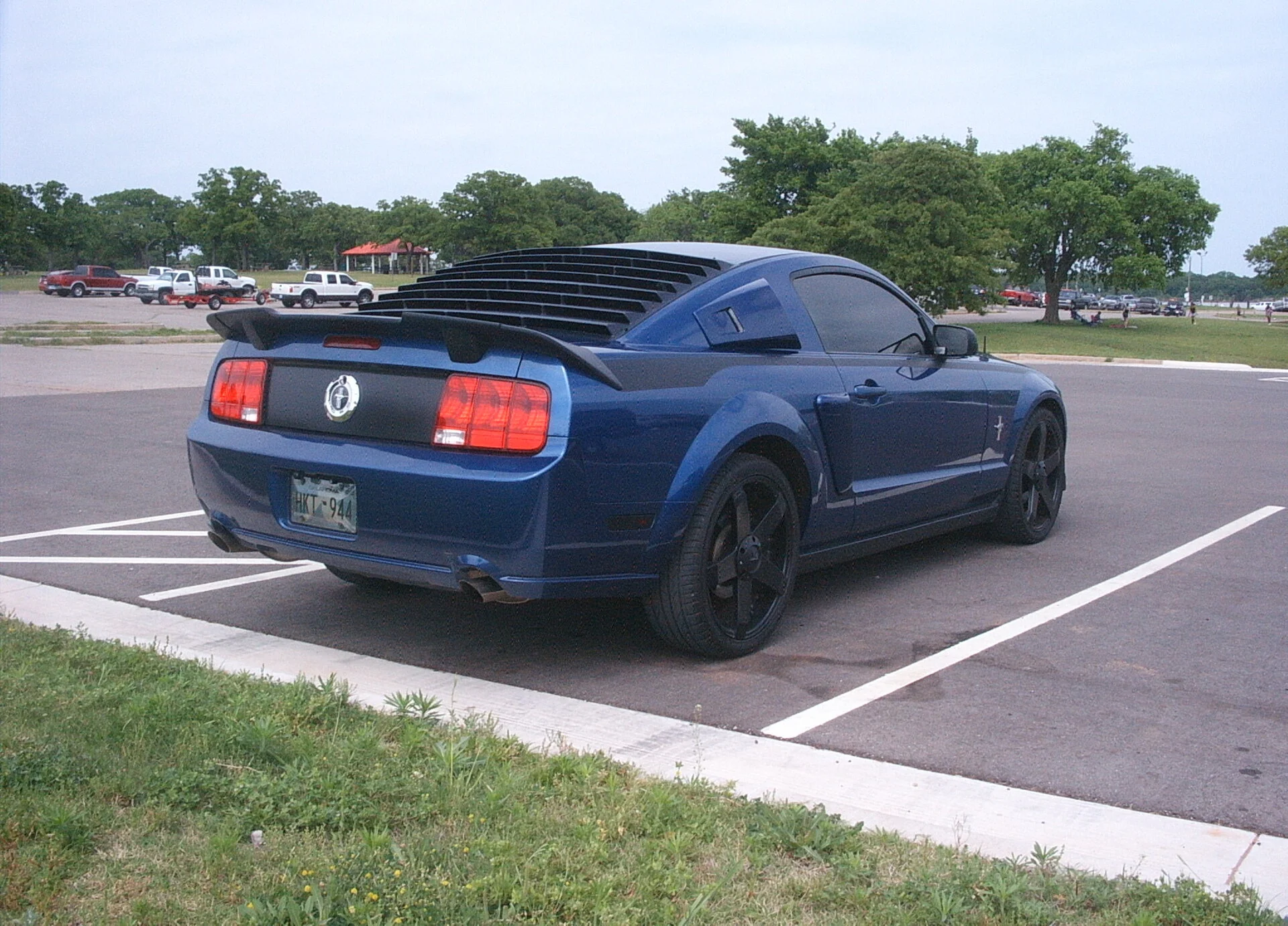

Mine has 20 X * KMC Rockstars with Nitto 255/35-20 on them. That's what it came with when I bought it. As is to be expected with 20 inch rims and low profile tires, it rides kind of rough. Rough surface irregularities make it want to wonder at times. Handles great on a twisty curvy road though.
Yeah, it's a V-6 model. Not that you can tell after all I've done to it. LMAO!! Need to post new pics soon. Have all new lighting, smoked all around with led sequencing tail lights and led third brake light. Took some last weekend but they didn't turn out too great.

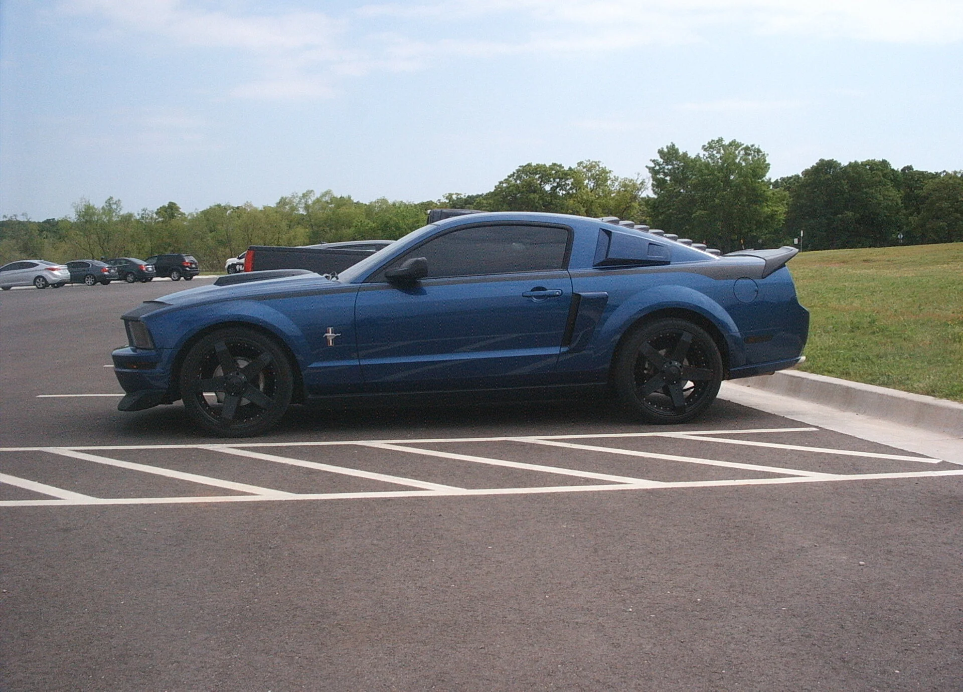

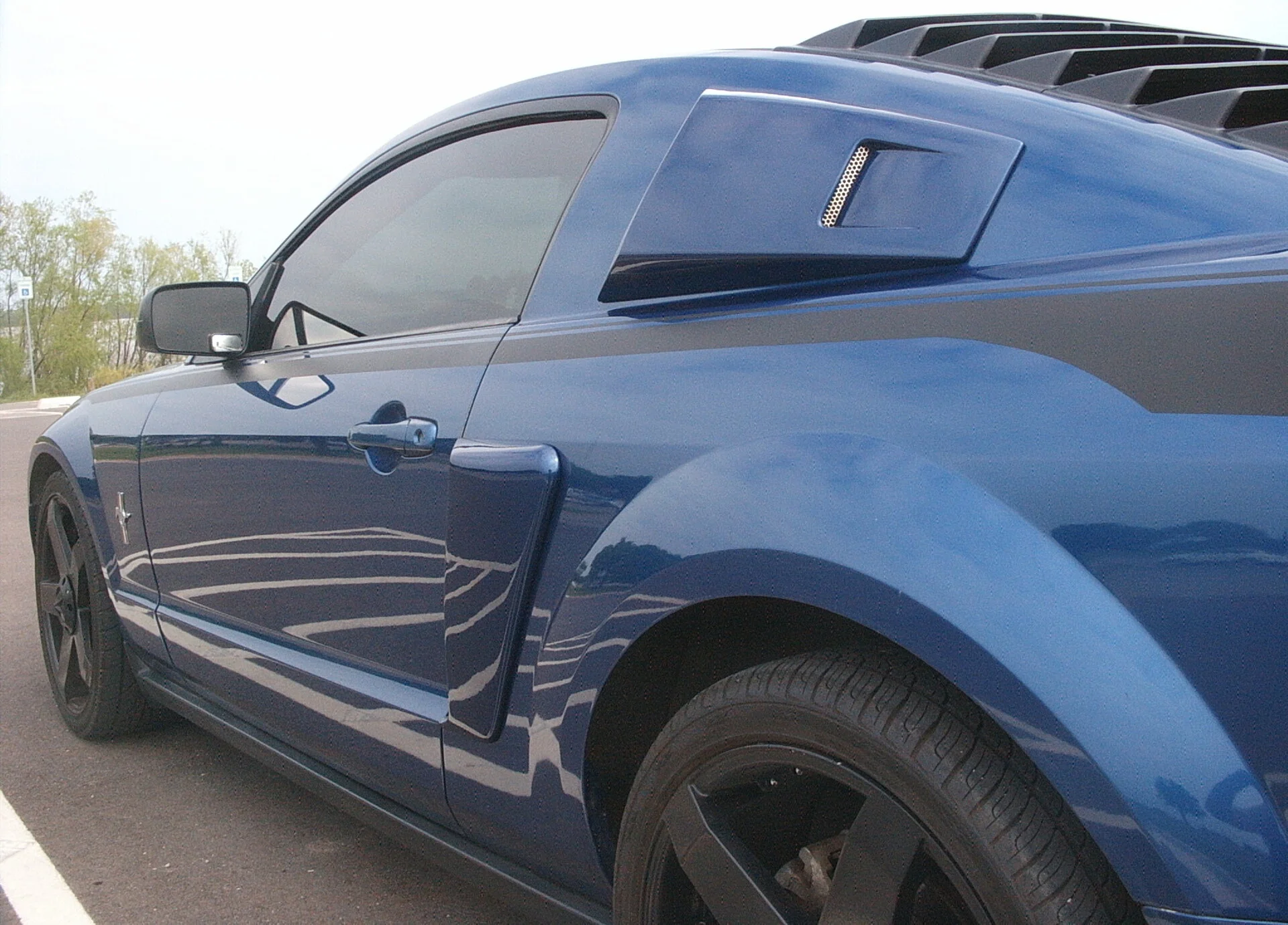

I don't know about the 18 inch rims. Mine are 20's which it came with. I had to do some searching to find out what kind of rims they are and what is available. The widest 20 inch KMC Rockstar rim is eight inches. Mine came with 255/35's. They don't look too wide at all on my application, matter of fact, look like I could run a 265/35 easily.
Notice in the pics there is no excessive bulge there.
Here is the link to the KMC rims, which you can see, eight inches is the widest available. Scroll down to see the widths.
