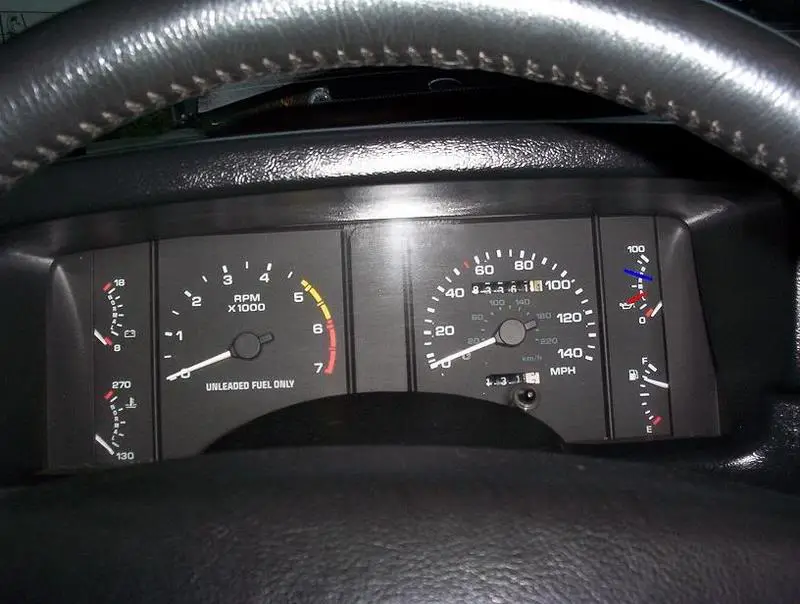

anyways i have changed my oil about 300 miles ago, used 4 qts of 10-w30 and a qt of marvel, to clean stuff out and maybe stop the ticking. BS its worse, it sounds like one of those cars where the fan blade is whacking something. its terrible.... oil pressure is a little lower also. so i was thinking of doing another oil change and going 10-w40. decisions. i really am not worried about fixing everything now, i need to set moey away for school, and then do the stang up after i get out of school.
so normally at hot idle its around where the red line is. and when im turning more than idle it builds to the blue mark. both marks are on the white line to let you know. what are those numbers? is that good or bad ?

my oil pressure is almost always at where your blue line is. it doesn't fluctuate much at all, with or without rev's. don't know what that means to u, but just thought i'd mention it. 5w-30 synthetic. i do have an new oil pump and refreshed engine though...

well thats odd that everyone elses stays at the blue line. mine goes back and forth between them...

Yup i second the idea of getting a real gauge. Also i would suggest getting a mechanical oil pressure gauge instead of electrical...this way you will ALWAYS know what the oil pressure is. The stock gauge is horrible and the stock sending unit is even worse. My car fluctuates from 25psi at hot idle to 50psi at hot cruise. When you touch the gas it builds up to 50 almost immediately....and a WOT at high rpms i think its around 60psi. Thats how it should be. I think you car is fine.
my old stock engine with 145k miles sat about midway and would move around with 10w40
now since i rebuilt it it sits where your blue line it ALL THE TIME, even during a hot summer day with 10w30
your looks fine.
but if really want and accurate reading get a nice guage, the stock ones dont tell you much.
