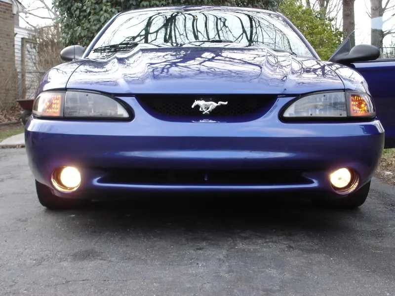

94GTHO Member Jul 21, 2005 200 0 17 Richmond, Va Feb 27, 2008 #1 Feb 27, 2008 #1 Figured it out today. Wasn't that hard at all. I'd been wanting to do it for awhile.

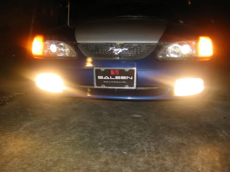

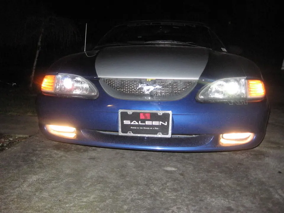

9 97speedster New Member Jan 16, 2007 134 1 0 stanwood,wa Feb 27, 2008 #8 Feb 27, 2008 #8 Here are some pics of mine done today
