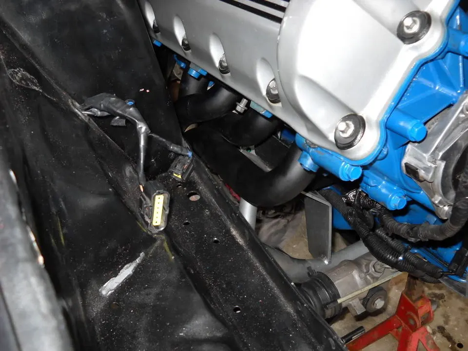

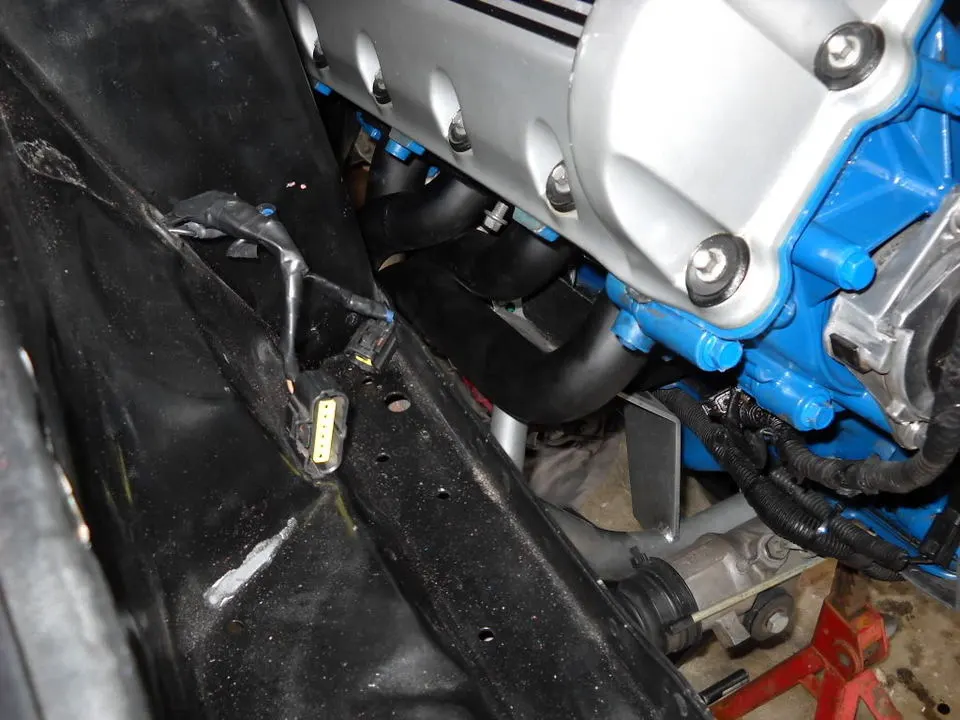

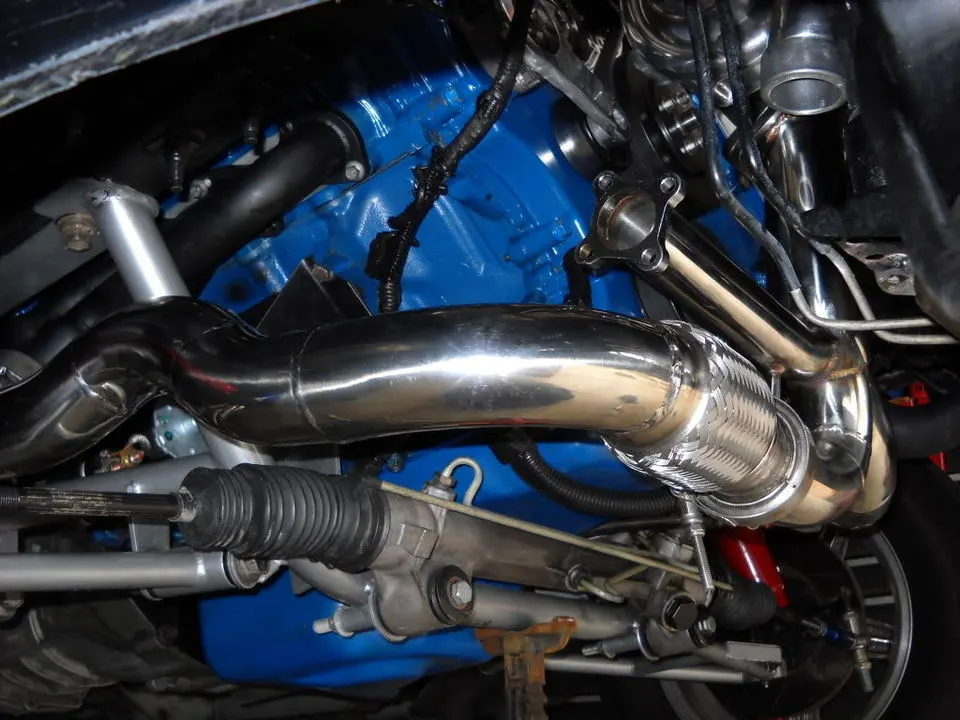

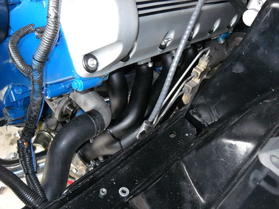

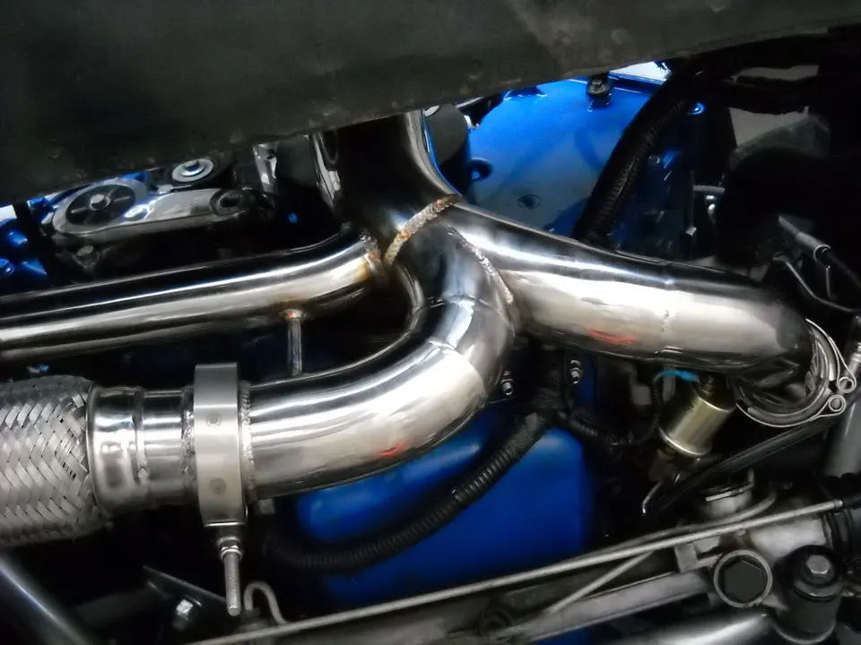

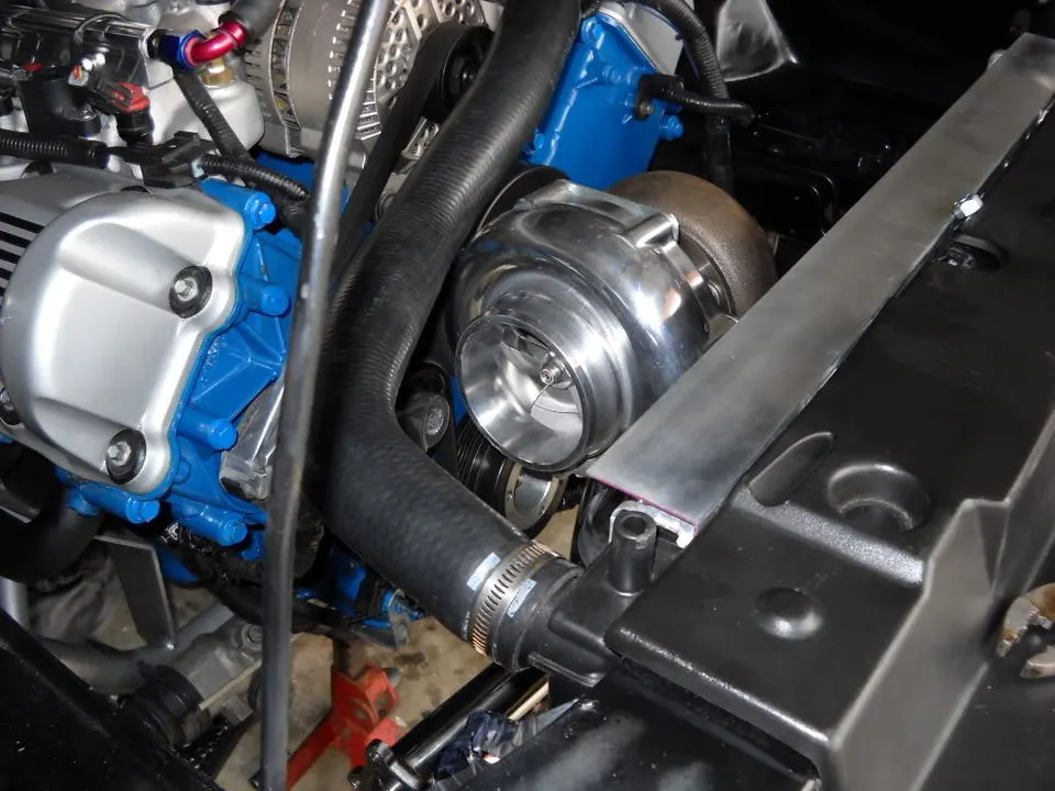

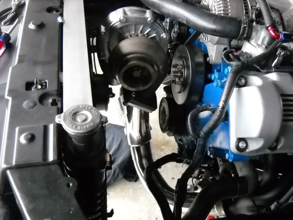

Got my FF on3performance turbo kit!

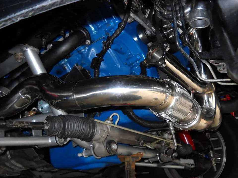

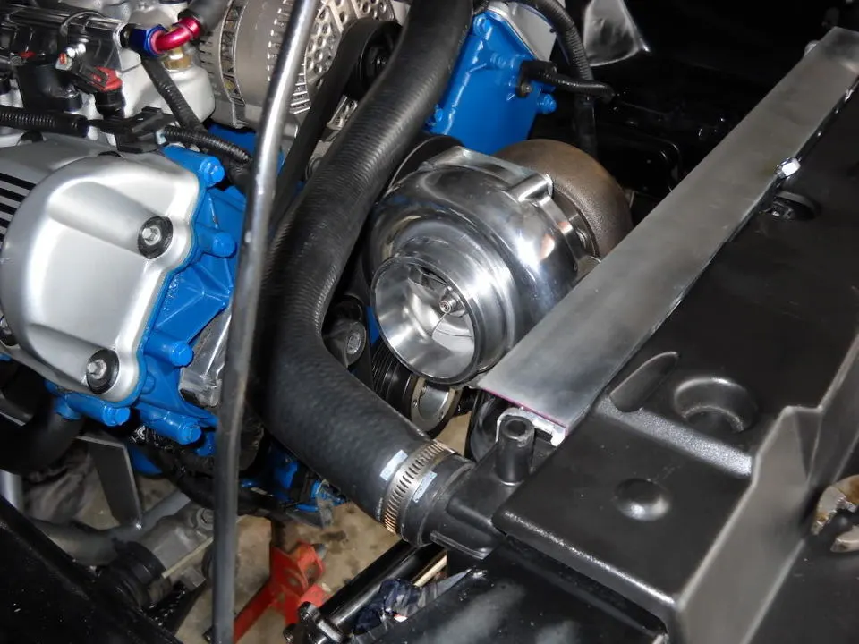

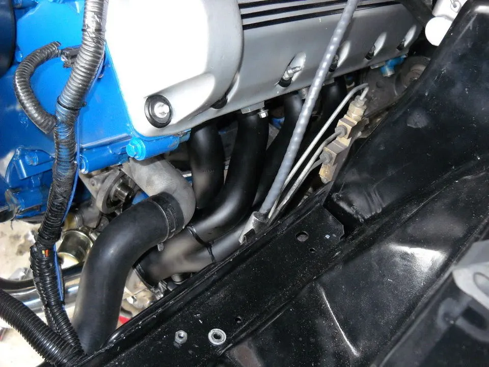

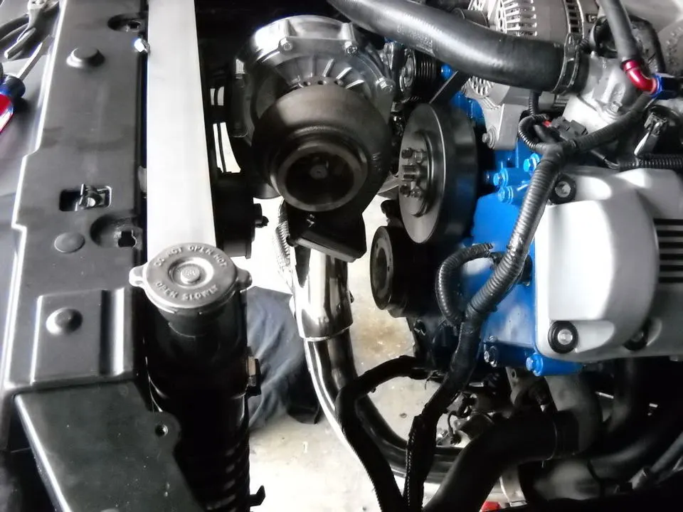

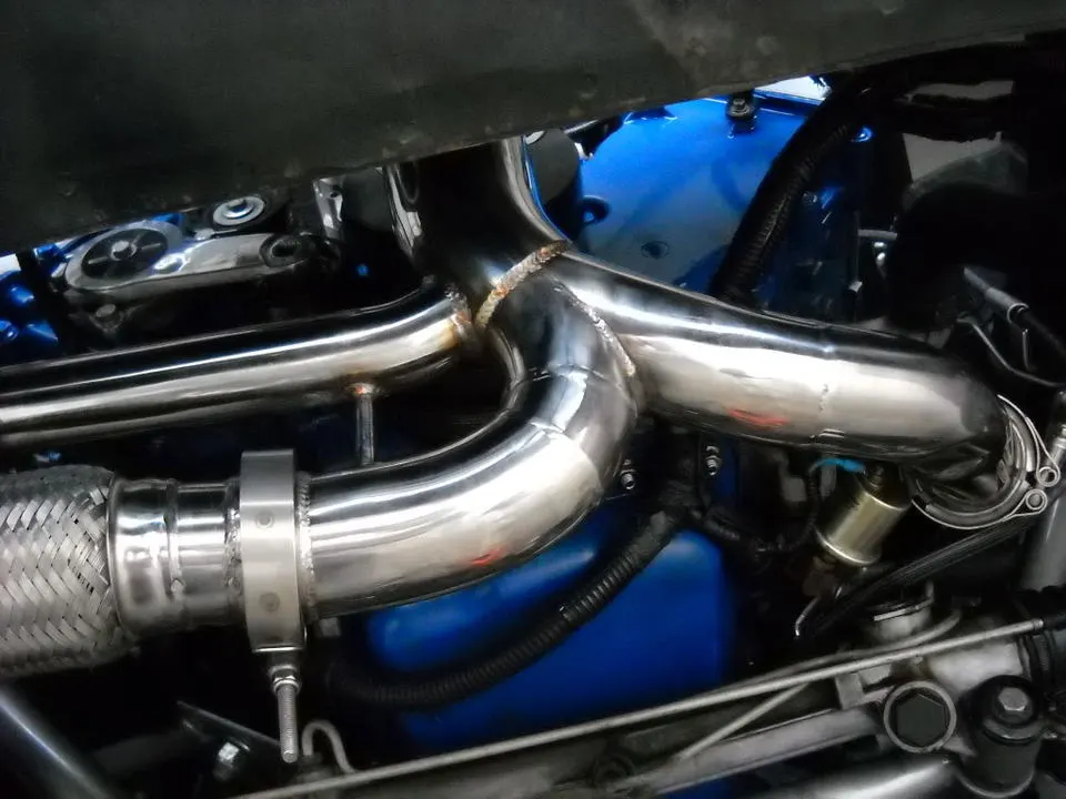

go the hot side mocked up today! it all fits GREAT!
driver side
passenger side
merge pipe

Looks awesome!
I have a 95mm pro m mass air meter if you want it..its calibrated for 42# injectors and was used on a turbo set up I had for a few months...can be reprogrammed for 80# injectors if needed...
Its been in my cabinet in the garage for about a year now so it should still be fine...I was gonna use it for this car but you and Ryan seem to be beating me to all the performance stuff lately and I still got a lot of suspension to do before I get to the turbo install on this car
Good looking setup. I have heard of a few peoples running the ON 3 kit's. It seems like everyone is having a lot more luck with the new FF kit vs the old kit's. Time to switch to an auto if you want the best times out of that car.
Not trying to be a negative Nancy, but be prepared to buy a new wastegate. That is the one thing I have saw time and time again with the On 3 kit's, is that the wastegates seem to fail often.
how much everything cost witht the chomeoly setup and everything so i can see what im up against probably going to go with the 70mm, and that looks bad ass and is coming along well
i have $2700 in the kit and the turbo, on3 does not deal with master power anymore so i ordered it separately.
yea the new FF kits are mile's better quality and fitment then the old kits, honestly i dont think the fitment could get any better! and all the pipes look good and are thick! so will see how it holds up! and ive throw around the idea of going to a 4R70 with a manual valve body, stall, shifter ect, :hide:
ive already been thinking about the waste gate, thats not a big deal to me tho.

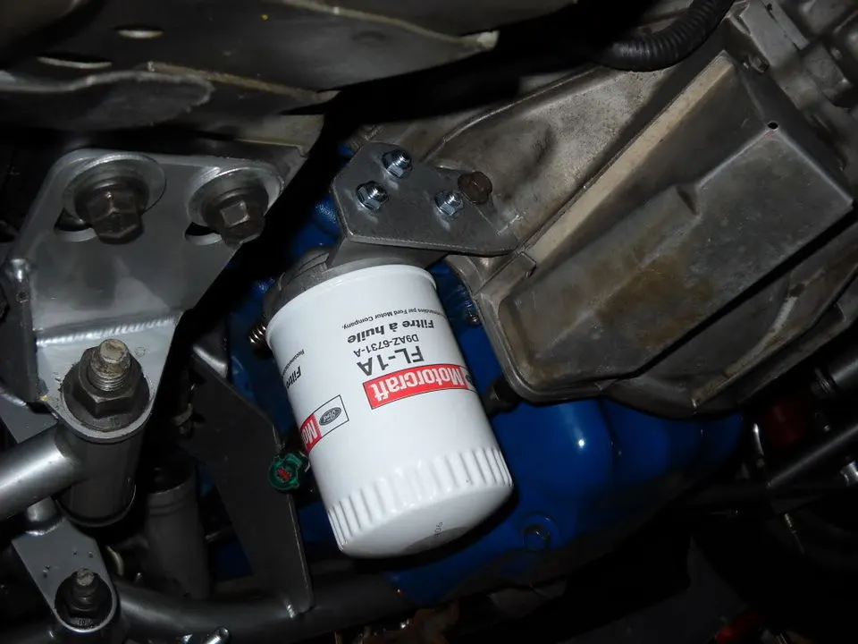

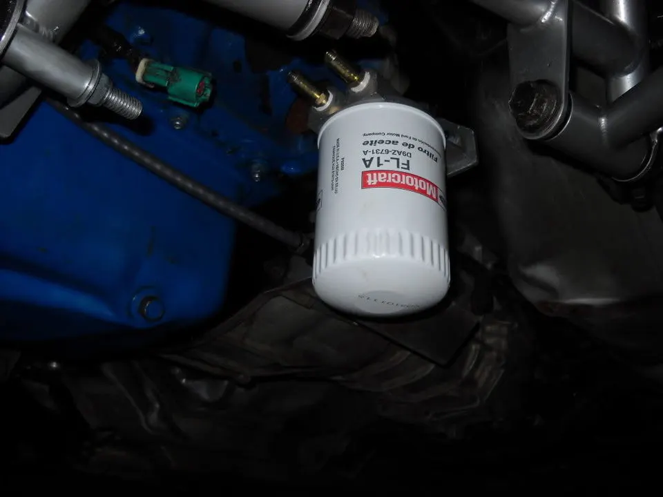

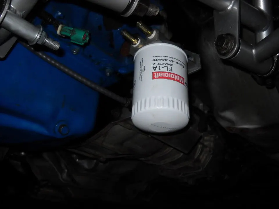

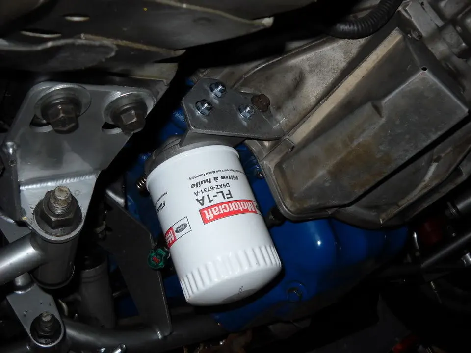

Now you have a cluttered engine bay :stick:. That car is going to fly through the traps, very nice job on the oil filter relocation, super clean looking. I wish I had your skills.

haha thanks! i hate clutter! yea im hoping it traps good considering it went 115 on motor, and i should be adding 200ish rwhp, shooting for 525rwhp :nice:
