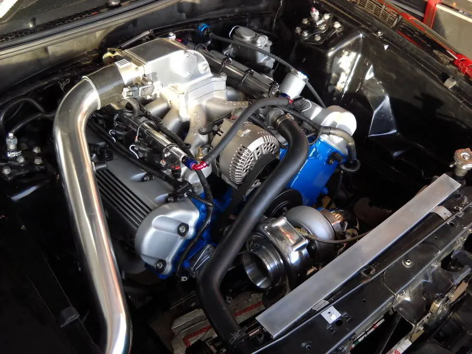

here you go! 99% done and ive put about 15 miles on it so far:D

nice man u get it tuned yet and when i get mine done it would be ok to drive untuned to get it tuned right? and you need to post up some videos of how it sounds and some 2nd gear pulls
no its not tuned yet, so ive just been driving it with the cold air intake still on it, lol i still need to finish the whole fuel system, sumped tank, A1000 pump, -10 feed, -8 return and 80 lb injectors, and a HPX MAF
and did u get the headers coated they arent black anymore
i just used VHT header paint for now, the stuff works pretty well! lasted for 3 years on my LT's, i will be getting the headers and turbo hot side coated in a few months, just didnt do it right away with all the money i spent on the kit, best price i found was $325 for the coating
