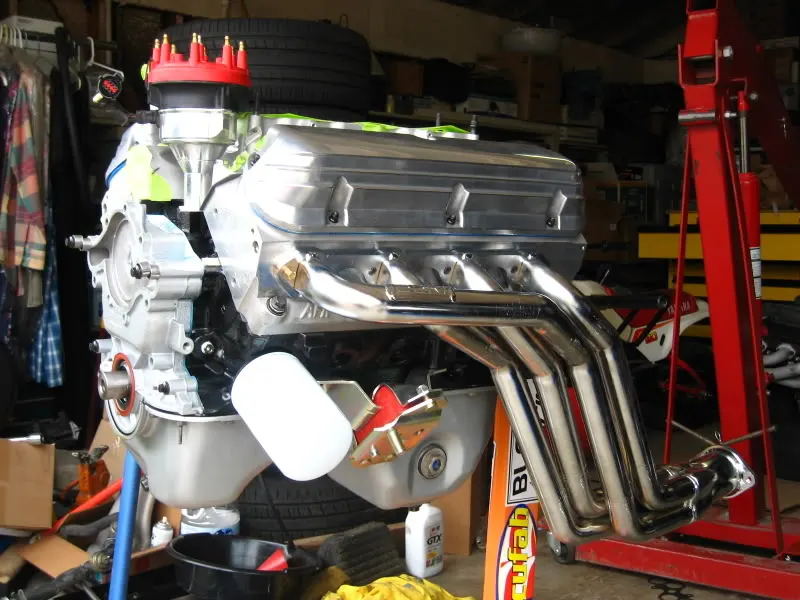

Got some BBK Longtubes...*PICS*

FTW and cali smog too :D why waste horsepower on a 331/AFR 185 combo.
WOW, that there is what I call a motor! Are you leaving the headers in the engine bay then dropping the motor in? Just a quick little tip to ease install, if you drop the motor in that is: Do the diverside from underneath the car, and drop the passenger side in from the engine bay. Just make sure the engine is about 1-2" off the motor mounts and they will slip right in.
Yeah im going to lay the passenger header on the strut tower and slide the drivers side from underneath just before i set the motor:nice:
