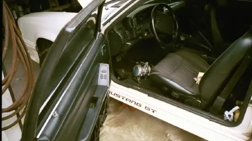

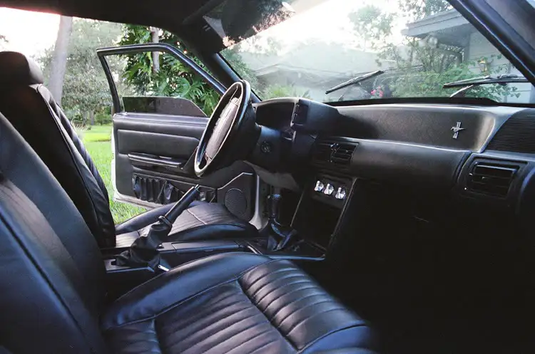

For the seats trust me, they can be fixed, have a shop weld them back up like jrichker said, for 25 bucks you can fix it, and have someone recover them, thats exactly what i did with my seats, fixed them and recovered them with vynal, its been more then a year and their perfect.
heres some pics
before:
Here they look sturdy and strong, and like i said before the stock seats can be comfortable and provide support.
After:
Now if you want those seats by all means go for it, but i personally think when your on a budget, a pair of $800 seats is just ridiculous when you could use 500 of that for other things to fix your car.
