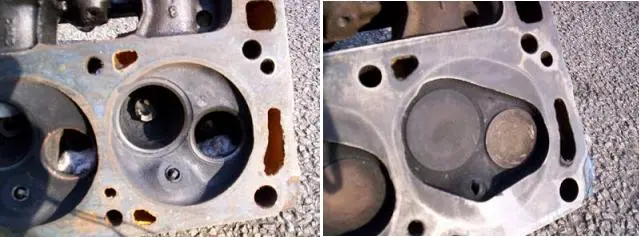

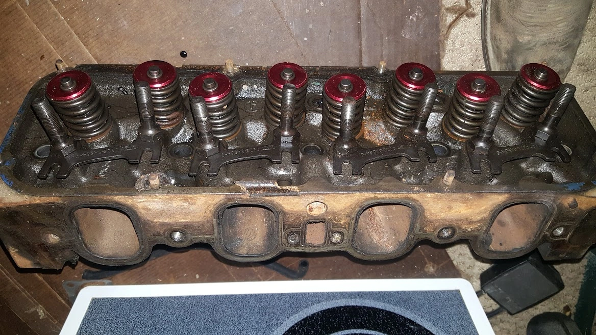

hey, thanks, for all the advice. I've never even considered switching to a roller cam. if i didn't switch to that and used flat tappet hydraulic, do you think i could achieve the same power or close? also, how can i tell if the heads are closed chambered? they have the upgrade springs and the screw-in studs.

i do have the closed chamber heads.
