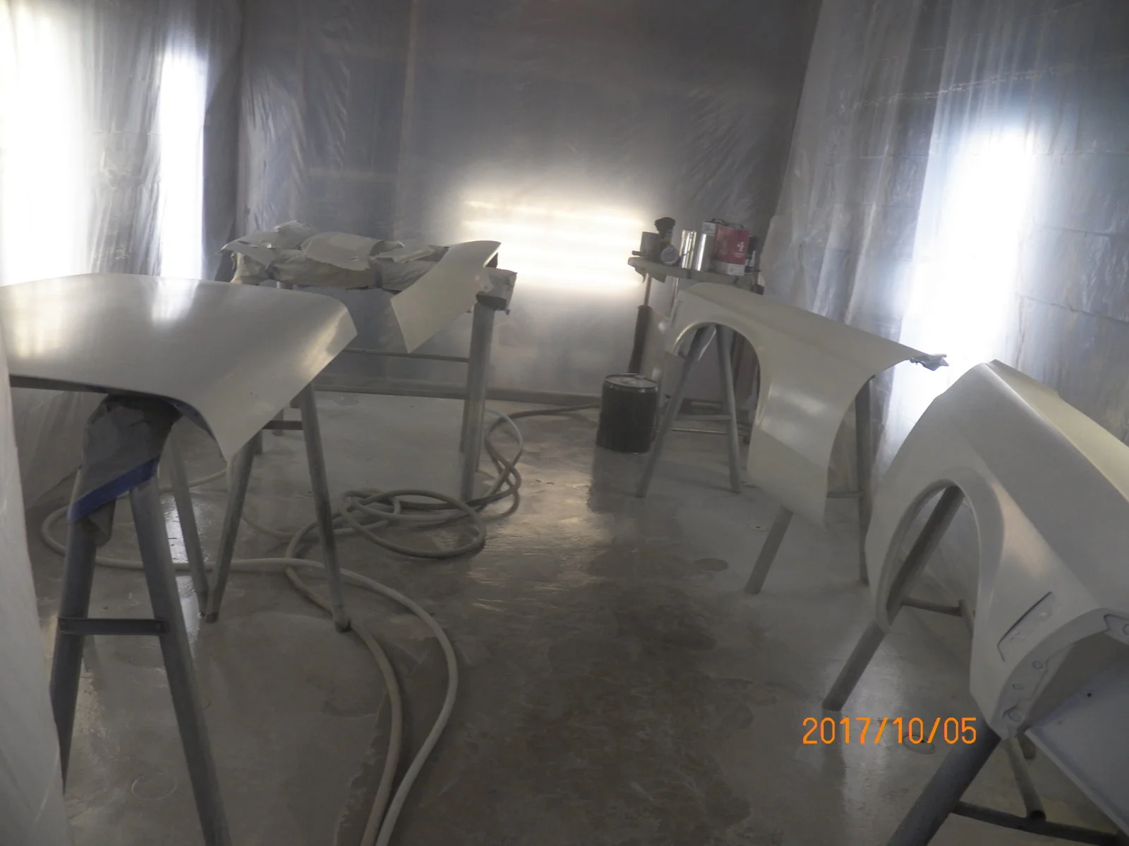

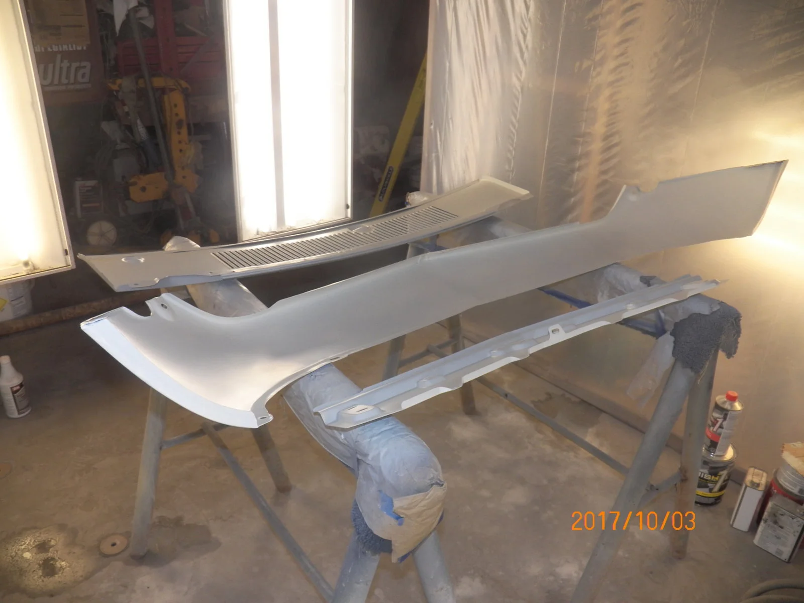

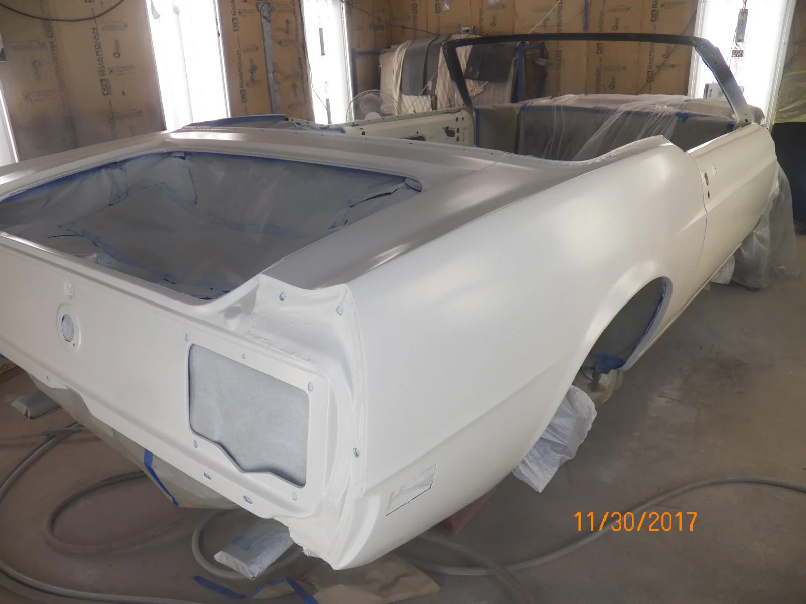

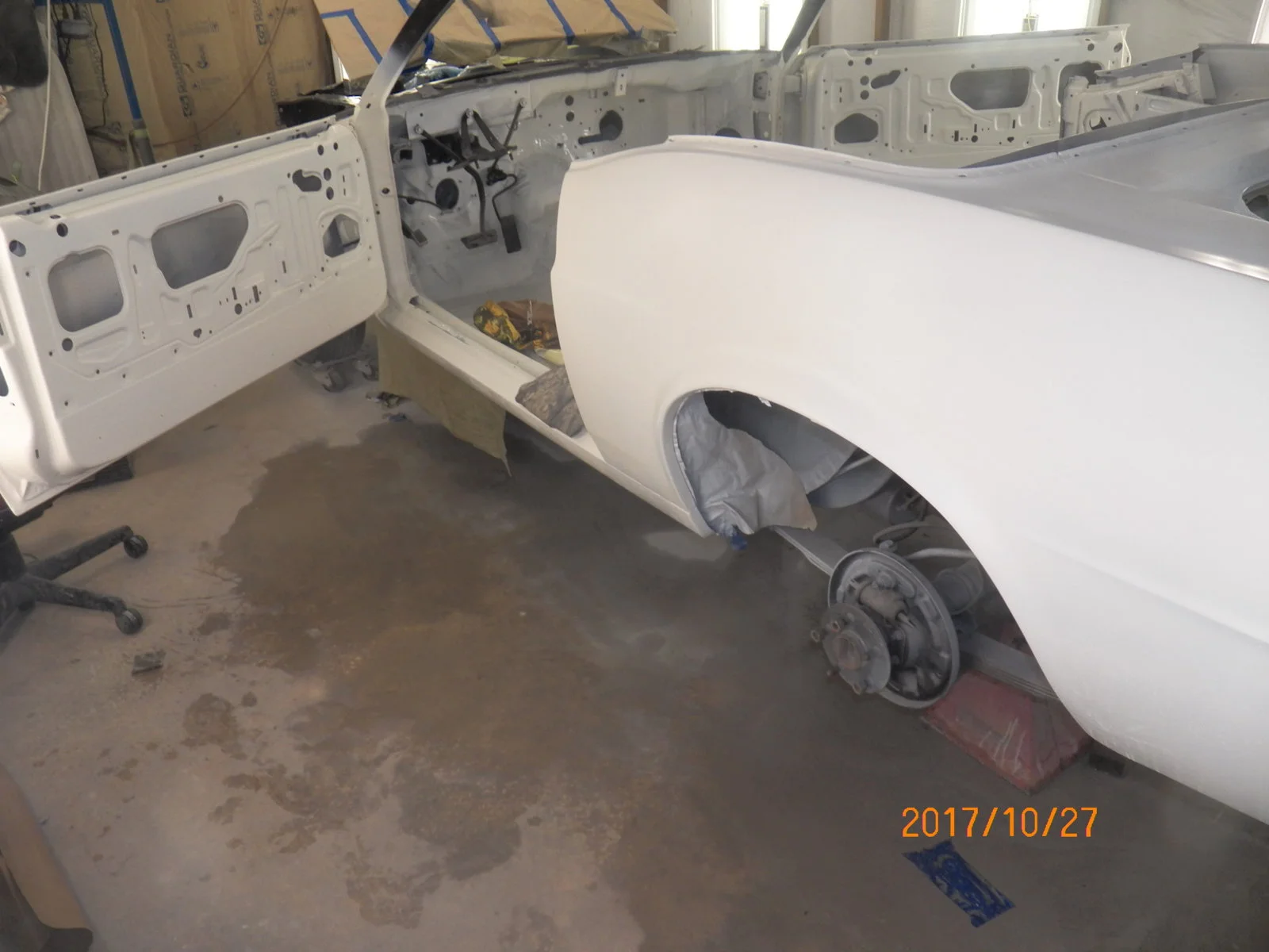

Metal Shop/Pulling area has temporarily been set up as the "secondary" paint booth

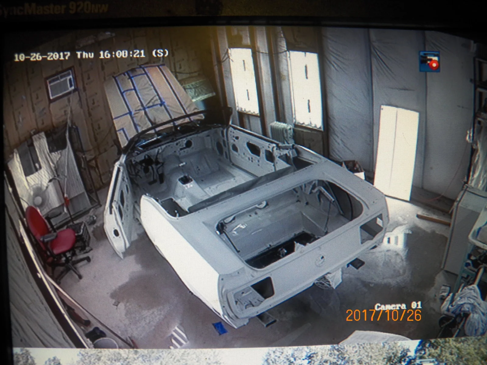

Pic a little grainy. Picture taken of the Security System screen.

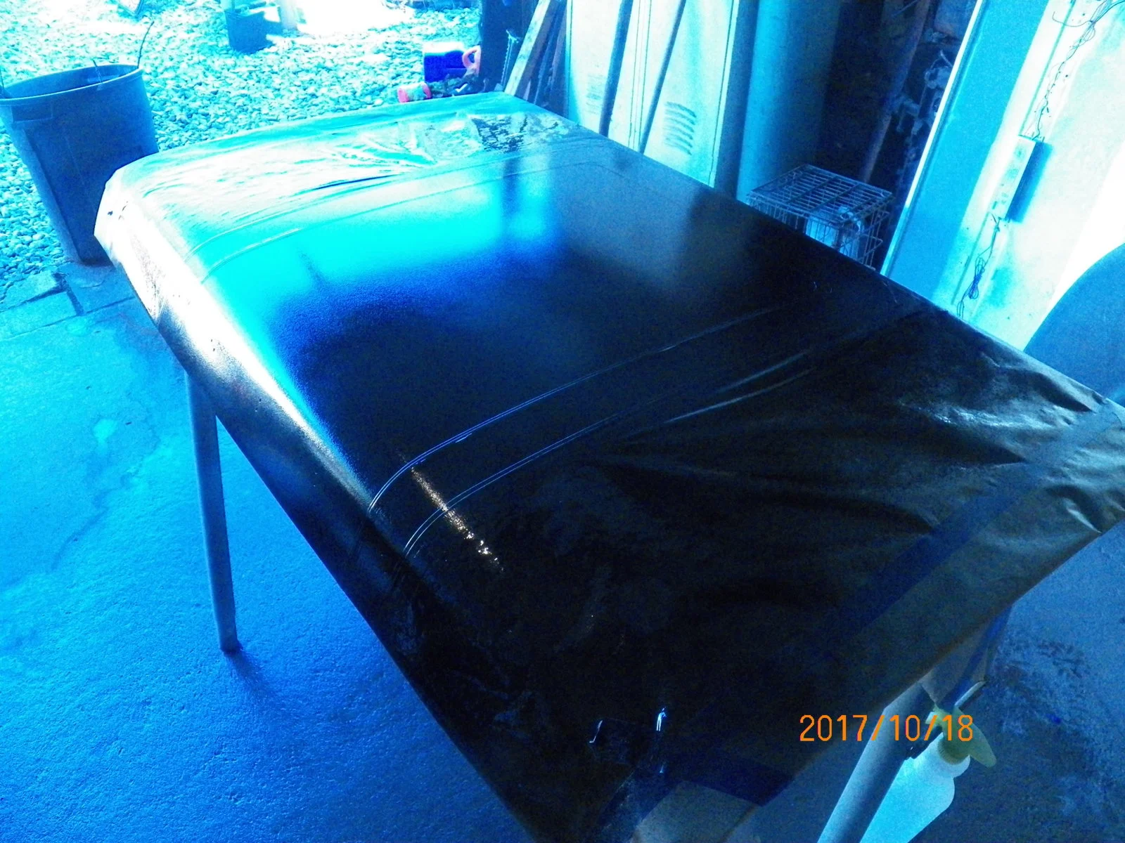

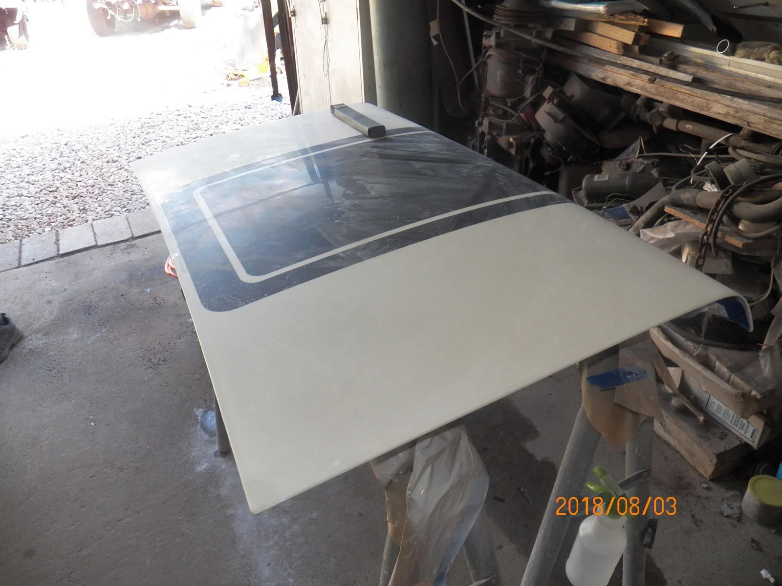

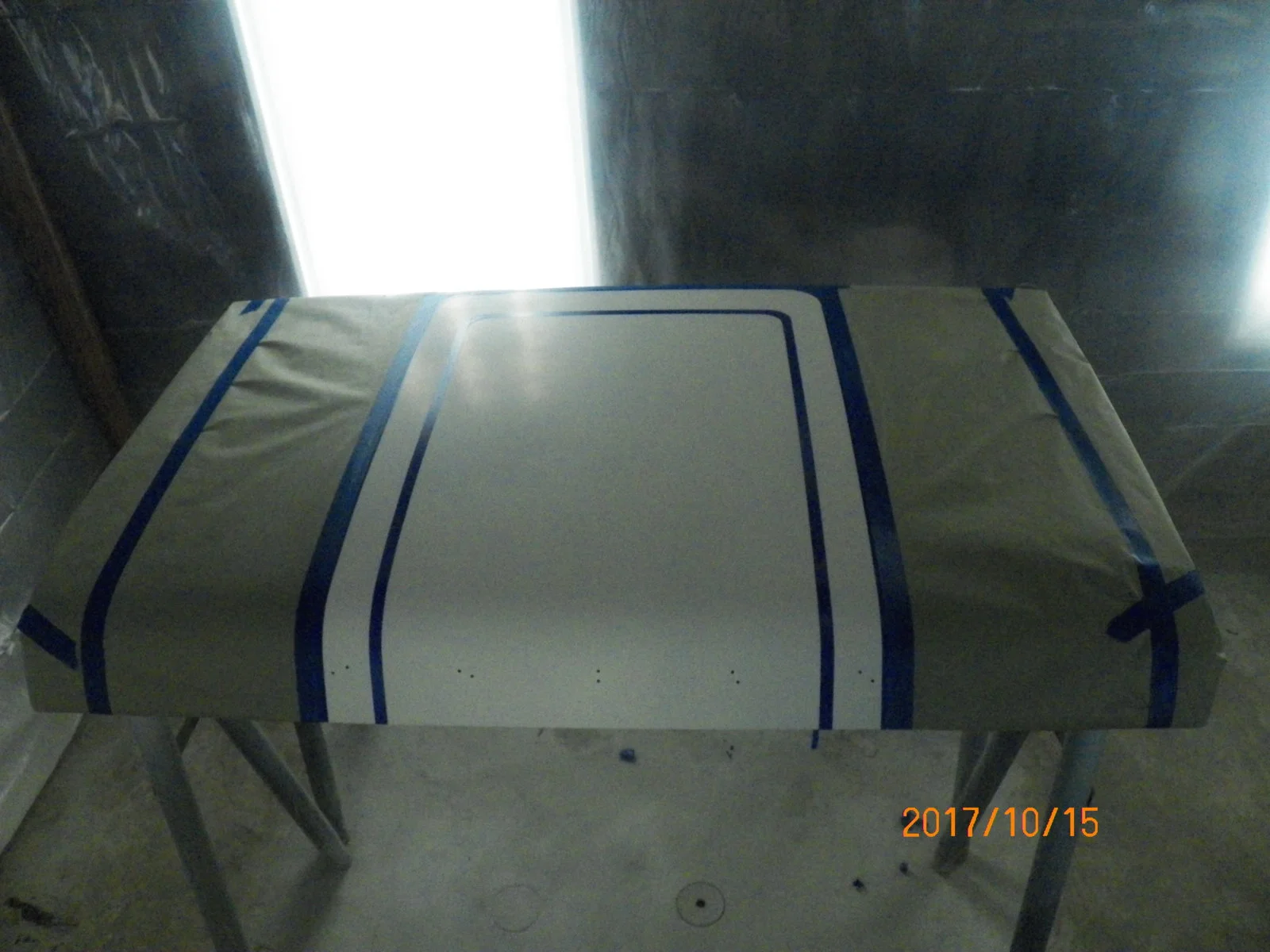

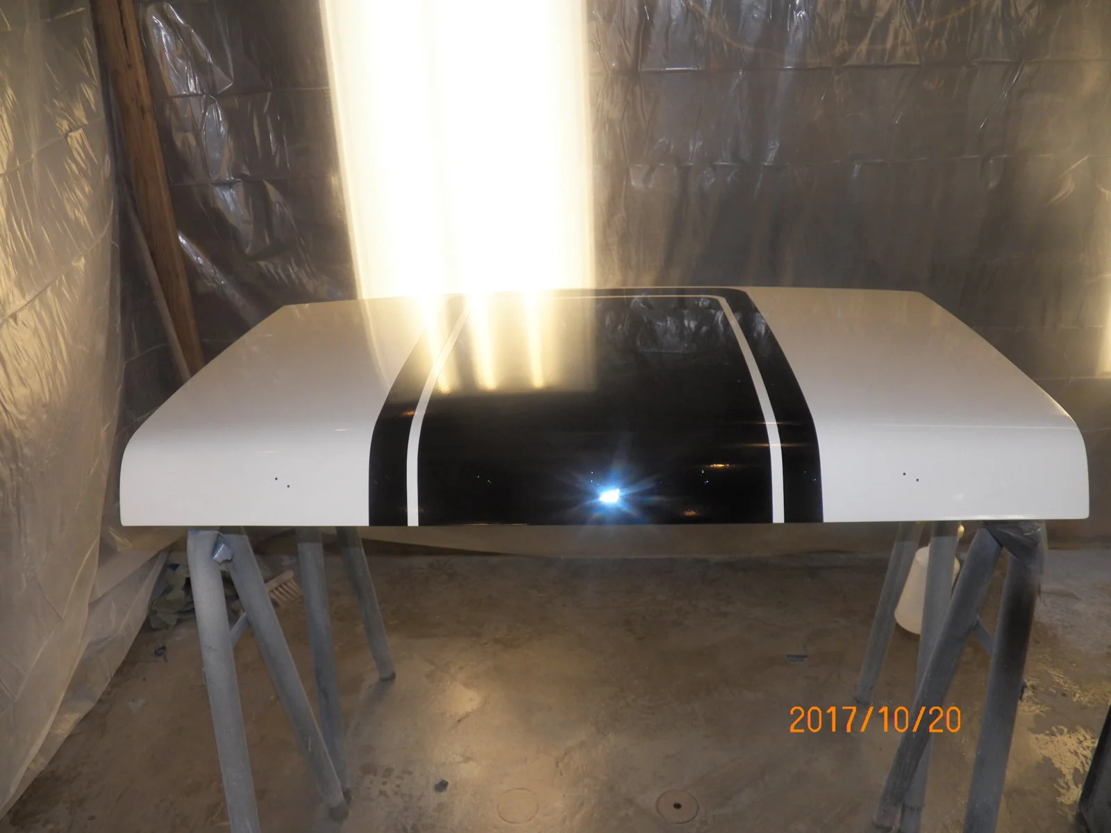

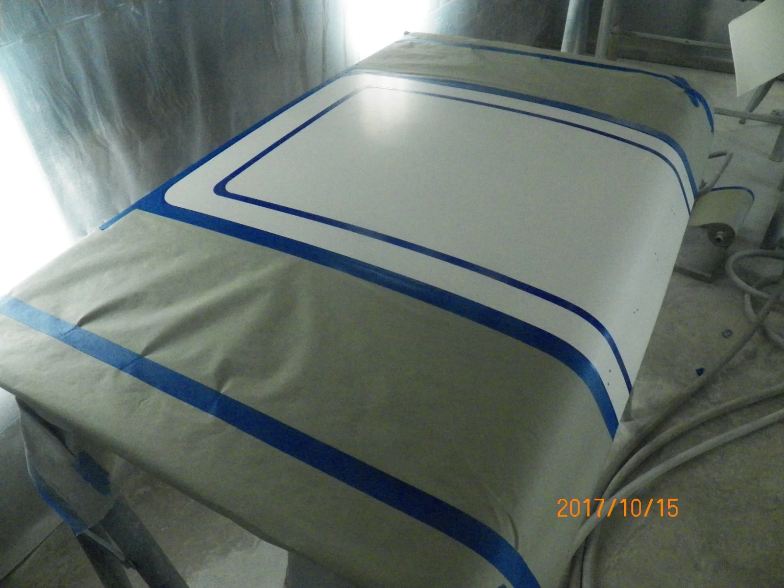

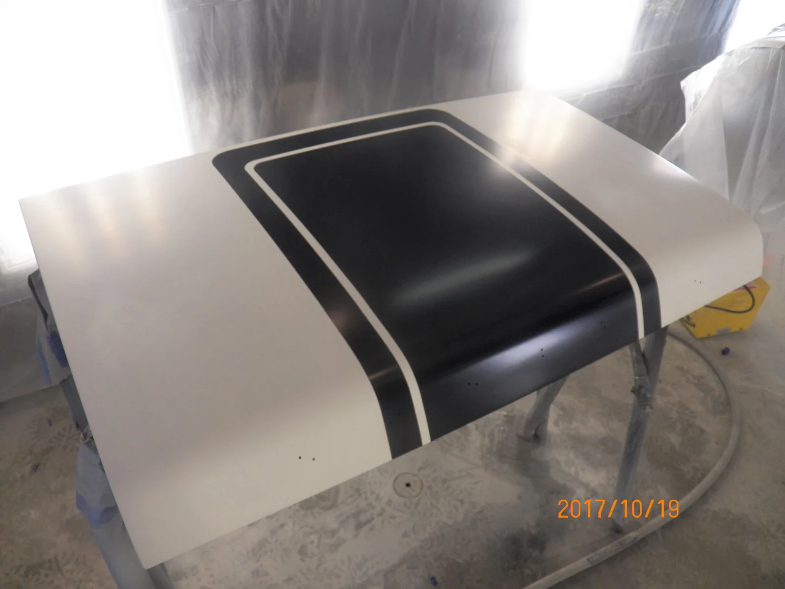

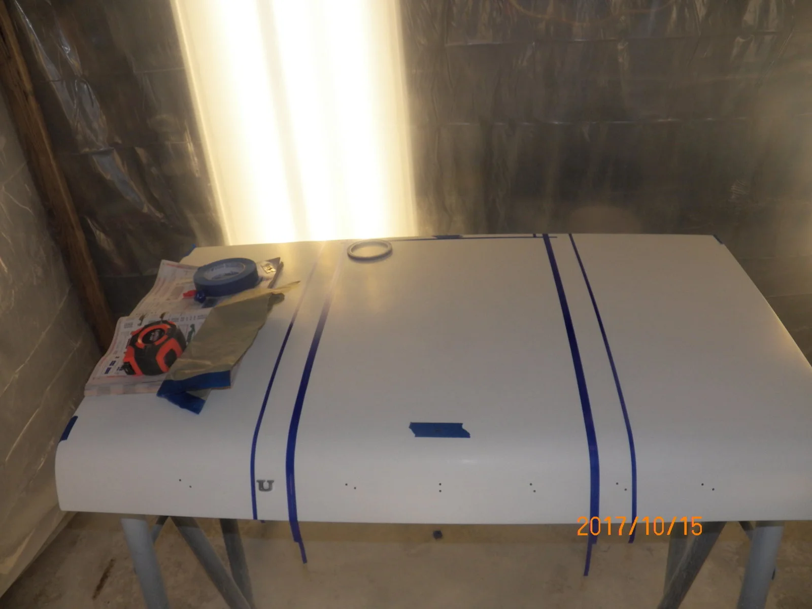

Shsss...Don't tell the customer that we put stripes on his trunk lid too! He will either have a coronary event or wet himself.This should convince him to get the sequential LED Tail Lamps.

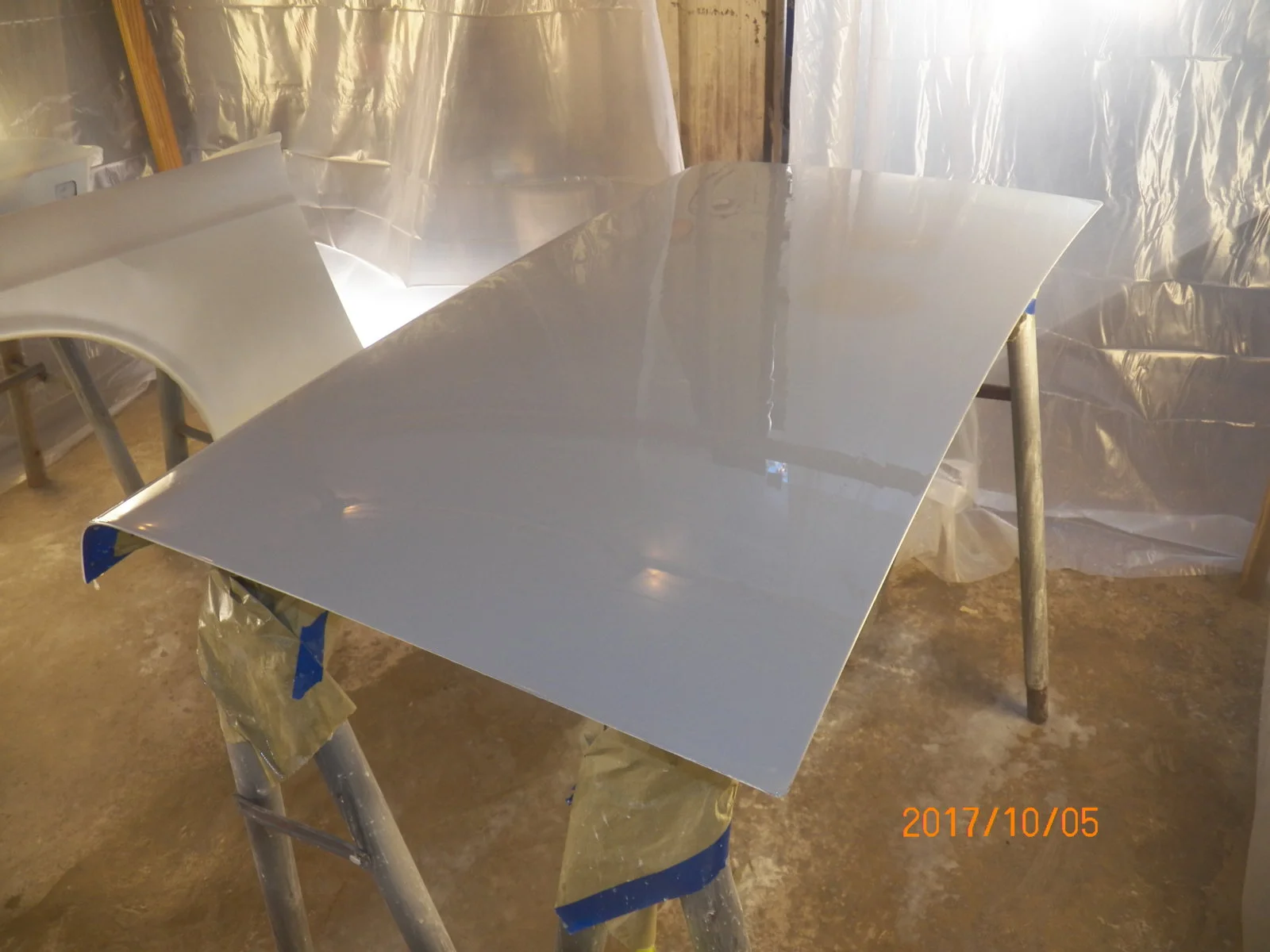

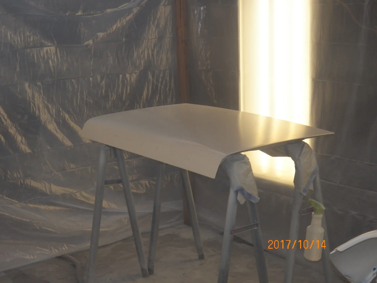

We are having to use two "Paint Areas" to do this project. It's just too many pieces for one booth and sometimes have "sprayed" in a 3rd spot too.

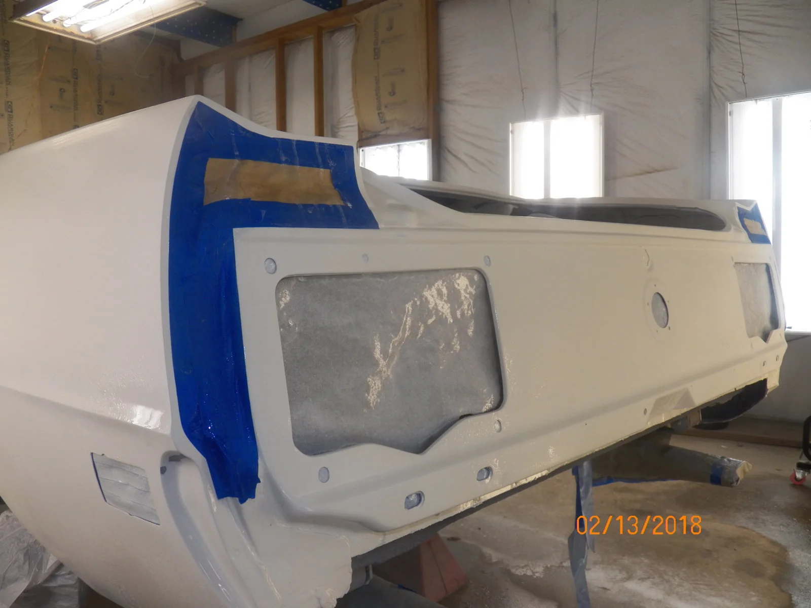

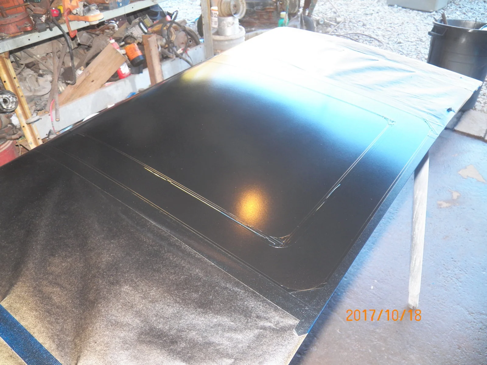

Tail light panel is gonna look good blacked out with semi-gloss vinyl. We don't want to use paint because of gas nozzle scratching and weathering. Vinyl can be replaced with about 2 hours of work vs. How long to re-paint? Oh yeah, powder coated semi-gloss or matt finish tail lamp bezels. (No pic yet)

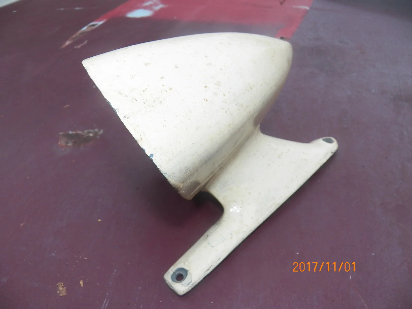

Mirror "before picture"

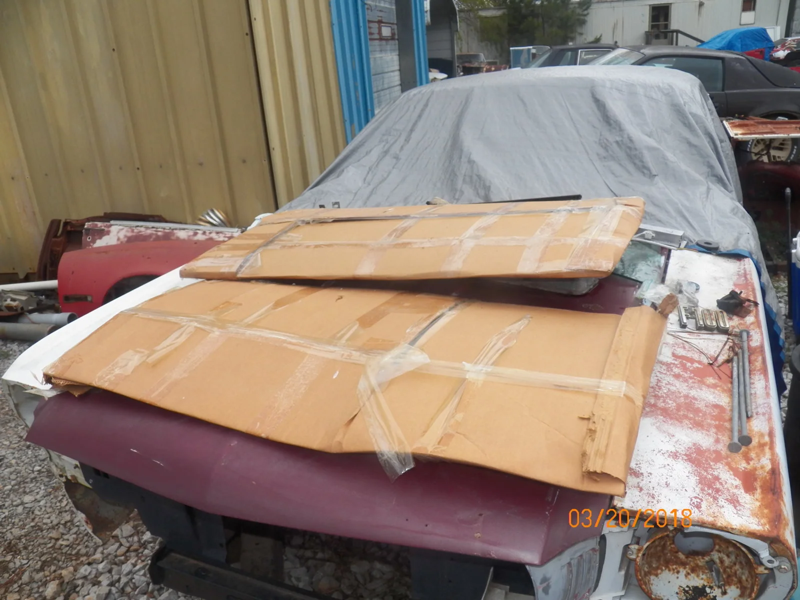

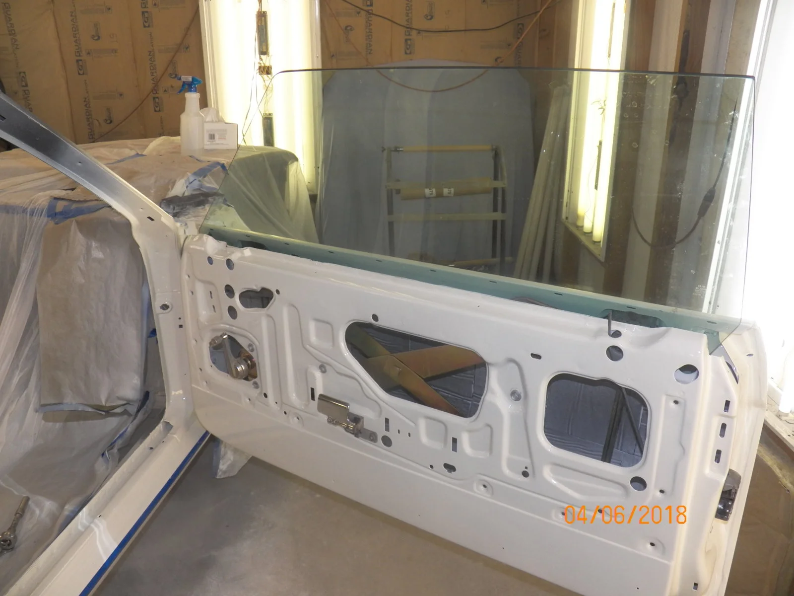

Unique to 1970 door glass has been safely stored away each packaged individually in a double layer of cardboard

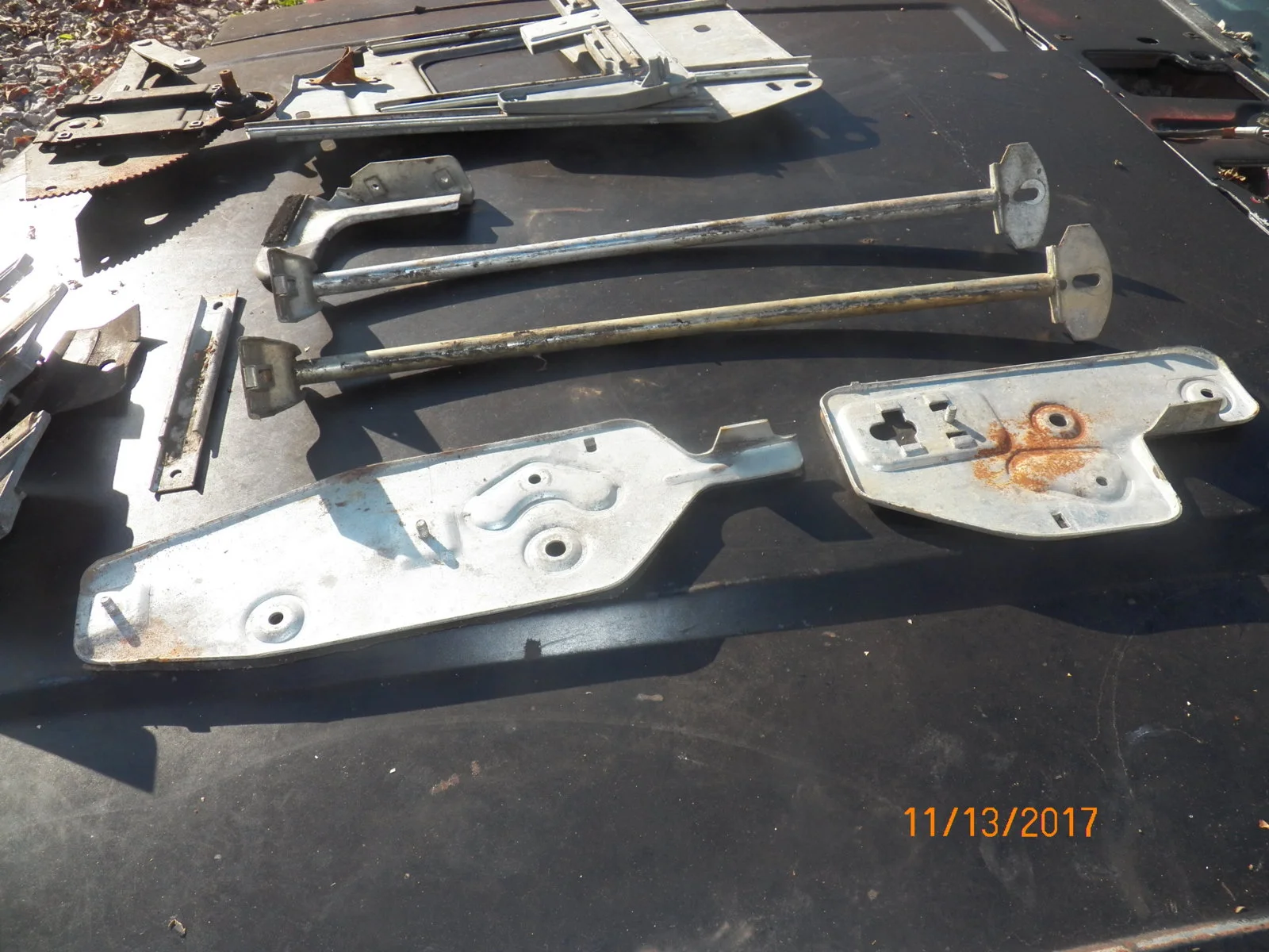

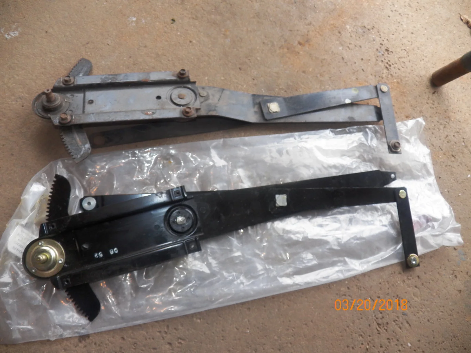

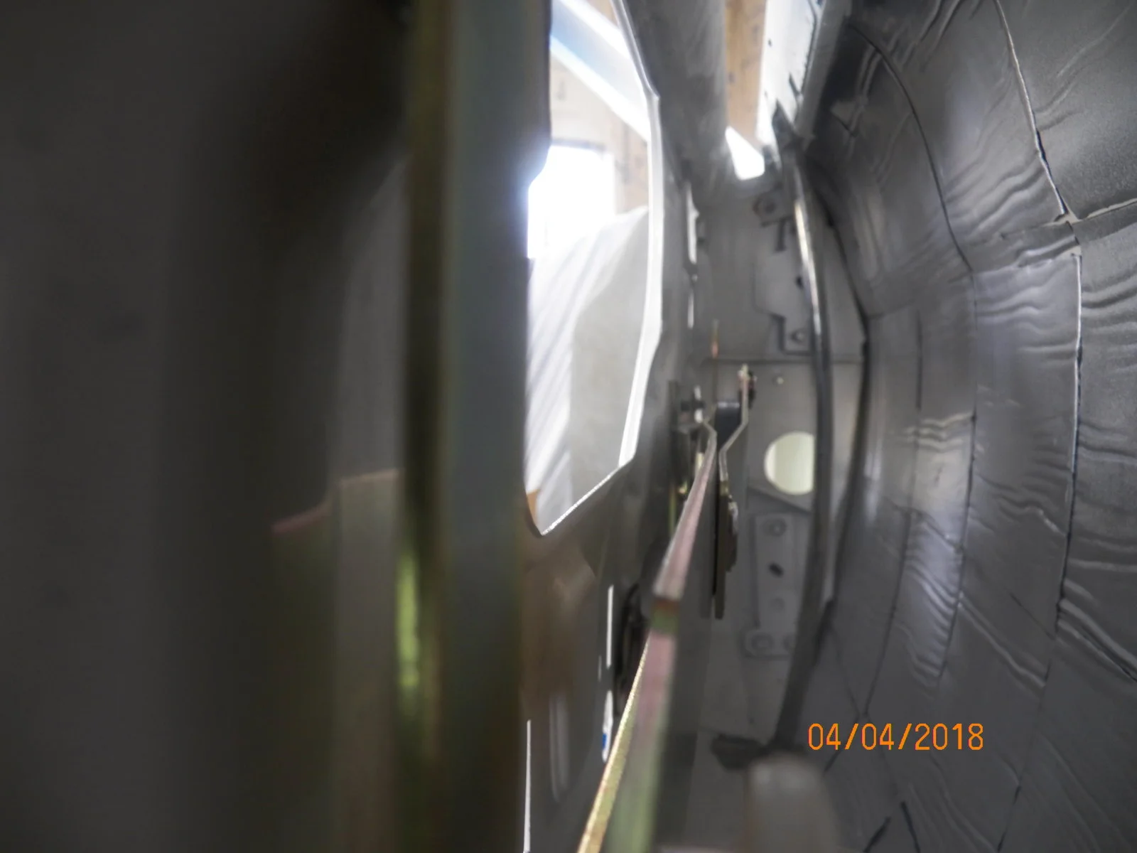

RH regulator was quite bent/twisted and the gear teeth didn't look and feel well either

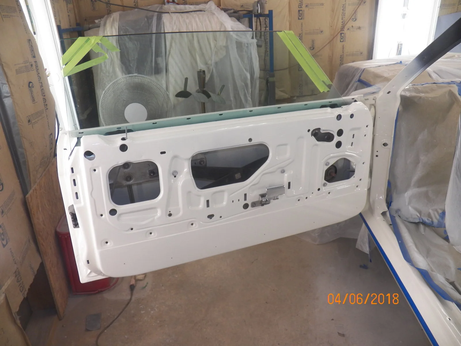

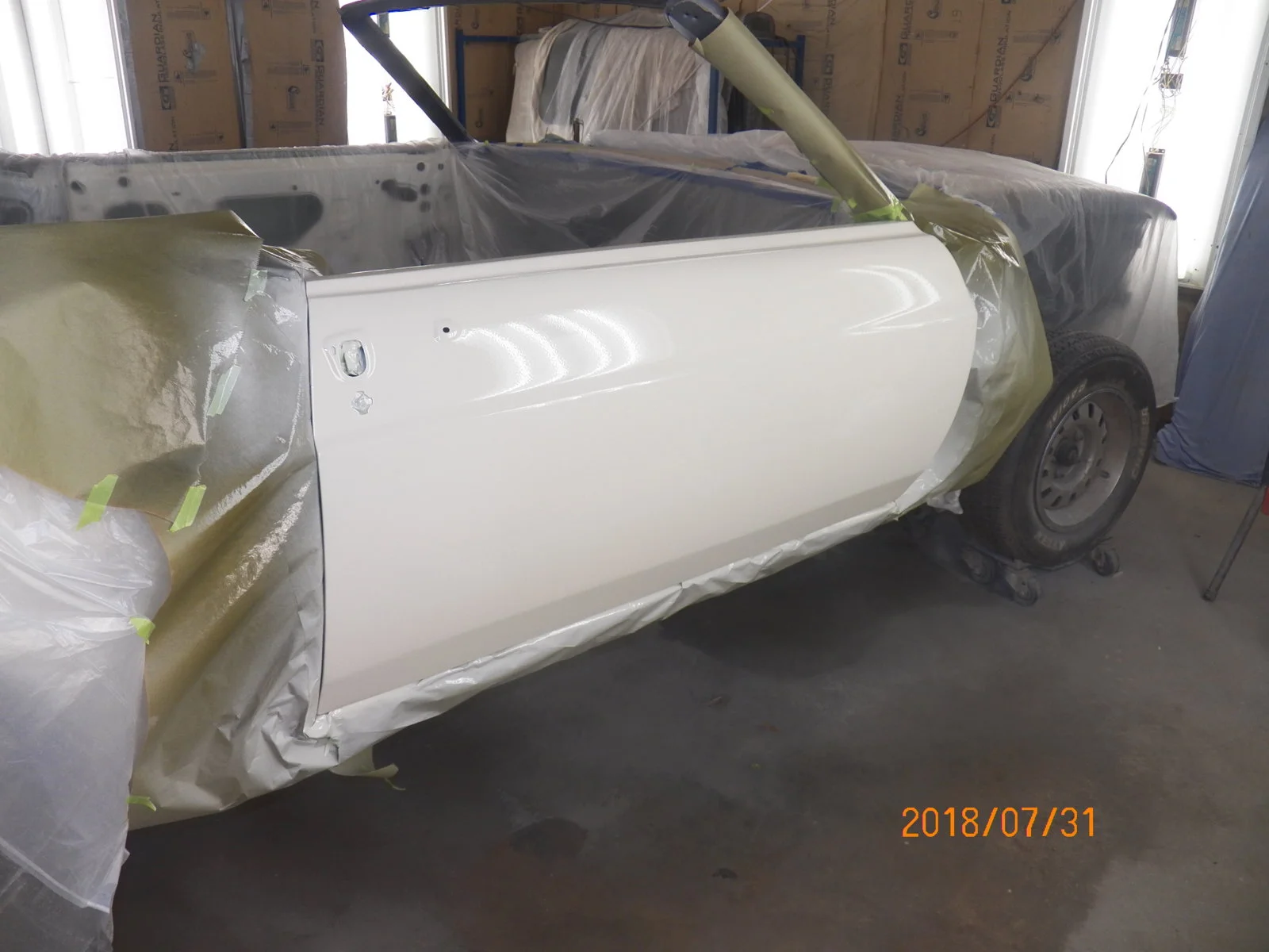

As much as possible has been assembled before the final paint process

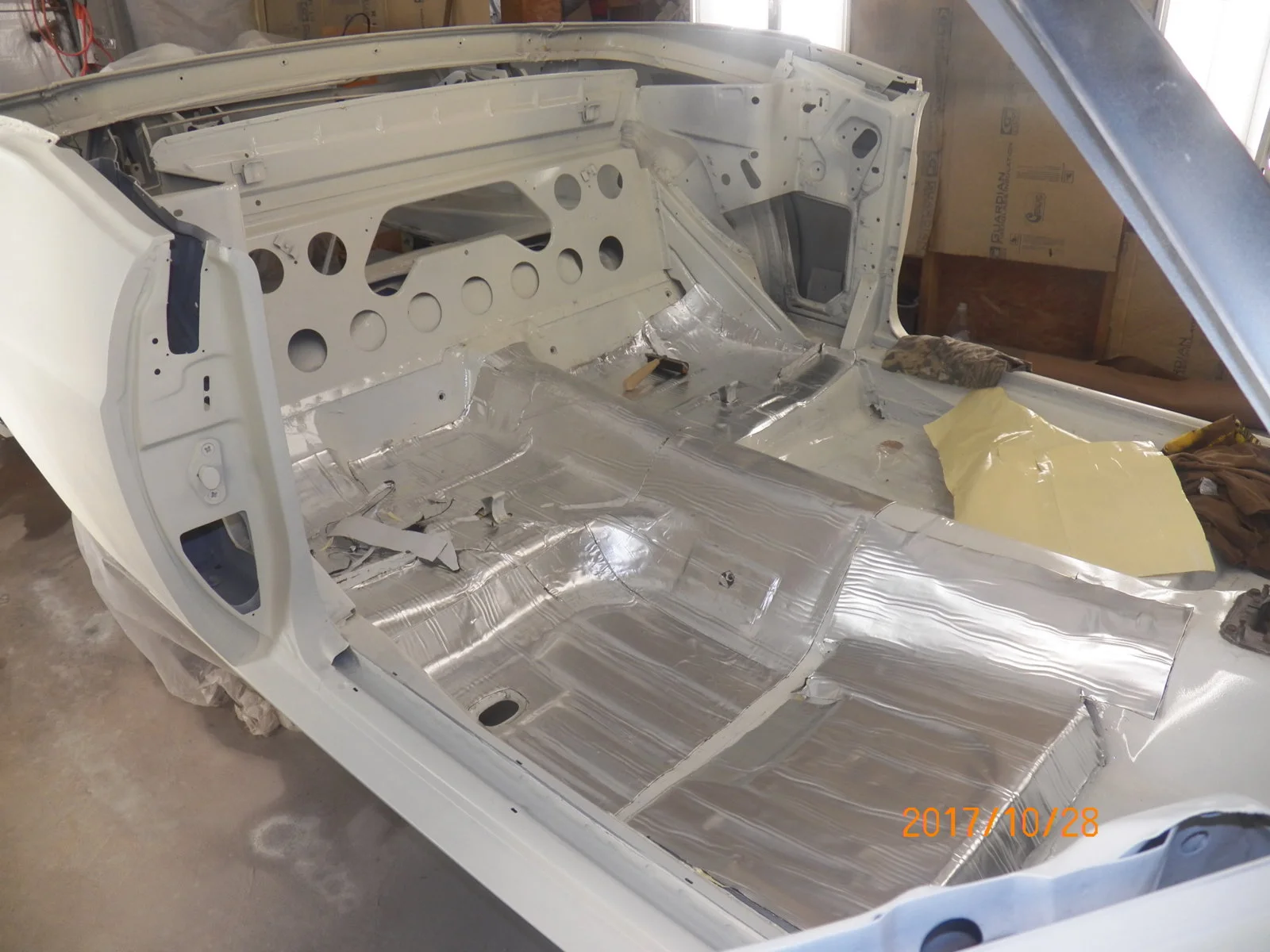

Sound deadener inside RH door that has a new skin on it

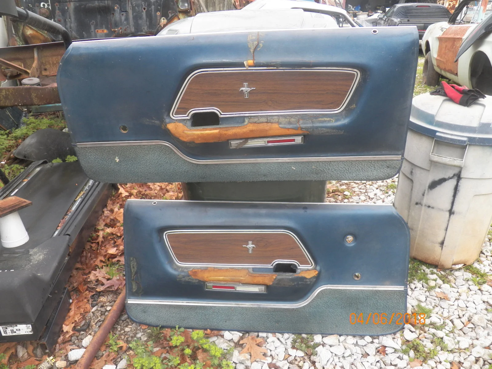

Deluxe interior door panels. Was blue.Going to use '69 Shelby Dark Red (looks Crimson to me)

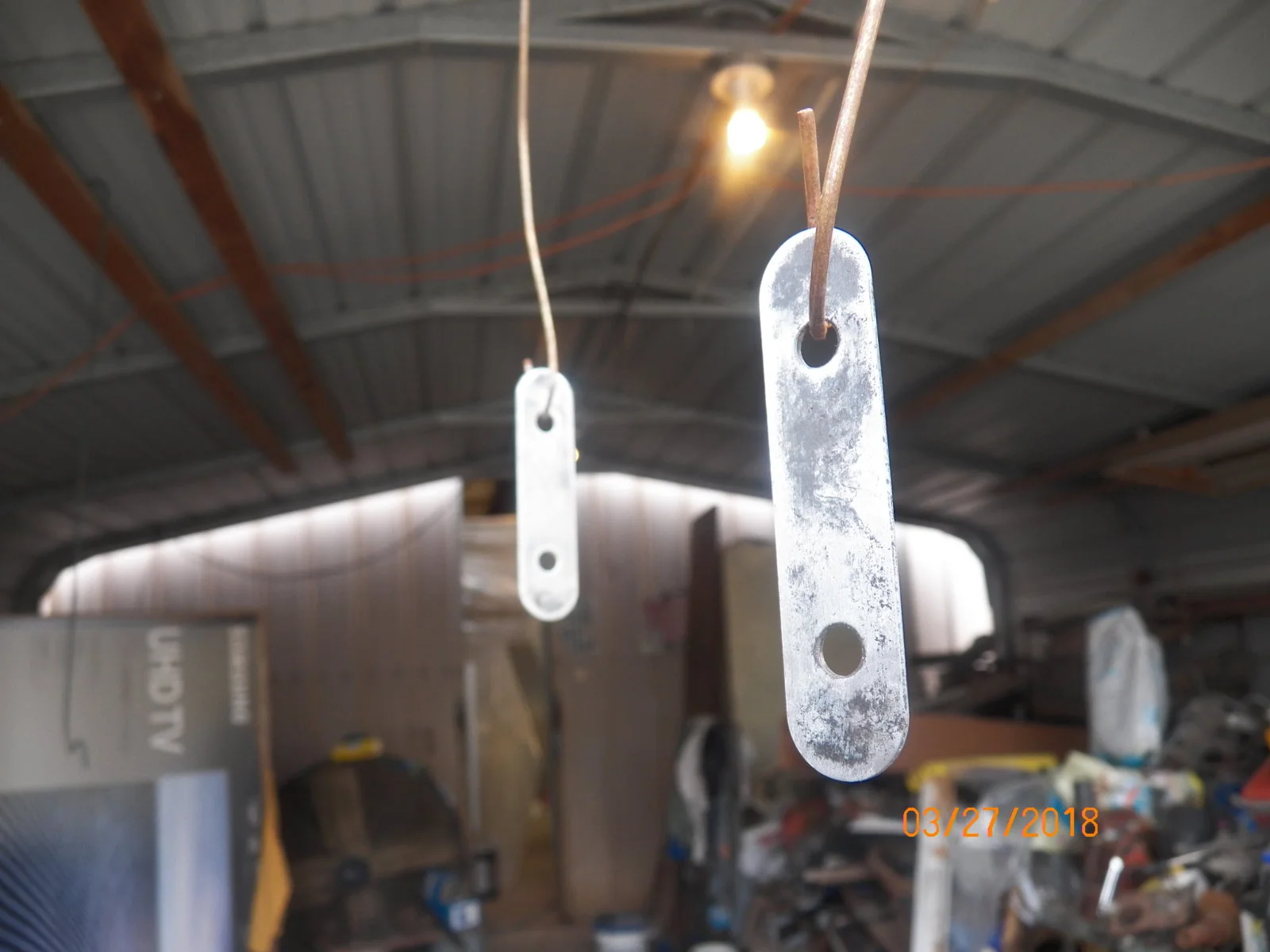

Tag bracket" nipples deleted. (Thinking "It sure would be nice to fill in the gap (for the front LP clearance) in the front bumper and have it re-plated")

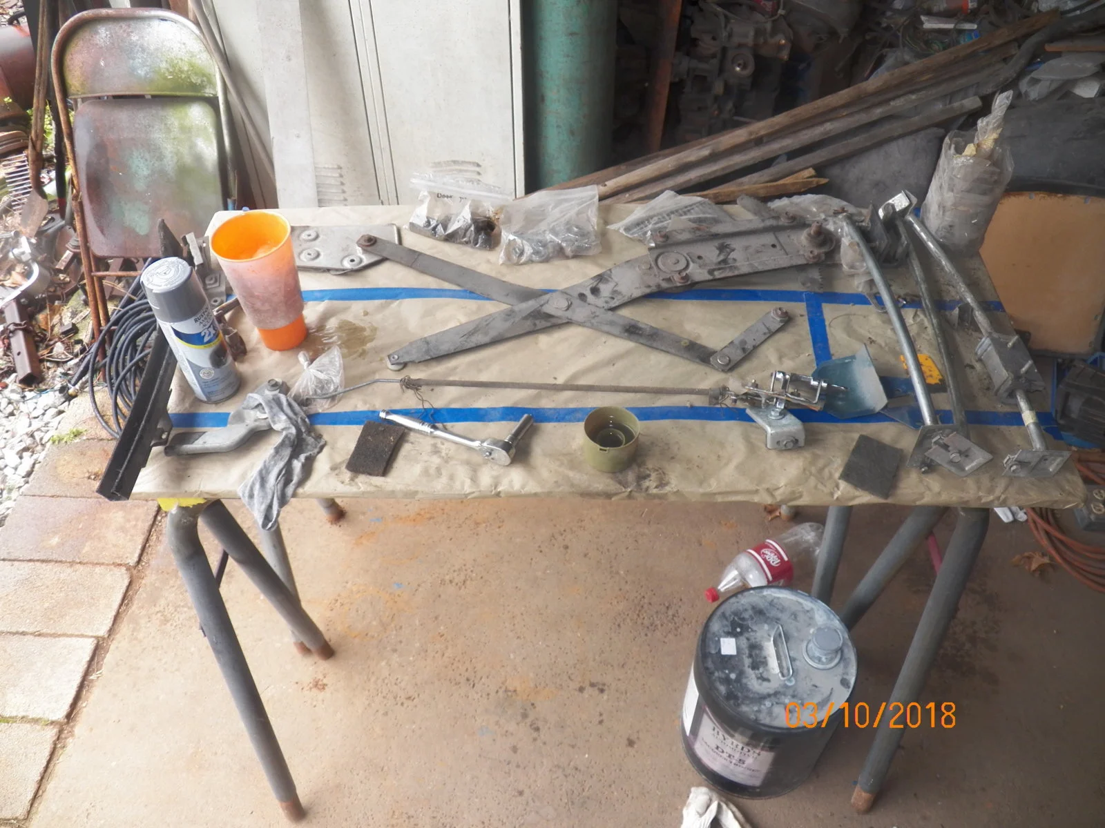

sorting before cleaning

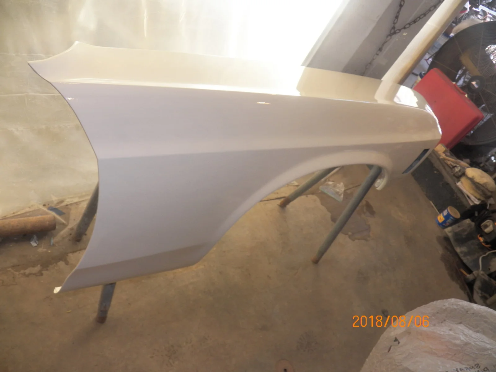

Wimbledon White

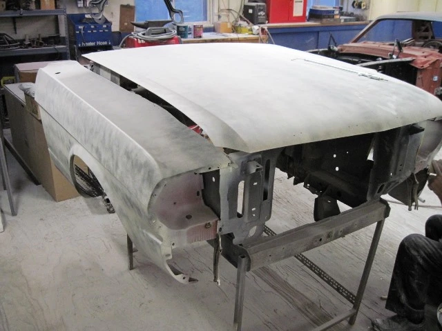

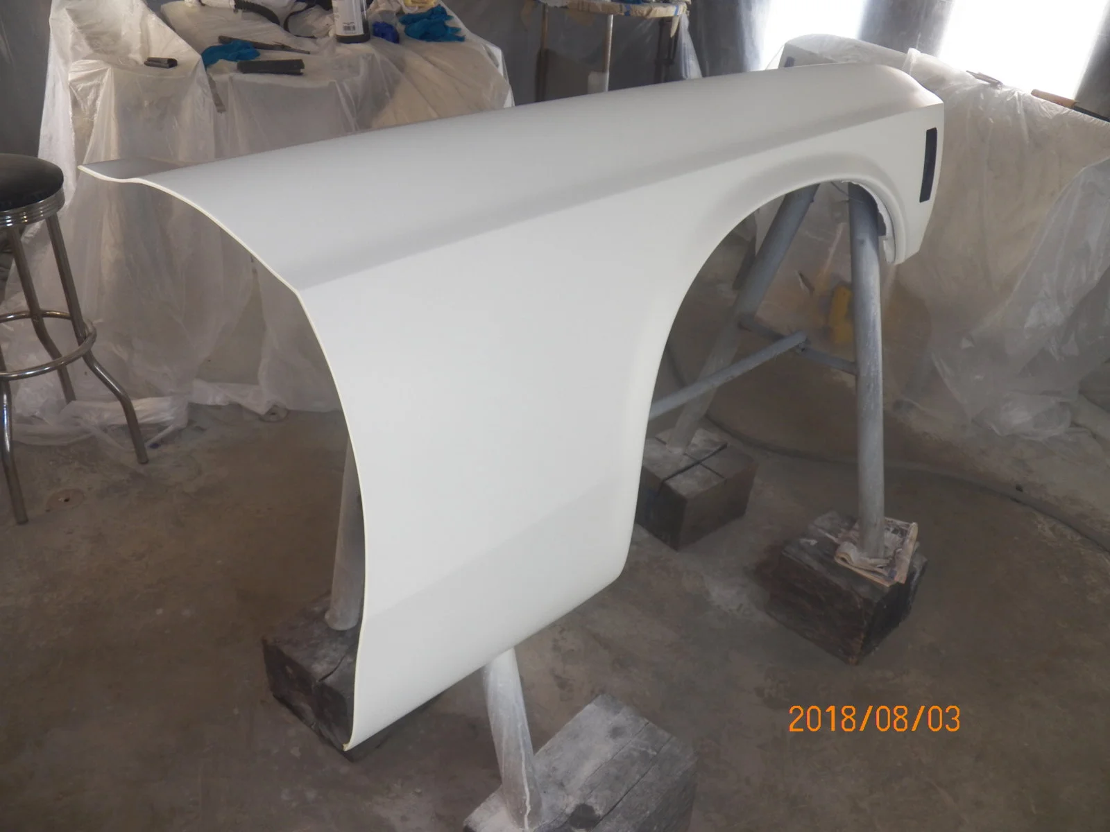

Realmongo. Looks like you are pretty far along if you are working with tracer coats. I like the 69-70 front third "work stand". Surprised the early fender will attach to it.
