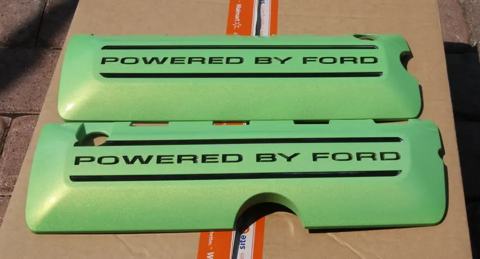

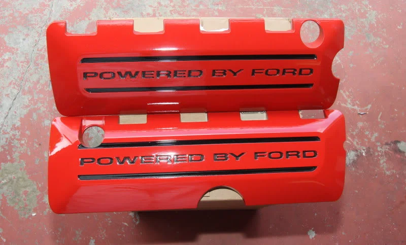

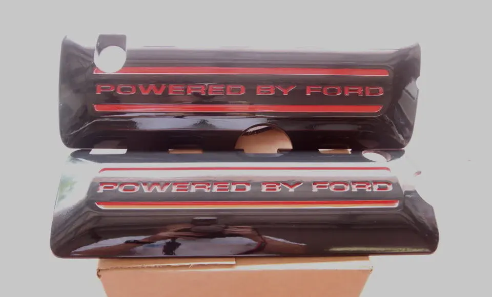

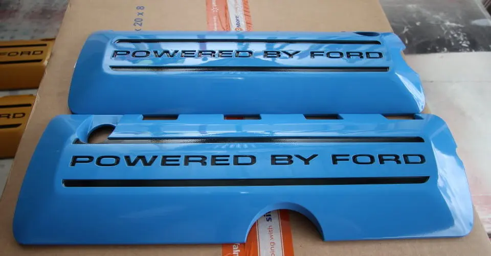

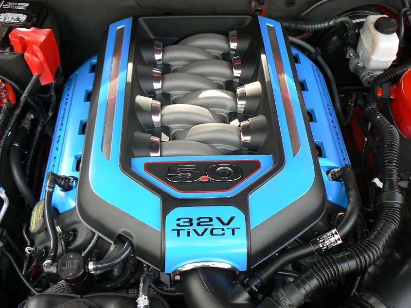

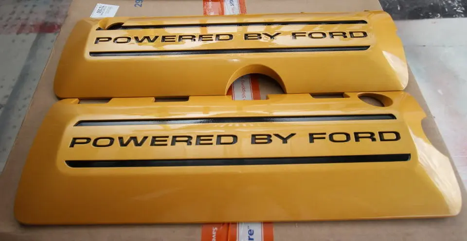

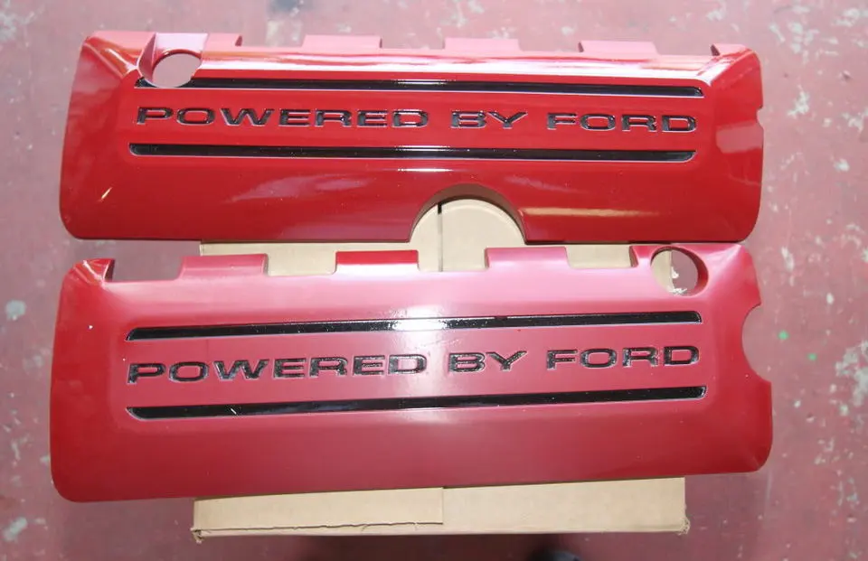

Finally got the hang of this, and just got my new buffer with polishing compounds, so they come out super smooth now. Here's some different color combos:
Mine:

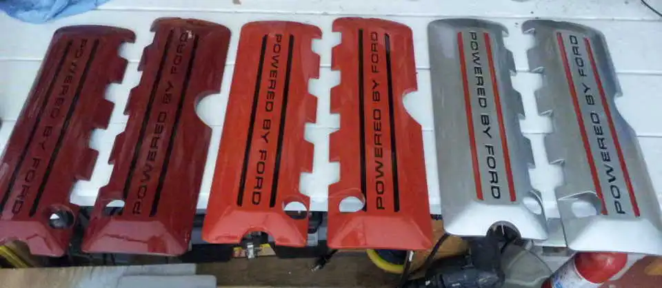

My Friend's Candy Red (Bottom is PRE-buffing):
RACE RED:
BLACK (lightened to highlight reflection):
I highly recommend this to anyone that wants to dress up the engine bay!

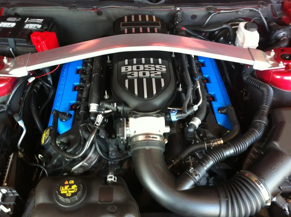

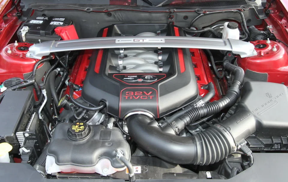

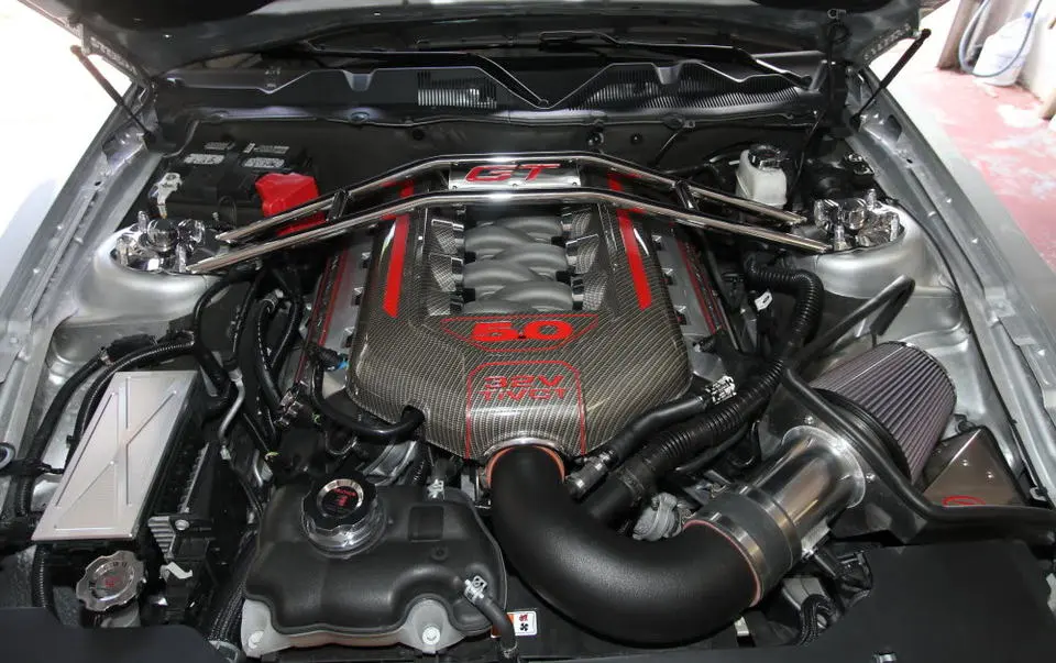

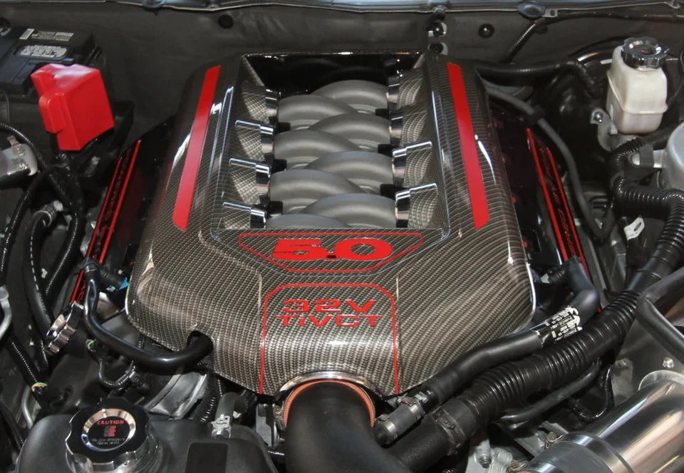

Wow, those are nice! That carbon fiber look is sick! Not my choice for engine bay but it is still wicked! Nice job! I'm sure up close they're nicer than mine. I used rustoleum enamel. Didn't like the chrome spears and lines so I redid them in red. Paints still drying so no pics. The blue is more like Ford blue than the robins egg blue they look like. I don't have a uv filter for my camera either :)

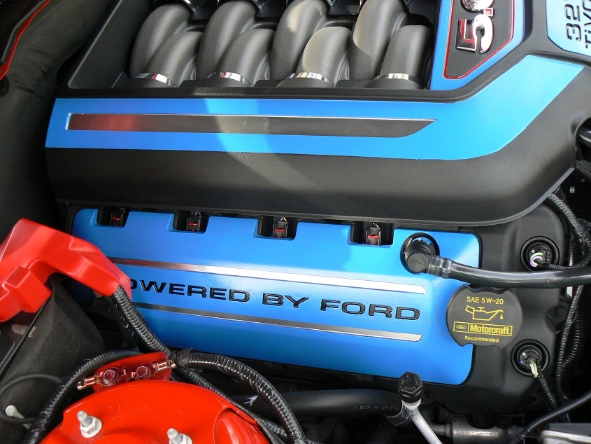

Yeah PoopDawg and it's amazing how good they do come out with that first coat! When I sprayed mine all blue, you'd thought it was factory! It's taping and spraying in everything else that leaves less than perfect lines...at least for me anyway, but unless you're right up close, you don't really notice.
Thanks Bojingles! I was inspired by others too! Someone had their avatar as the painted engine covers...that was my first inspiration.
I like the way the bue looks! Same as beviking, did you have to sand? And what product did you use? And where did you get the grabber blue color? This seems like it would take some serious time to do.
Very nice looking! Looks professionally done!
I just did mine to look like the Boss 302. Spent 9 dollars on plastic prep/primer and the blue paint... Better then buying them for like 80-90 bucks!
Yea, I'm kind of on the fence on whether or not I want to paint my originals or buy the new ones for $90. I would like to keep the originals if I ever set the car back to factory settings. I guess I could just buy new OEMs, though.
On that note, I do love the blue coil covers. Takes us back to the old days of the Boss 302 and Boss 429s when Ford had the blue valve covers.

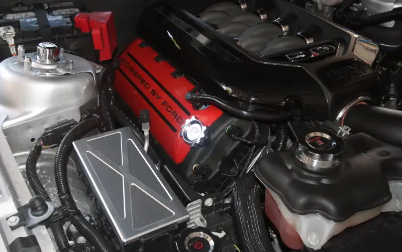

Okay, this stuff all looks too cool not to try it myself. So how do you do the color in the recesses like lettering, etc.? I think I'd like to do my letters/numbers and recesses in either a dark blue (like my Kona Blue 'stang) or in red to match the point on the 5.0.
Any YouTube demos or instructions available on doing this?
I use an airbrush..It's taken me a few mess ups to get it to a pro-like quality. After initial paint, I put a layer of clear coat over the letters..let it dry 24 hours. Then when I air brush the letters, I wipe off the over spray with a little reducer, as the clear coat is protecting the under coat from being removed by the clear. Then I clear coat the whole thing and buff it out...also took me a few tries to get this right.
