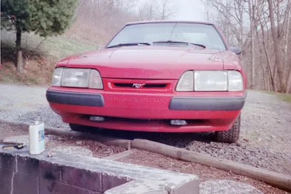

I don't have any real close up pics, but I do have a picture of mine from the front after I got it installed. I check it when I get home to see if it shows an detail and post it up if it does.
BTW I got mine from Design Concepts. It was quite nicely made.

Well, I dunno if this pic will help much, you can't really see anything...
