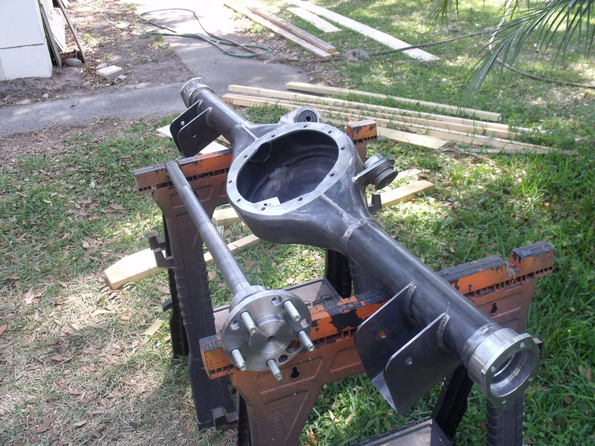

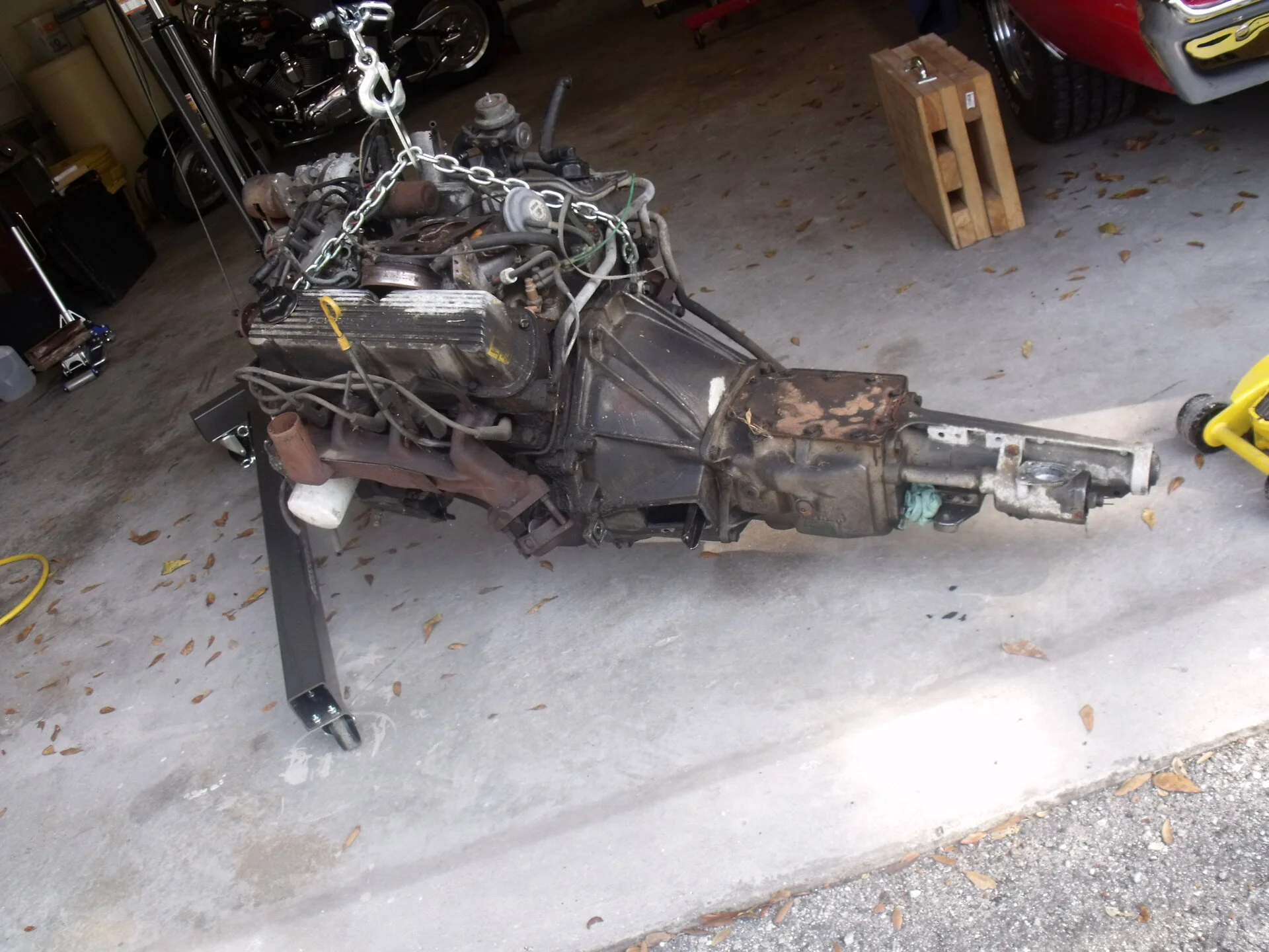

Here is the new rear and the last time I saw the SROD before it went under my workbench
It’s going to make the weaker parts blow chunks if they are not in the car. :puke:
It will save you a AAA towing and some labor, but there are fewer good stories without testing them to distraction.

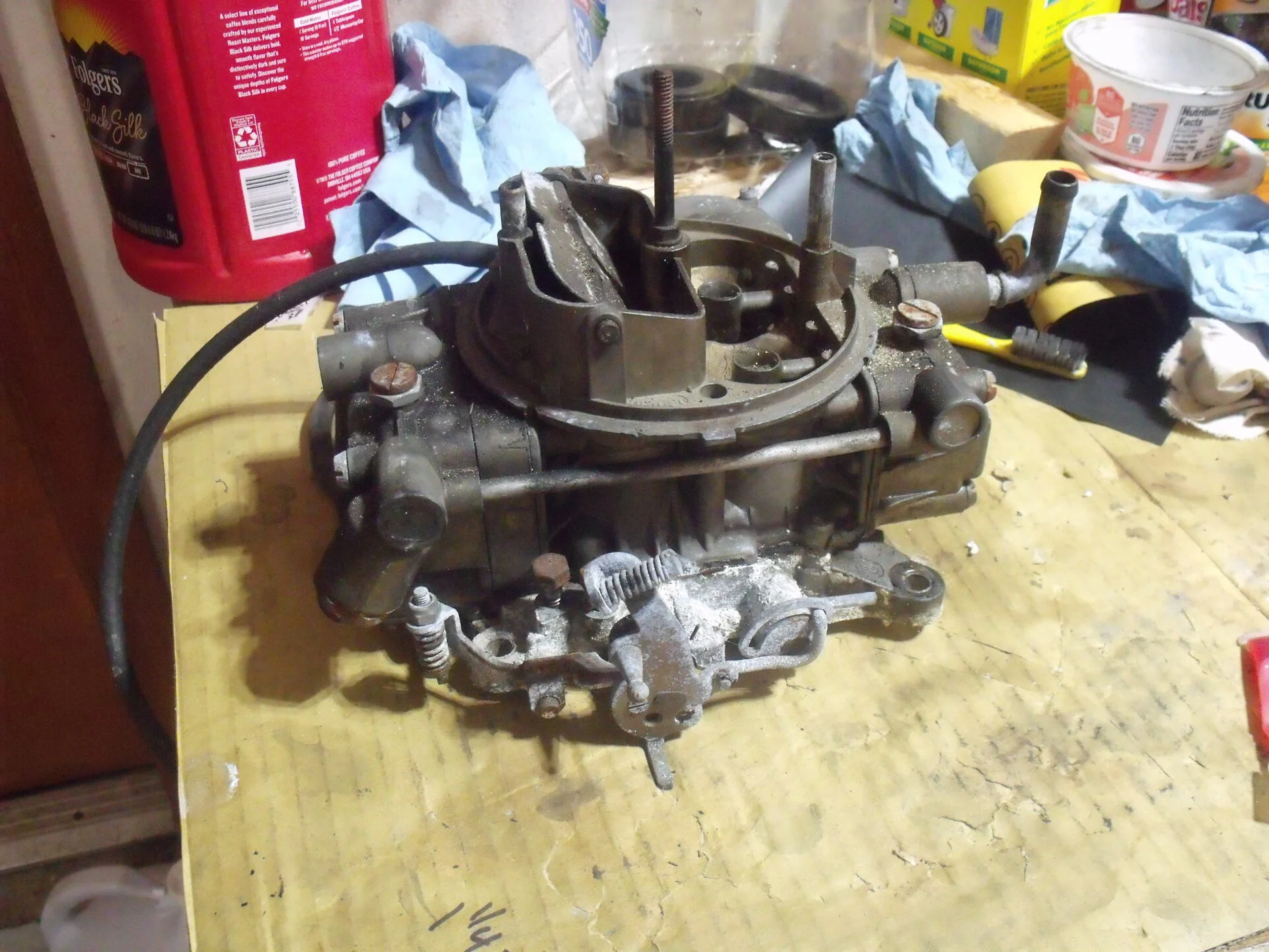

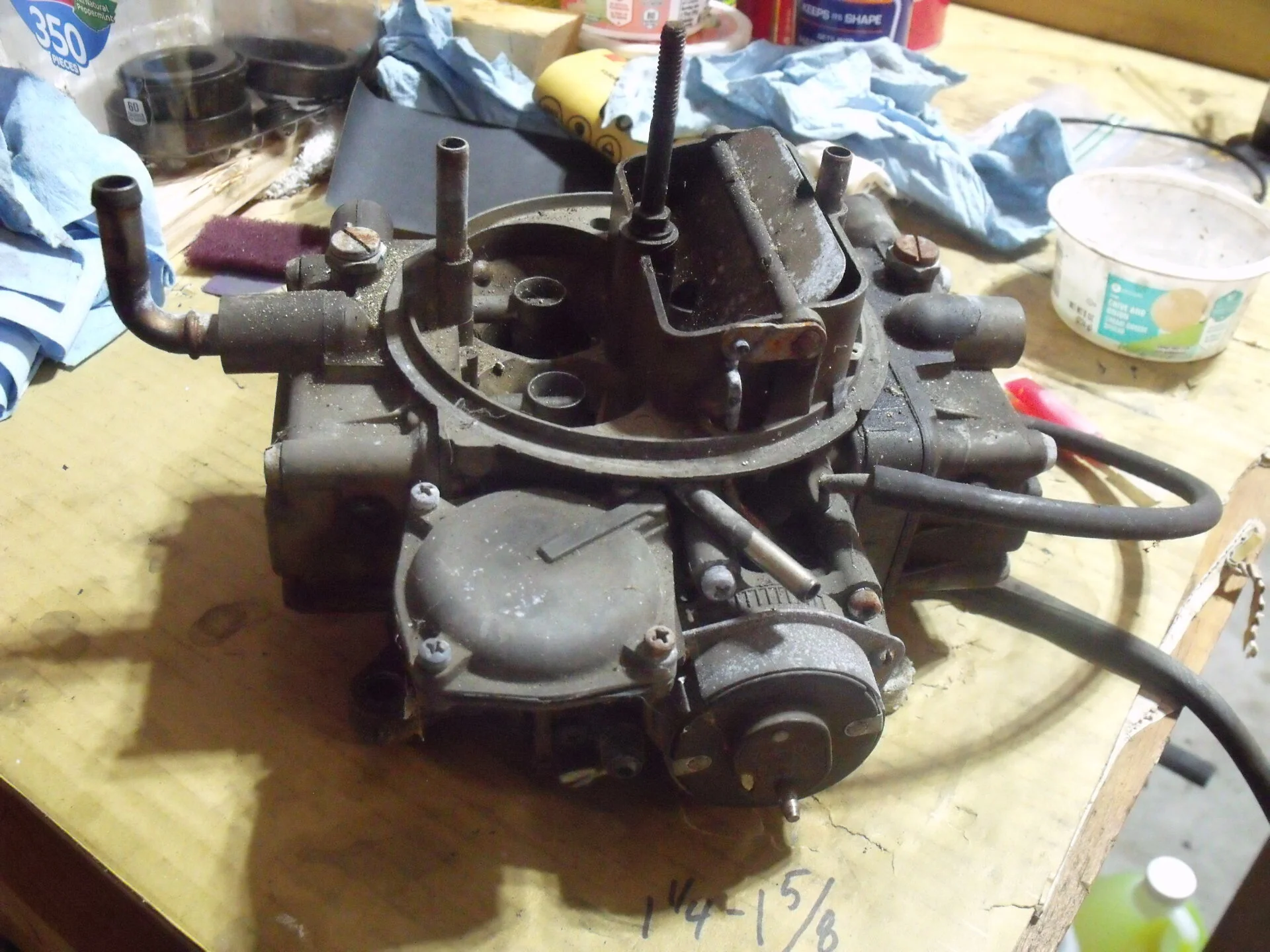

With the vac secondaries, that carb should be able to be rebuilt and tuned. (If it is not a Holley, Motorcraft made a good copy!) But a new 600 CFM universal vac secondary carb would be easier to tune and more fun to get than a can of B-12 soak, a rebuild kit, and a quick change secondary spring kit. This one has seen a lot.
(I am stealing a pic to help someone else. Thanks!)

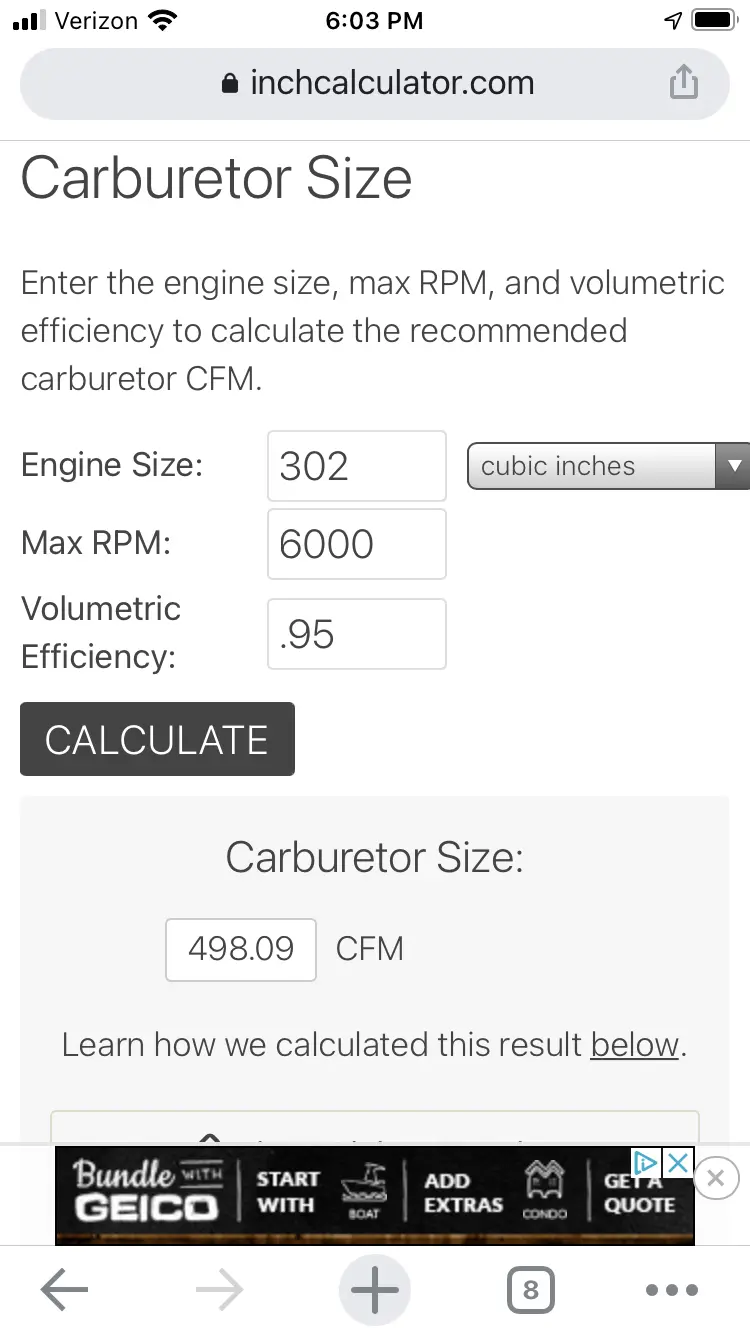

I am planning on getting a summit 500 CFM 4 barrel.... I want to make up for all those "bigger are better" carbs from my youth.....
At 95% volumetric efficiency (which these heads will never reach) and 6000 RPM, you are correct that you will not need all 500 CFM. With the vac secondaries, I liked the tune ability and extra margin of a 600 CFM.
Have you researched who makes the Summit carbs, if they are an Asian copy of a good design, and whose parts fit? I have not looked into that lately and am curious.
