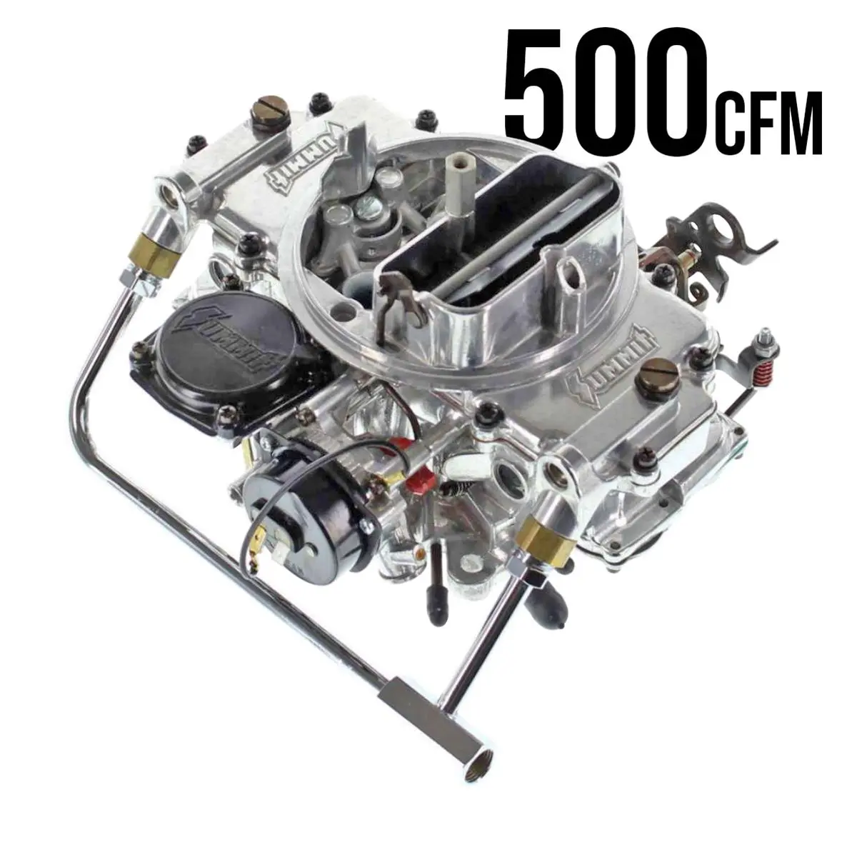

The summit carb is based off the the old Autolite 4100 line.... A very dependable set it and forget it carb, by what I have read.. Who is making it for Summit? I can only assume.......
In the 600cfm range, I've had Holley, Summit, and Edelbrock carburetors, and for my money, the Edelbrock 1406 (electric choke 600cfm) is the clear winner for a street 302 with mild mods.
The basic differences are as such:
The Edelbrock is 99% a "set it and forget it" solution, and is as close as you'll get to 100% without converting to EFI. It forgives novice carb tuners, has excellent street manners and drivability right out of the box when sized right. It's only drawback is that fuel will evaporate right out of the bowls if the car isn't driven frequently, something the other two are less prone to.
Holley is for the tinkerer or the one who wants maximum performance. Imminently tuneable and adjustable with a plethora of parts to make it do whatever you want, the Holley can do things the Edelbrock simply won't do with an experienced wrench-turner working on it. The biggest downside to the Holley is that they're far more sensitive to atmospheric changes, and you will find yourself making adjustments at least twice a year.
Summit's carburetor is a cheap and decent solution, but I wasn't crazy about it. Setting it up is easy enough, but it required partial disassembly of the carburetor to do so, something a Holley or Edelbrock won't require unless you make a jet change. The one I bought had some quality issues as well, and I ended up making a trip to the parts store for brass fittings to replace the leaky parts included with the carb. While it was easy to tune and ran well, I kept thinking "I should've spent the extra few dollars on an Edelbrock" the whole time.
Appreciate the advise and experience...
This is the one I was thinking of mostly due to the 500 cfm rating and a copy of the 4100 series..
500cfm will run a 302 very nicely all day with snappy throttle response and good fuel economy, but 600cfm is usually the "happy place" for a mildly modded 302. If overall performance at the top end of the rpm range isn't a concern, the 500 will probably make you happy.
The formula has always suggested 450-550 cfm for any 5.0L engine I've run, but the old hot rodder's wisdom of multiplying the CID by 2 for your ideal CFM has worked better for me. That said, I've also ignored both and run a smaller carburetor when that's all I've had or was after better fuel economy. (I've even run a Rochester 2G on a big block when gas was $4/gallon).
The Summit carb is a copy of a copy, or to be more accurate, an adaptation of an adaptation. It's based on the Holley 4010 which was based on the Autolite 4100.
The Summit works well enough, and if you're going for something that looks like it belongs on a Ford it's the automatic winner over the generic-looking Holley 4160 family or the Mopar-like Edelbrock.
For what looks right on a Ford -
Holley’s have been on Fords since 1903 and on other brand factory muscle cars. Autolite and Holley carbs often shares basic designs. (Like the 4100/4010 example.)
The Edelbrock is an improved AFB.
I am not sure it matters a lot what’s under a low profile air breather from a visual point as you cannot see much anyway.
