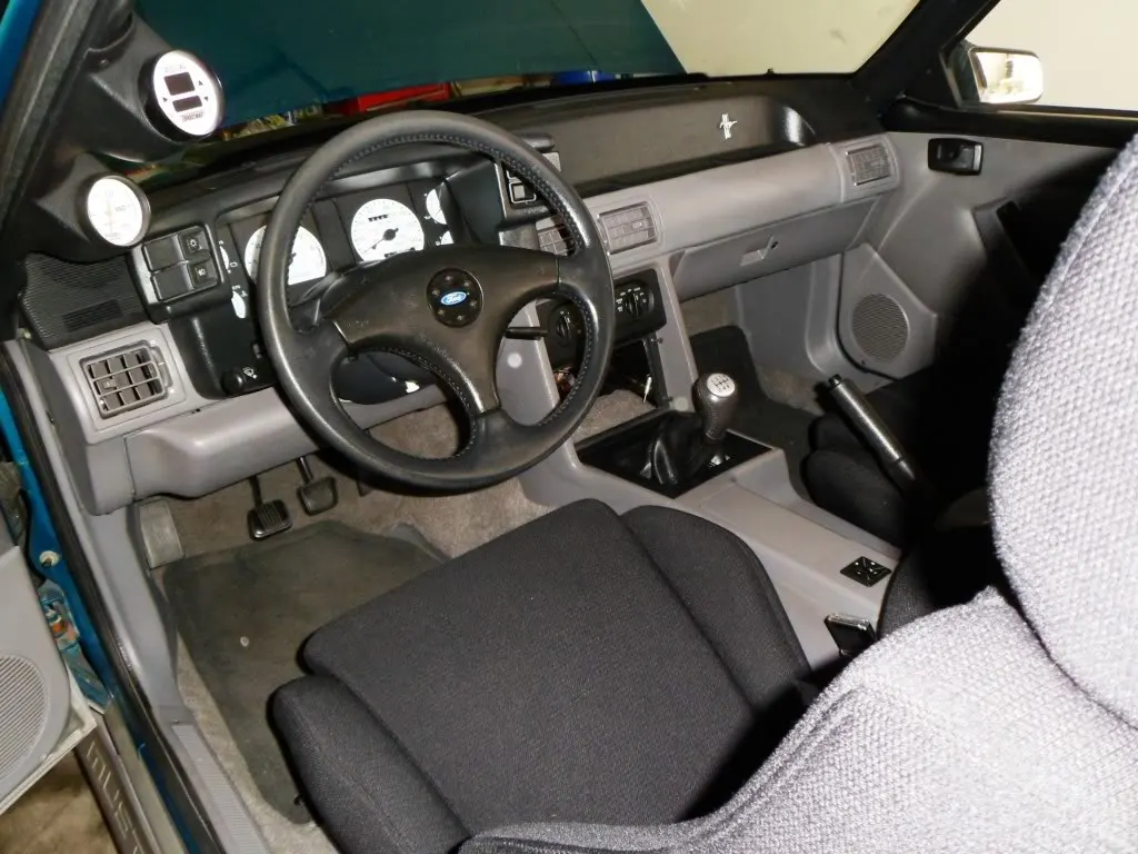

Some interior shots. However, it has the original stock instrument cluster not the white faced gauges anymore.

Smiley Face wheel FTW
I may be eternally stuck in the 90’s-but I always liked the white face gauges

Everyone loves the smiley wheel.
I like white face gauges but they have yet to make one that actually looks good at night. I'm not talking the LED stuff either....1994 Cobra style

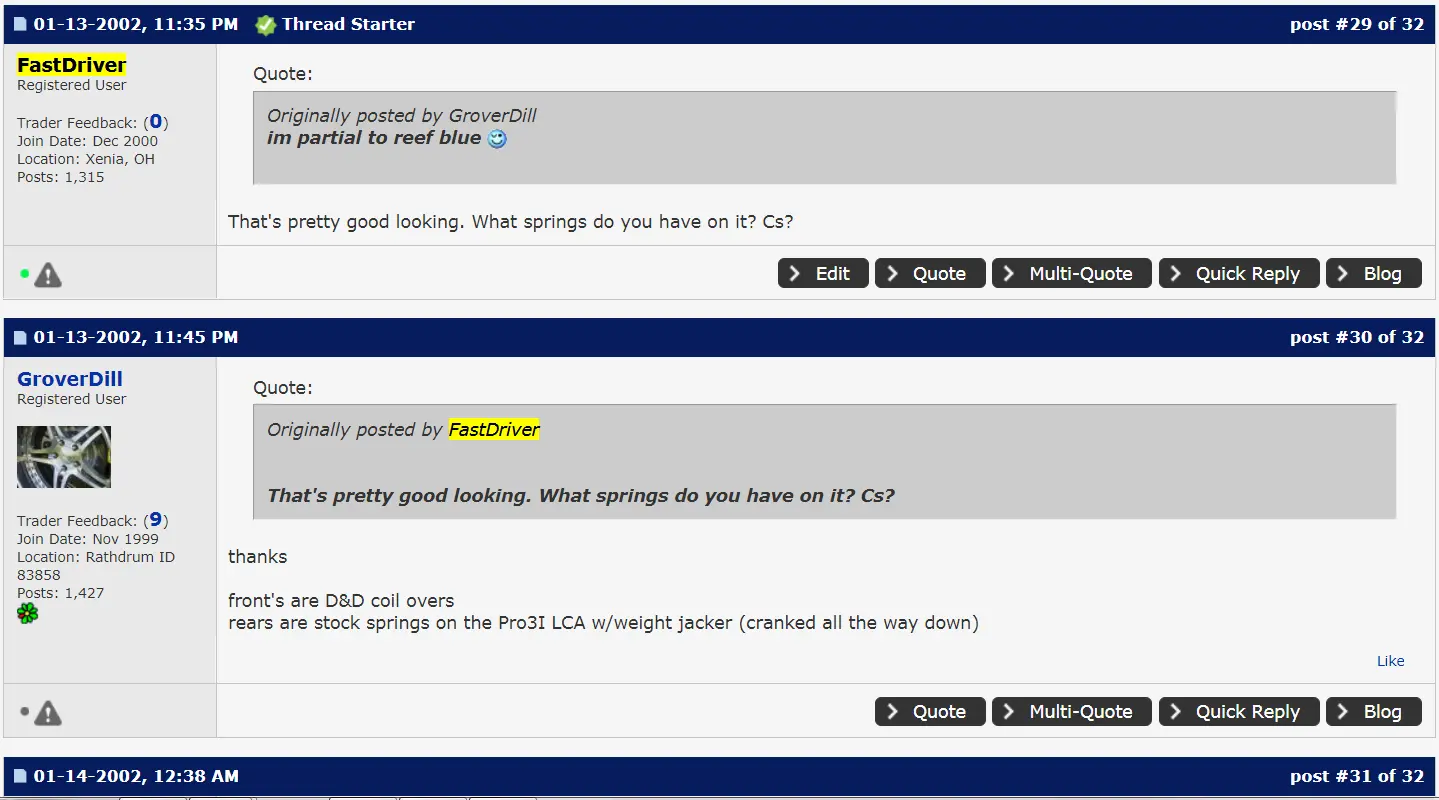

In January, 2002, I started a thread polling the crowd on what their favorite 5.0 color was. I responded to one post in particular.
http://forums.corral.net/forums/5-0...te-colored-fox-body.html#/topics/27765?page=1

pretty cool... 16 years later and it's in your name.
20lbs of boost yanked, guess that should do it.
Pro3i... what ever happened to them? I got the same rear lowers, and, Kevin $ was recommending them back in the day. (coincidentally, that was also 2002).

The lowers are still on it, the D&D front suspension was all replaced with the MM parts.
I am pretty sure Pro3i is the same as HotPart now
