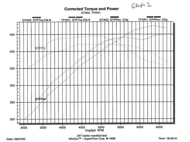

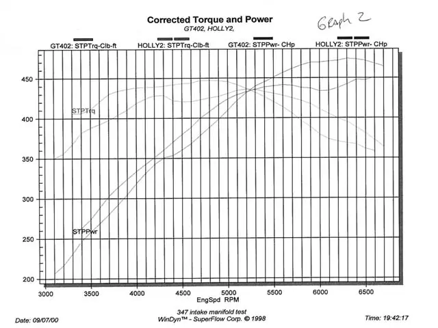

Here's the highlights on a built 347...
After some playing with the adjustable fuel pressure regulator to bring the air fuel mixture in line, the TFS R intake posted peak numbers of 475 hp at 6400 rpm and 422 lbs.-ft. of torque at 5100 rpm. The intake swap had netted a 25 hp gain over the GT-40 baseline, but the added top-end power came with a price. The TFS R intake was down on torque compared to the GT-40 to the tune of 25 lbs.-ft.
In a nutshell, the larger intake traded top-end horsepower for low and mid-range torque.
As with the TFS R, the Holley lost out to the torque-champ GT-40 down low, but bettered the tubular intake as the revs increased. The added torque production of the Holley intake (over the TFS R) is evident in the fact that the Holley bettered the GT-40 baseline at 5250 rpm, some 250 rpm sooner than the TFS R. Note the two humps (not quite a dual torque peak) in the torque curve of the 347 equipped with the Holley intake. This is a function of the efficiency of the long runners in the intake and the motor coming up on the cam.

GT40 vs Trick Flow
GT40 vs Holley

Click here to go directly to the dynos.

STRTRCR50 -- Dude thanks alot more that information. **** me that is a big dif. I didn't know it was that significant loss in lower end hp and torque. Yes my car is a complete street car ha. The blower should make up for all the Top end lost! Damn... I'm def keeping my GT-40 now. Thanks alot for finding that information. i appreciate it!
