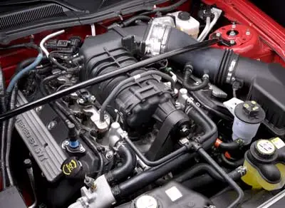

I read the GT500 was designed diffferently so that mods are very hard to do. I copied and pasted the following:
"Ford has made this car much harder to mod that the 03/04 Cobras. The blower uses the rear belt on the motor to drive it, not the front belt like the 03/04 cars. It also has very little clearance to swap the top pulley. The bottom pulley can't be swapped for a larger pulley either! There is only 10mm clearance."and Sept 30 "Got a good look at the production blower yesterday! It is a Eaton R122
It has a 10 rib pulley. Short snout and no room for a smaller pulley! it is driven by the rear belt, not the front belt like the 03/04's."
I dont know whether all that is true or not, but as the old saying goes "where there is a will there is a way." Im sure someone will develope something for these cars. They have to much potential not to. The only real question is how much will it cost to over come those obstacles.
By the way, the car is closer to 500hp stock then 450.
