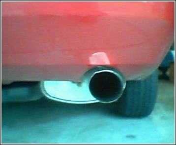

I installed a single (right side) GT axle-back. Fits ok, but sits somewhat close to the bumper. After a long run, the bumper still stays cool though. I'll be replacing it with a single MAC axle-back to go with the MAC headers... arriving soon (I hope!)
But, I gotta say... the GT muffler sure sounds sweet! Put the powerbook behind the car and gave it a few revs...

I've heard of guys putting the entire dual GT cat-back on their V6's. They either need to cut their bumper or get a GT bumber. I suppose you can just hang the tips lower, like Magnaflow did.
