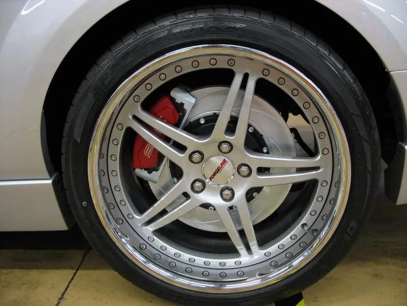

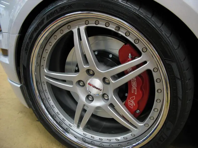

hey, no there are a few of us who know what a proportioning valve is. but it is the issue here. I converted a v6 car and used 20" wheels on it, direct bolt on! no issues with the brakes or abs. Any v8 will do, just make sure that if your car has ABS, make sure the v8 car does too. if you do not have ABS, then any brake will fit.
no special tools, just bolt the stuff in. You may want to upgrade your rotors and pads like i did. goodluck
