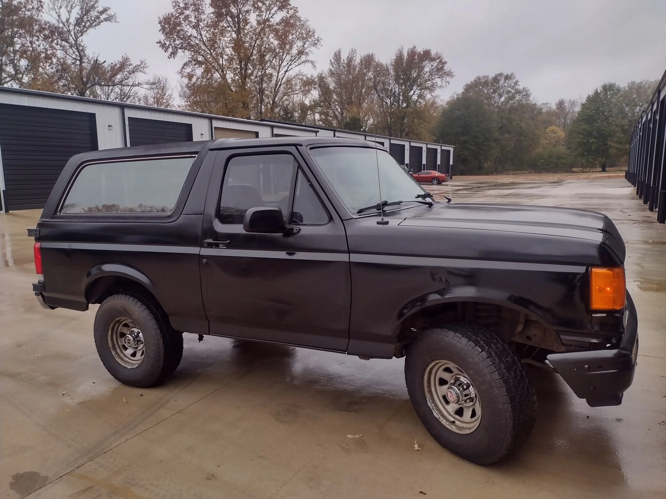

Advertised 215 net hp with a truck roller cam,
Gt40 heads and intake. My bronco has a mustang roller cam, GT40 heads and explorer intake.
