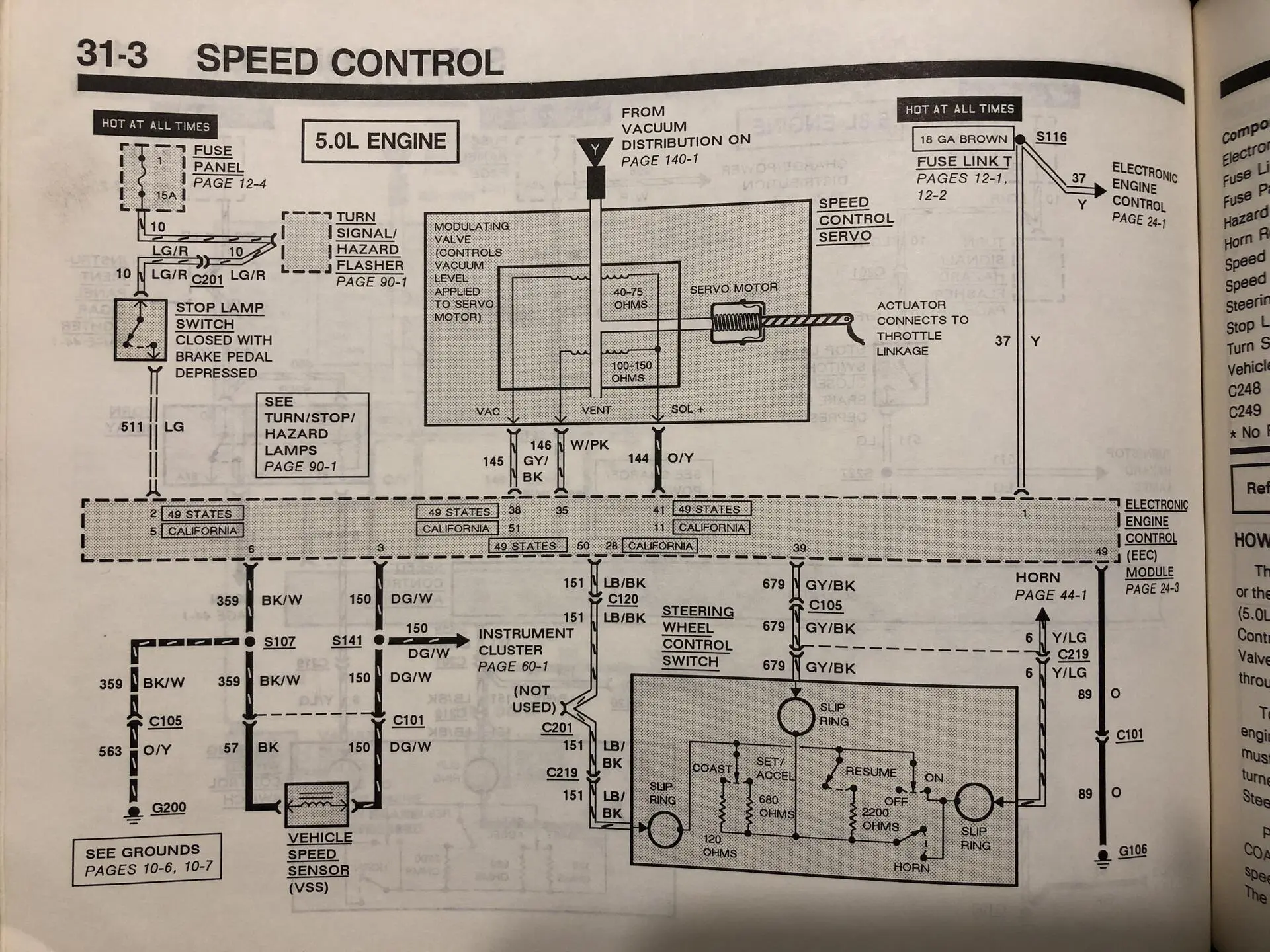

  3. The cruise control servo on 1990-1991 Grand Marquis and Crown Vics is controlled by the computer. Would it be possible to add this functionality to something like a MegaSquirt setup?

That's about all I can think of at the moment. It's a mild setup I'm going for. I was originally planning to use a Lincoln Mark VII computer since it also controls the cruise control servo; however, there's no guarantee it would be able to keep it from running too lean. I could get my hands on an A9P and go mass air, but those computers are crazy expensive now even if they're used. I'd also lose the cruise control. I would retrofit a servo from a 1989 and earlier Grand Marquis/Crown Vic, but I haven't really looked into that.
It looks like the ECM directly controls the vacuum modulator valve that controls the servo.
