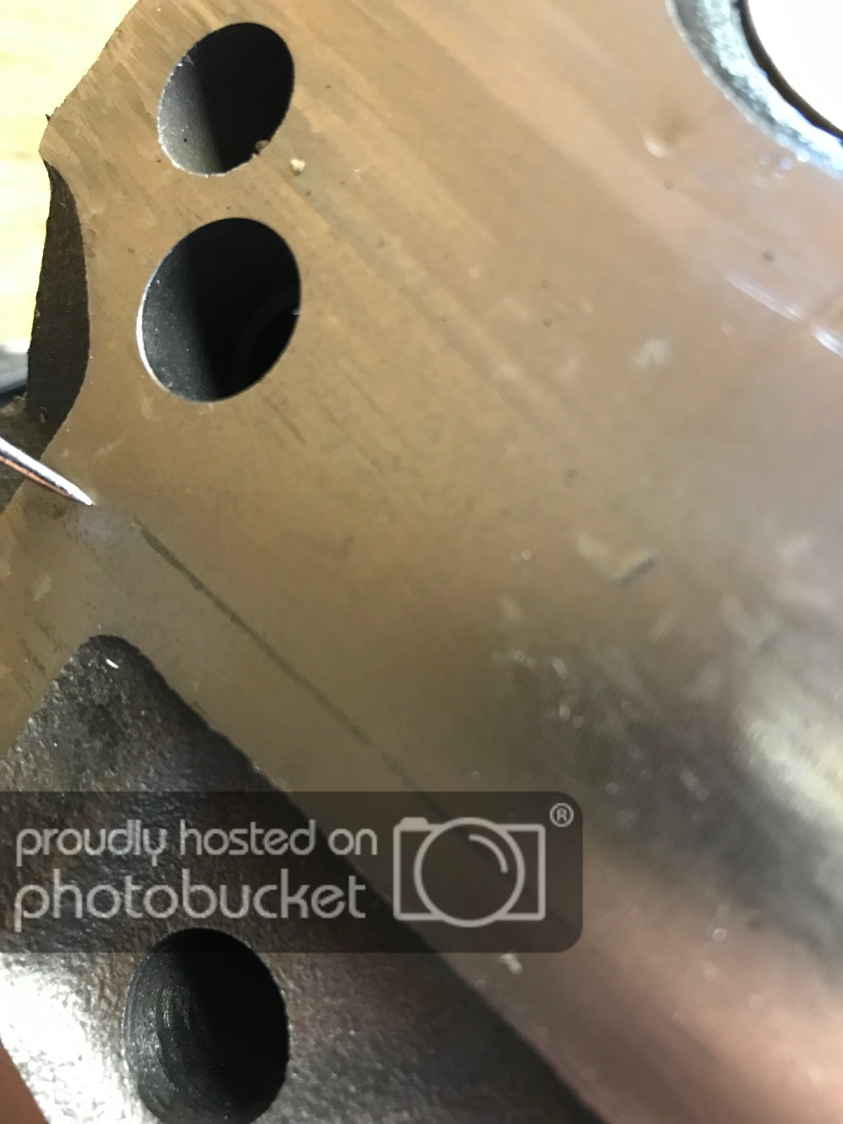

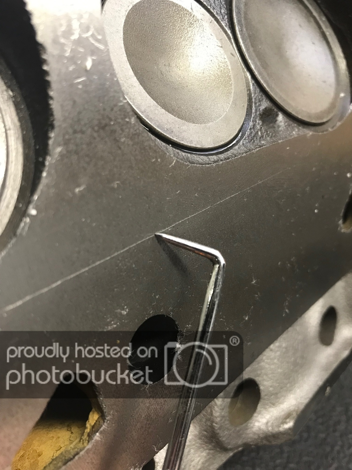

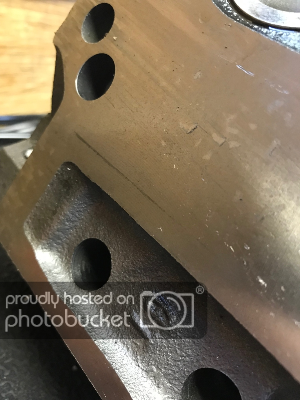

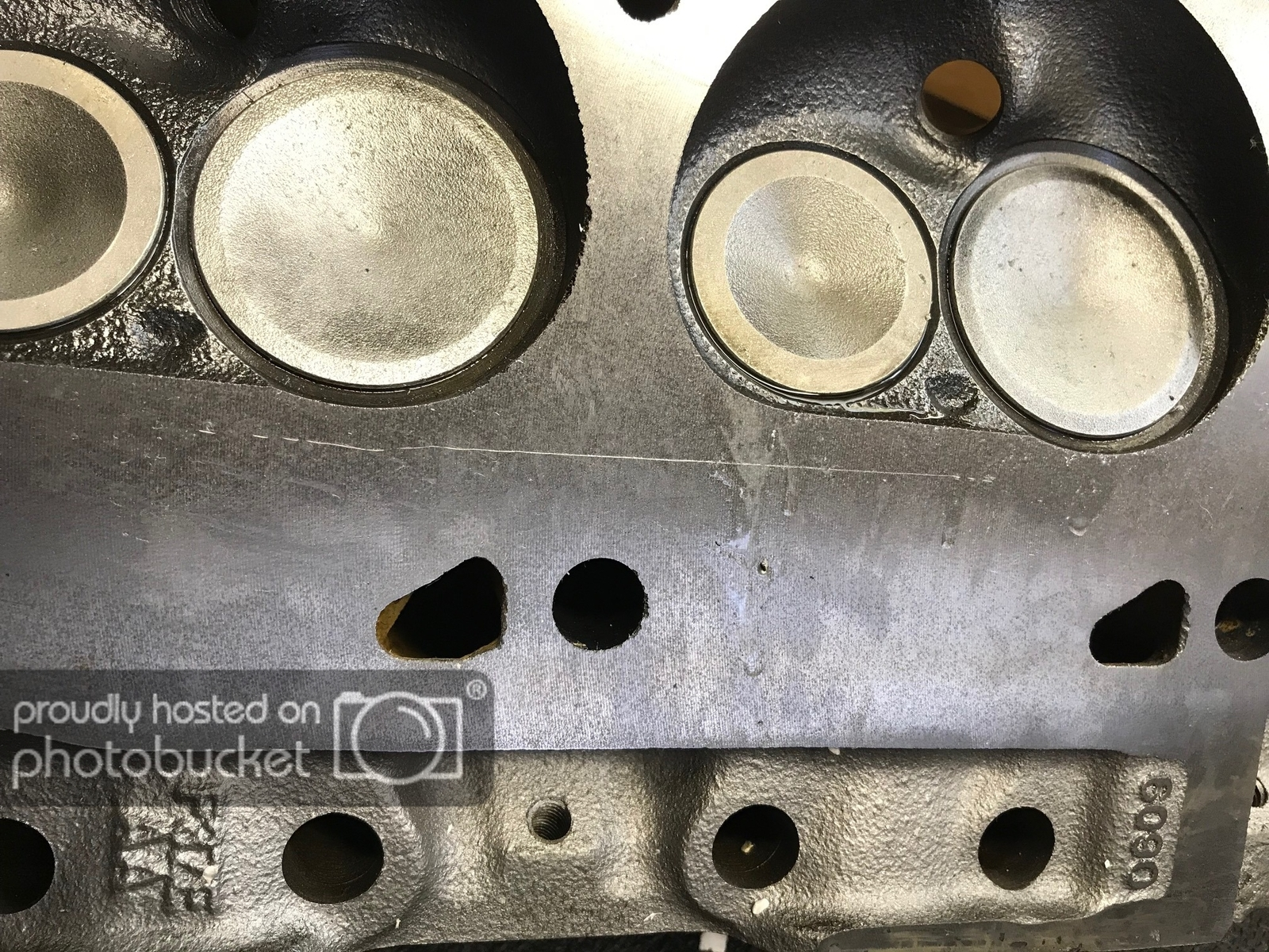

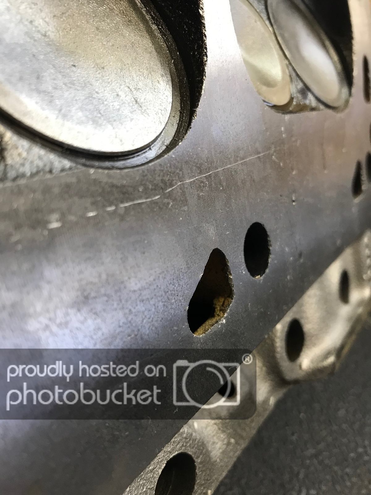

It looks like either because of rough handling from UPS or not enough packaging the heads scratched one another in transit. It's not terrible but I am not sure if the heads should be resurfaced again. They are deep enough that a finger nail / hook tool catches it but just barely. They are also not near any water ports so I am not sure how critical it is.

1. Based on the photos, what do you guys think? Should the heads be resurfaced again? This wont be a 9 second drag car anytime soon so I am not sure the damage warrants it.
2. If machine work should be done, what exactly should I ask for? I have never taken anything to the machine shop before and I don't want to sound like a giant tool.

The critical sealing areas are around the cylinder bore edges and water passages. Lay a head gasket on the head and see if the gouge is near or crosses one of those areas. Use that as your decision guide for whether or not the heads need to be resurfaced.
Both heads will need the same amount of metal removed to insure things align up and have the same combustion chamber volumes.
It doesn't look like you can even catch a finger nail on it. ( and if you can't, it's not a problem) Depending on where the HG overlaps, and as mentioned whether or not a cylinder seal is potentially compromised because of it, I'd consider it inconsequential. If it were me, I'd get a sanding block with some 220 grit, and just run the block over the head surface to clean it off ( not anything more forceful than what's required to get the surface clean) . If that gouge remains after a light scuff, then I'd look into a light resurface.
You can JUST barely catch a fingernail/hook tool in the scratches. It’s not even a catch as much as you can feel it/hear it.
That’s good advice with the sanding block, hadn’t thought of that.
Both heads will need the same amount of metal removed to insure things align up and have the came combustion chamber volumes.
That’s great advice. i have a set of standard Felpros in the garage that I’ll use to check.
