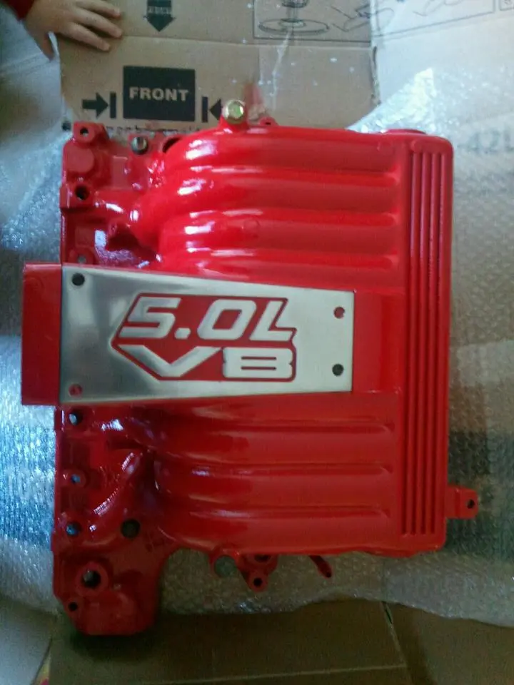

ok i have a gt4o intake (not on car yet) i live in TN (no emission testing) should i delete the EGR? I have a 80mm MAF and looking at throttle bodies would a 75mm fit and do i need one with out egr for that gt4o intake
is there a passage in the center of the lower and again on the upper? should be about the size of a quarter.
the pic you have shows the EGR coolant return so I am fairly confident you have an EGR equipped model.
Depends on the year if memory serves-some of the first ones had EGR porting (96-97??) and after that, the exhaust was pulled from the #4 cylinder primary header tube I believe.
