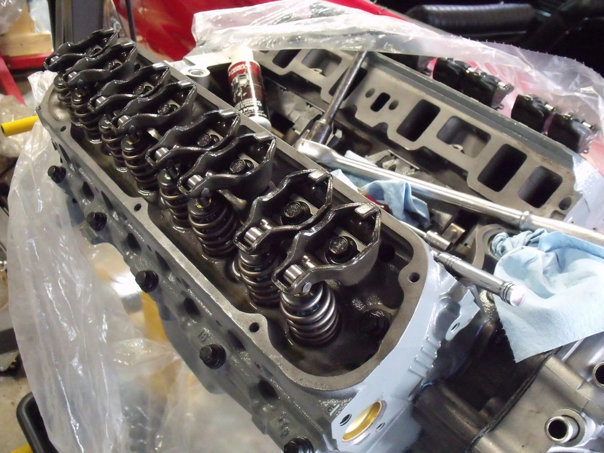

Those roller rockers for a pedestal mount head are pretty cool..... Those are NOT the roller rockers he shows in his post.....
I used these in my "P" heads.. I did not want a true roller rocker for a street car.....
If you use pedestal rockers there is a shim kit you can buy and probably use your stock pushrod length... 6.248?? I think

The GT40 heads I have are using the factory rockers they came with just upgraded valve springs. I do have a 347 stroker if that matters.

I think the GT40 uses pedestal mount from factory, i’m new to all this so excuse my ignorance lol. So Should I use pedestal mount like he put in the link above?
I am new to this too.... I just went through this building my Explorer engine for my grocery getter mustang a few months ago.....
Just telling you what I did.. These were Lunati roller tip rockers were bolt on for pedestal rocker heads....
My research said that roller TIP rockers will help with valve guide wear... Some say it almost eliminates it.... For the street true roller rockers are a bit of overkill....
Hopefully others will chime in with more experience doing something different with Gt40 and GT40P heads......
I have Crane 1.7 pedestal mount full roller rockers (just like the 93 Cobra did) on both my stock cam and E7 headed engine and my current GT40 3-bar headed and Crower cammed (actually have two full sets of the roller rockers) combo. I used stock push rods with both engine combos with no issues. In both cases I didn't need any shims under the pedestals either.

Did those use your stock push rods and did you have to use any shims or anything like that? Also do you have a link to those? Thanks!

I’m aware of what he showed in his post - that’s why I posted what I did because what he posted was wrong if his heads had not been converted which he replied they were not . Nothing wrong with what I sent him .
