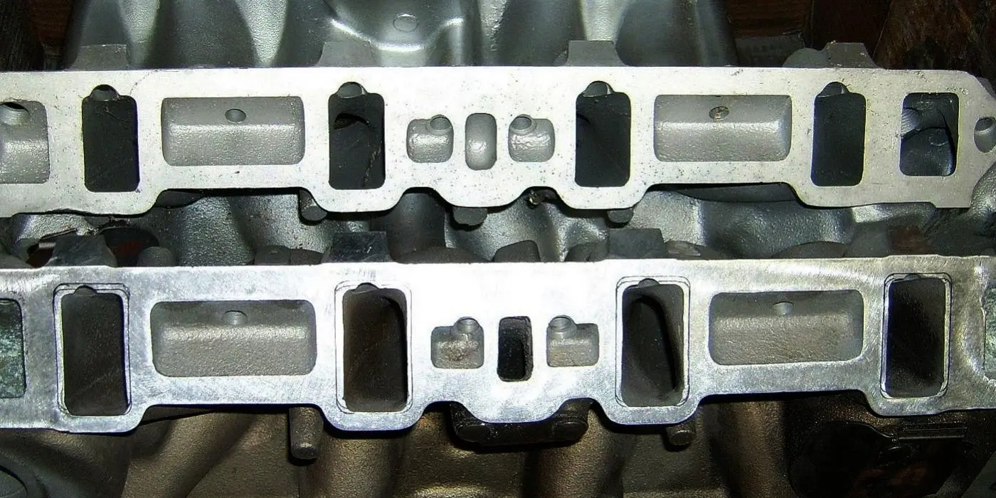

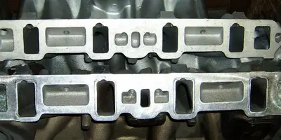

The GT40 family of intakes have the part number that ends in "-BA" or "-AA". The AA lowers have a little more runner exit section - good tip for 100% stock classes if you don't want to cheat. The BA is .96"x1.65" and the AA is ~1.00" x 1.80"
here is a look at them...................
