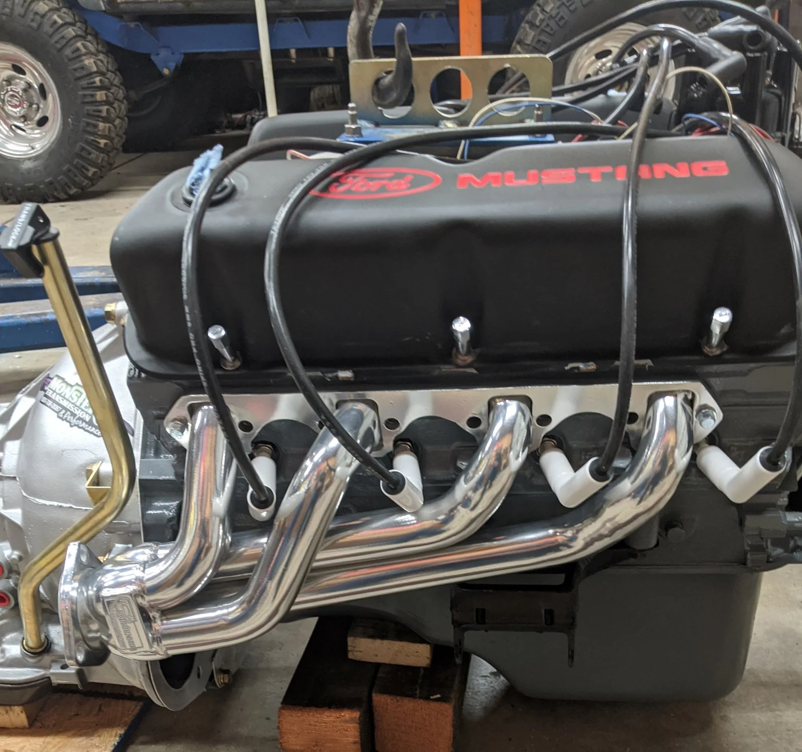

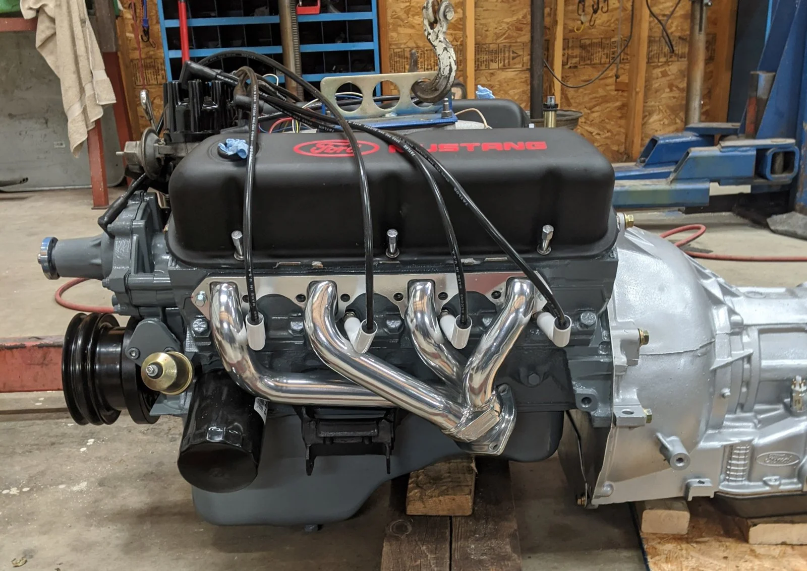

Hi,
I wanted to share my experience since I spent a lot of time on these boards looking for answers. I have a 1967 Mustang with a 302 and a AOD transmission that we just put GT40"P" heads on. After going through different headers I finally found a set of headers that work!!! Sanderson Headers FF3GTS-SEC that I purchased from Summit. On Summit's web page they don't acutally list the GT40P heads, but if you go to Sandersons Web Site they say they fit and they DO!! Look at the pictures I've attached. I hope this helps somebody else, I sure struggled..
