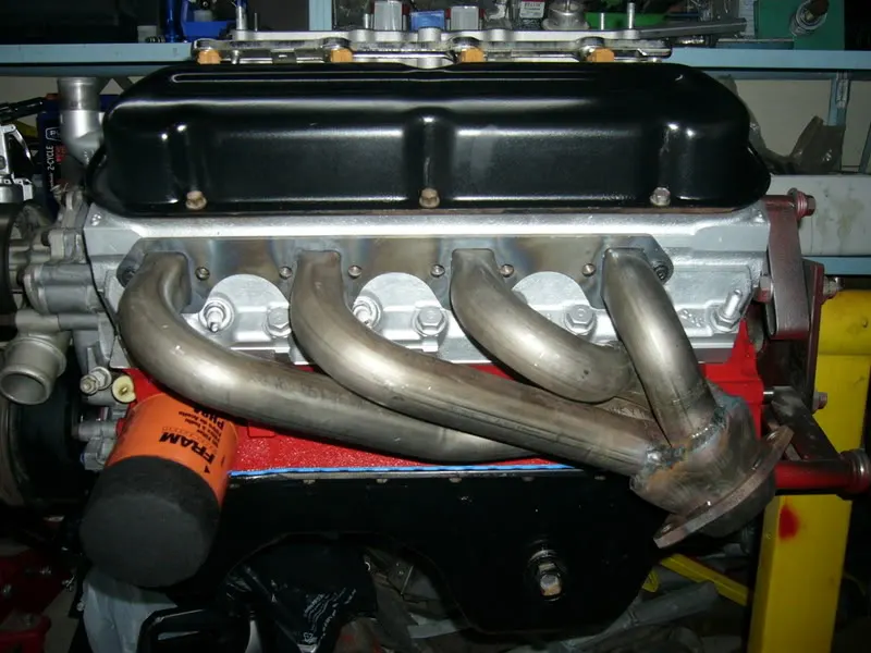

M-9430-P50 in a stainless header. M-9430-C50 and M-9430-P51 in Jet Hot.
Ford Racing Parts and Accessories at great prices has the stainless for $239 and the Jet Hot for $329.

I bought from Summit bacause they have them in stock, and M-9430-P50 is the part # for the above picture, im not 100% on this but i think M-9430-C50 doesnt fit the P heads, but i could be wrong
Un-coated
Ford Racing M-9430-P50 - Ford Racing Hi-Flow Shorty Headers - Overview - SummitRacing.com
Ceramic Coated
Ford Racing M-9430-P51 - Ford Racing Hi-Flow Shorty Headers - Overview - SummitRacing.com
No. I think you're right. I don't know where I got that number from.
