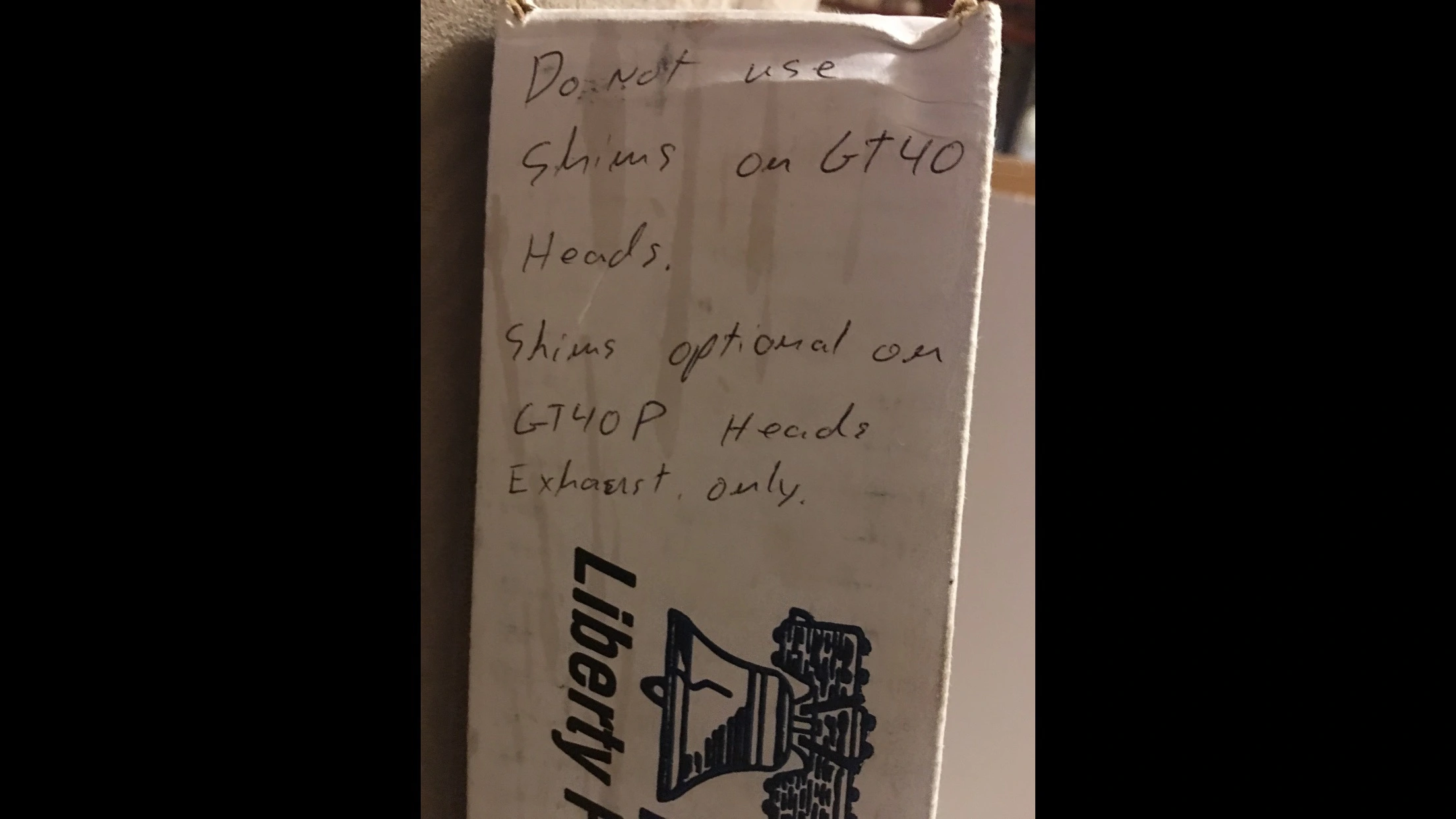

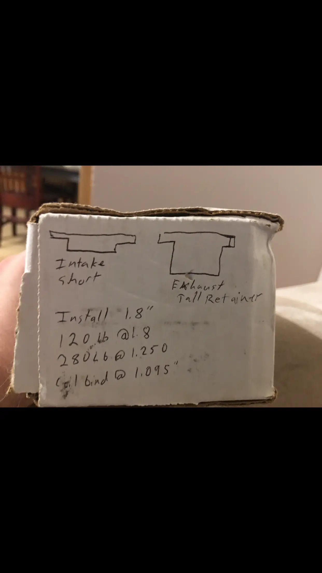

If I recall the local machine guy recommended only shims on the exhaust side. I went looked at the box of springs.
