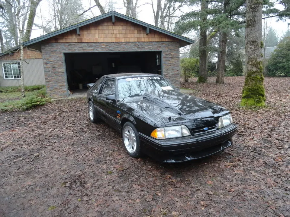

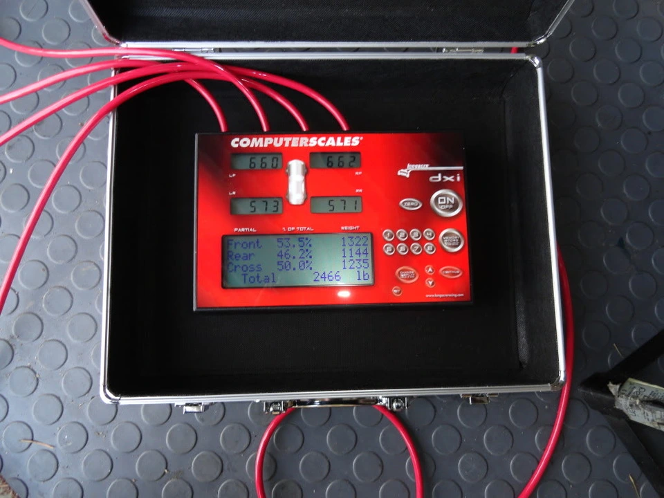

Before starting putting the car back together and performing the rear end suspension work ect. I decided to put my new scales to work. So with the car as you see in the pic's, how much do you think the car weighs as is?

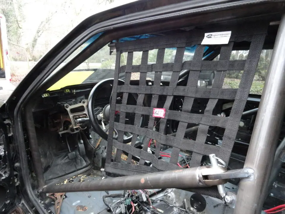

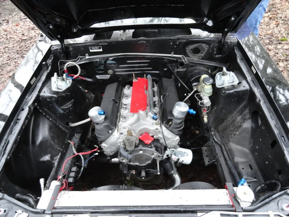

No front or rear sway bars, car does have a Tremec TKO with QuickTime Bellhousing and Mcleod twin disc clutch and long block as seen in the pics, aluminum driveshaft, 8.8" rear stock/disc brakes and MAC (or BBK) lower control arms, FMS upper control arms, fuel tank with 8 gal fuel with twin external Pierburg fuel pumps/filters/AN fuel lines. Also big aluminum radiator with 3 electric cooling fans, and an evac pump. All QA1 front suspensions, K-member ect
The engine that is in it is a 331 stroker with main support and Canton 7 qrt "T-pan" with J302 aluminum heads and GT-40 lower............not that it matters (for sale btw)
